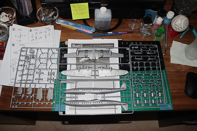

This kit was already in my stash. I have ordered civilian airliner decals for the build.
Nice! What decals are you planning to do?

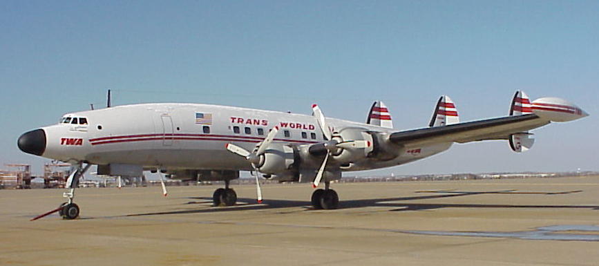

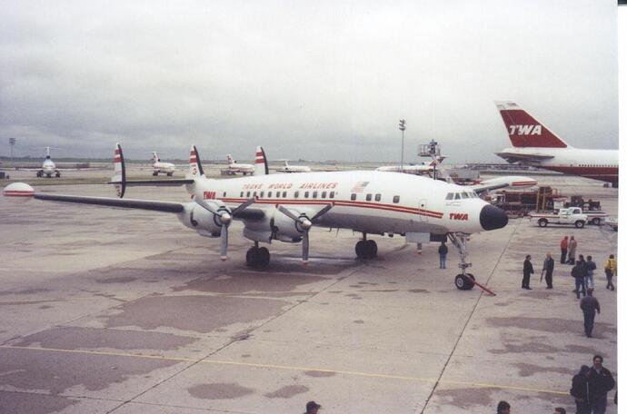

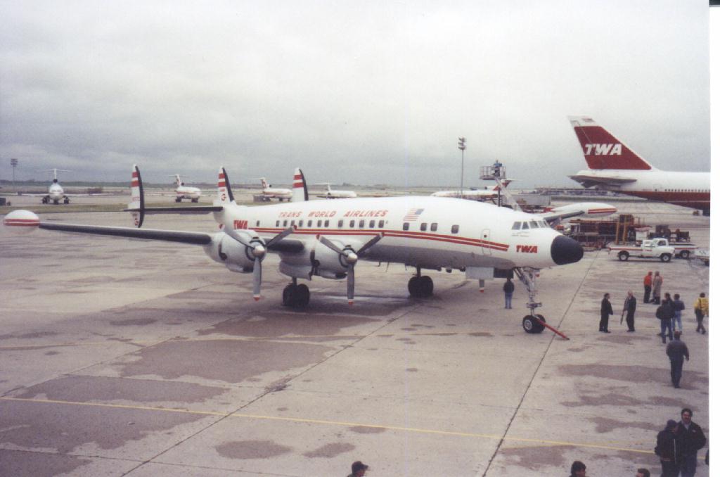

No such thing as an ugly Connie livery. Even the military EW variants are cool looking.

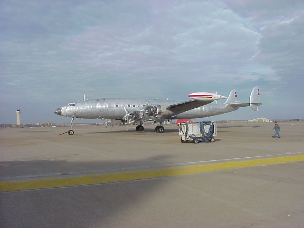

Agreed, Even bare nekkid she’s pretty…
I was fortunately enough to work at TWA when they repainted the Save A Connie to the actual TWA livery.

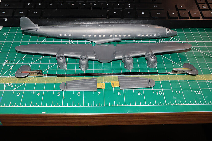

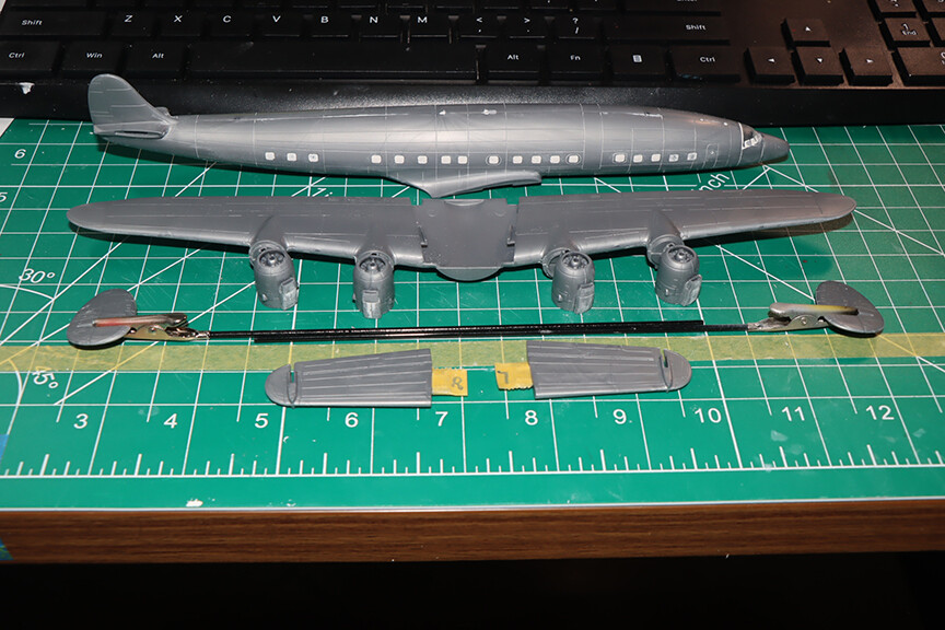

The Connie build is coming along pretty well. The fuselage windows are in, the fuselage is closed up. The nose and canopy are attached. There two ridges at the wing roots on the fuselage that need to be sanded down to get the right amount of dihedral when the wings are attached. Tomorrow I will be taking care of seams then attaching the wings. This is a very simple build. I’m really enjoying the time spent building.

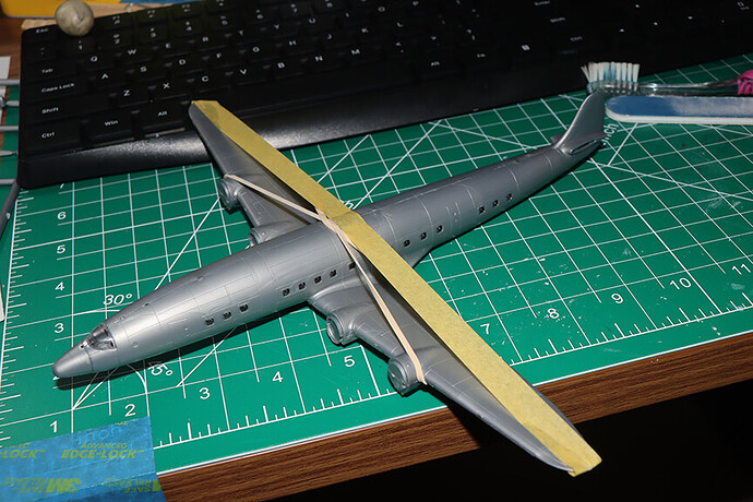

More progress on the Connie. Today was filling and sanding. Nor too bad, mostly on the fuselage. Some panel line rescribing needs to be done. All the windows and canopy are filled ans smoothed. The decals will have the fuselage windows and cockpit glass. So far, this has been a fun build. The kit comes with two noses, the 1049 nose and the 049 nose. I just might get another Connie kit when I go to Modelpalooza so I can build an early C-69. I’ve been looking for a photograph of the first C-69 delivered with AAF camo on the left side and TWA livery on the right side.

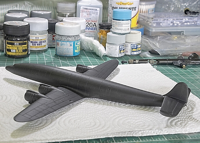

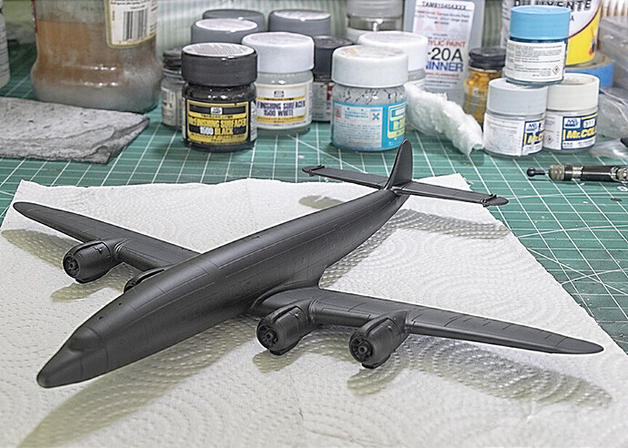

Connie Update:
Was out at the paint bench this morning. Wanted to beat the rain and get the Connie primered. Mr Surfacer 1500 thinned 1-1 with leveling thinner. As usual, the primer laid down nicely. I’ll let the Connie sit for a day or two so the primer is well cured. After that I’ll shoot either AK or Alclad Polished Aluminum.
