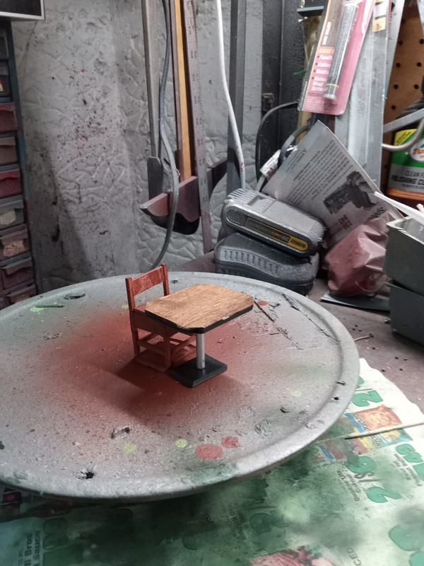

Made a chair but it might be a tad large,what do you guys think?

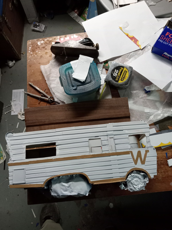

Making a template for the big W!

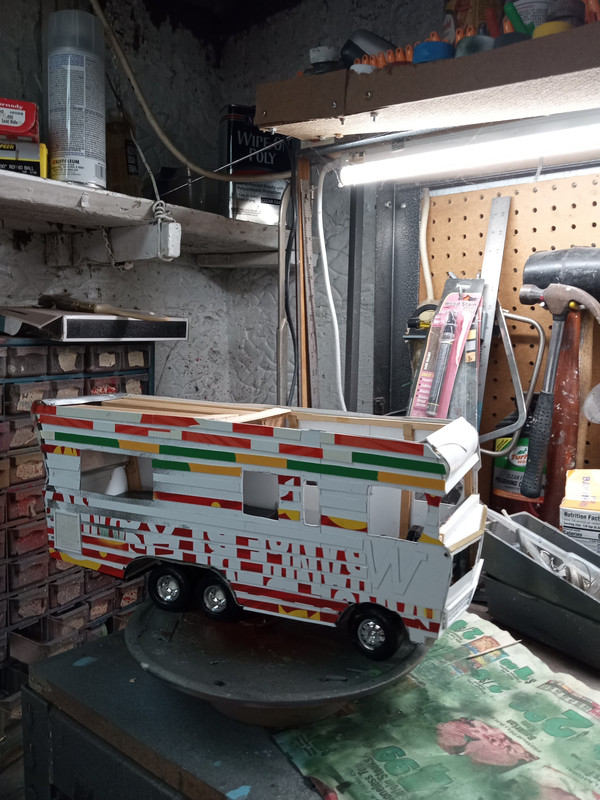

Cut the Styrene strips and glued them on to simulate the ribbed texture of the Winnie .Quite time consuming and I hope I have enough plastic to cover the other side (multi color due to the advertising plastic I obtained at my old job). broken skull wallpaper
I found some more plastic in my stash and sheethed the other side.

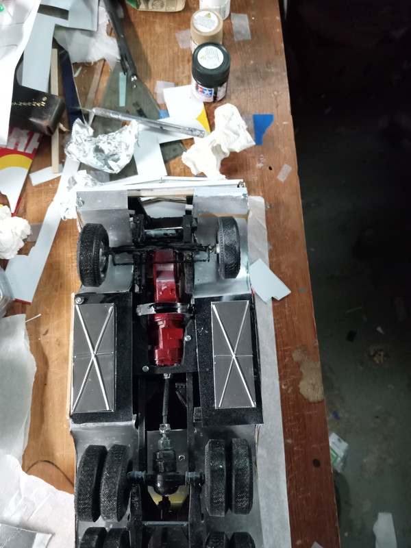

Made and painted the fuel tanks.The original plan was to use the kit supplied tanks of the Kenworth but they were too large

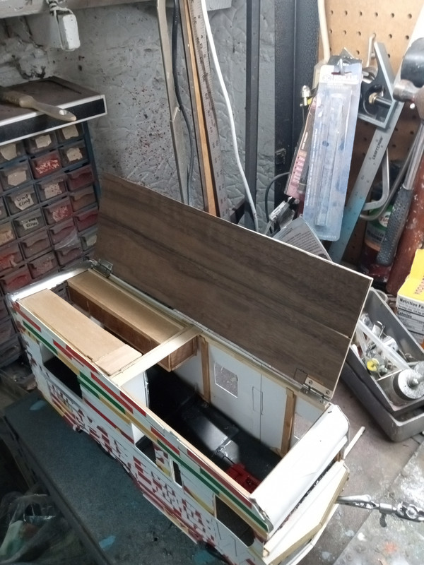

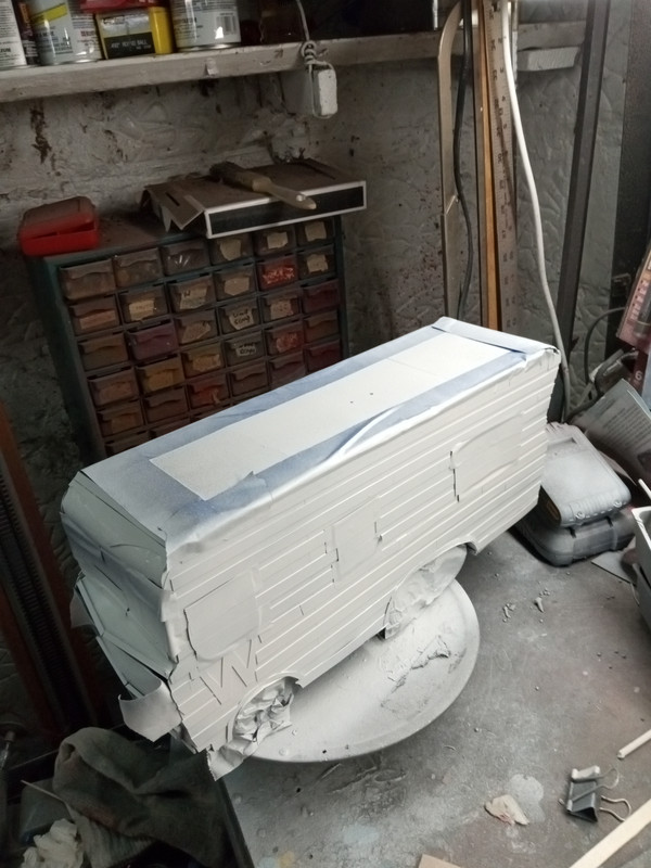

Roughed in the roof sections wells fargo atm nyc
Hinged up the roof using the hinges from an old Jewelry box I found laying around .

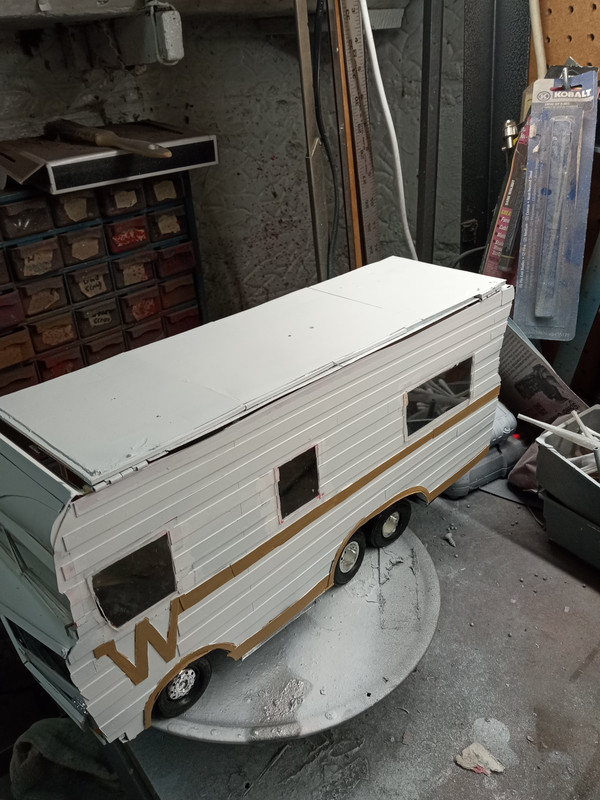

Preparing to primer and paint.

looks really good, uh, is the tape on the roof for raceing strips to follow? (boy I crack me up [:P])
Nah just to keep overspray out!
Painted the accent stripes and W…

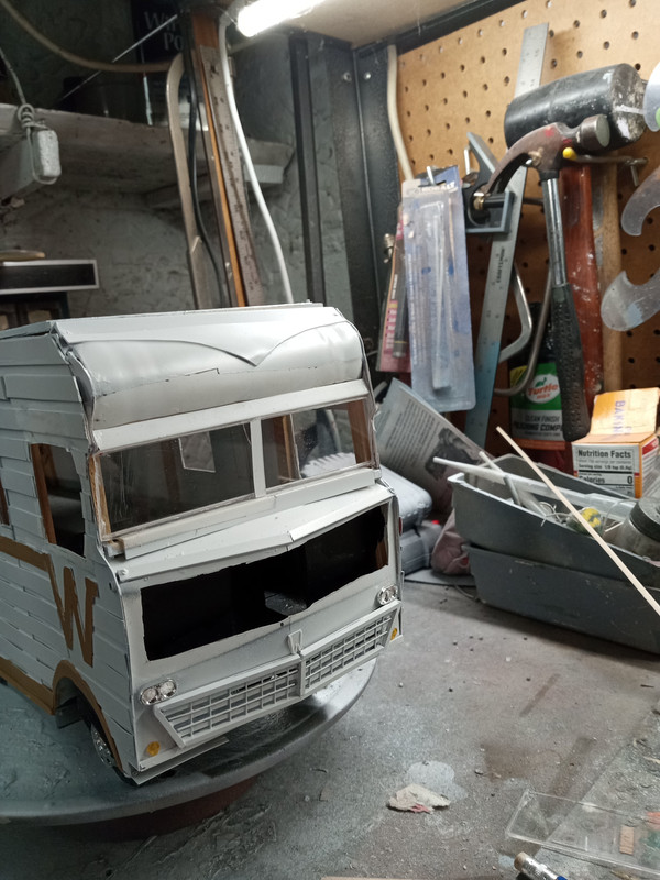

Put the windshield in as well as other front end detail…

Put the side and rear glass in.Due to supply chain issues ,the local hobby shops didn’t have clear plastic so I had to use old CD cases. .now I tried to use my usual scribe and break method but the plastic shattered!So I had to use my Dremel with a cut off wheel to cut it out Worked well but I had to use sand paper and my Stanley block plane to make them fit .Brushed on some Future for good measure.
