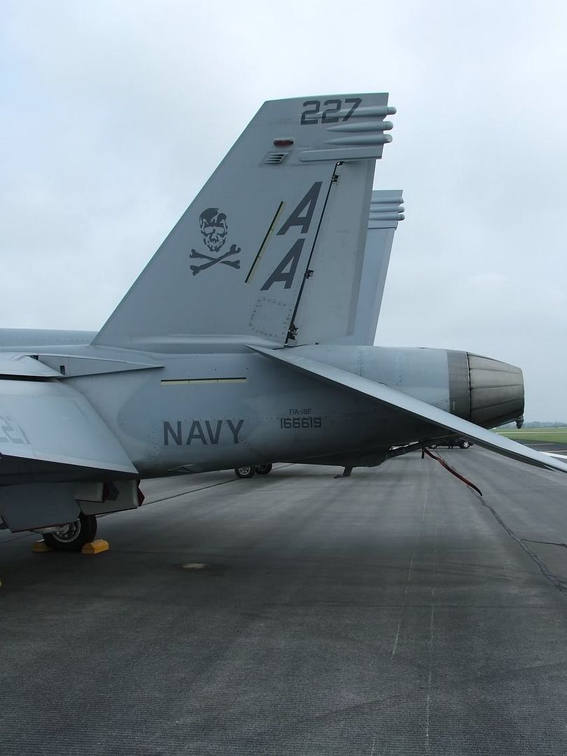

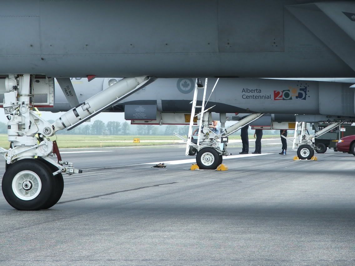

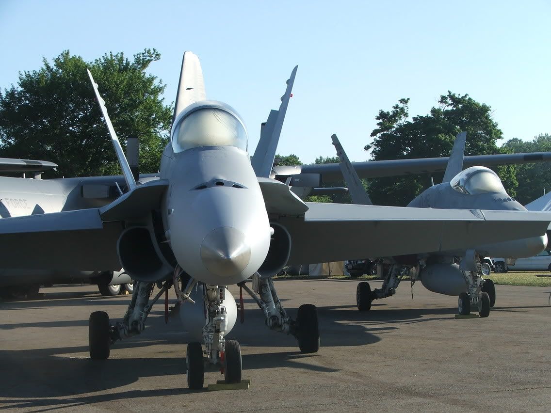

YEs they do.
F-18 Hornet Look close underneath you will see a couple.
F/A-18F Super Hornet Behind the wheel
Another Super Under the exhaust

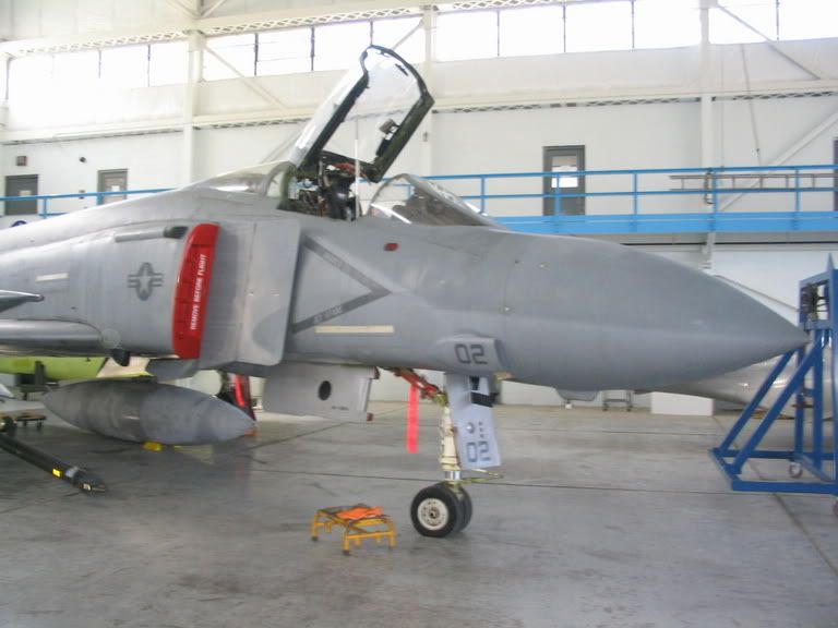

F-4S Phantom
As you can see from the above pics, Yes we most definately use them. Especially if something has a safety pin. Typically, the landing gear (the two mains & nose), Tailhook, Wingfold (on the Legacy Hornets A-D), one for the Canopy Eject Handle (left forward cockpit near the windscreen), one for the seat (middle front of seat near the pull ring). Sometimes there is one on the Stick Cover if the bird is armed and if there is any work being performed on the a/c, the support equipment might have one. I.E. speed brack lock or AIM-9 test set on the LAU. These are examples for the Hornets of course, someone who knows the other Navy planes as well may chime in. Hope this helps though.[:D] - Calvin

On the F-4 series of aircraft there is a safety pin in the nose wheel well, right side that is removed only in combat areas. During peace time the pin is installed and safety wired in.
