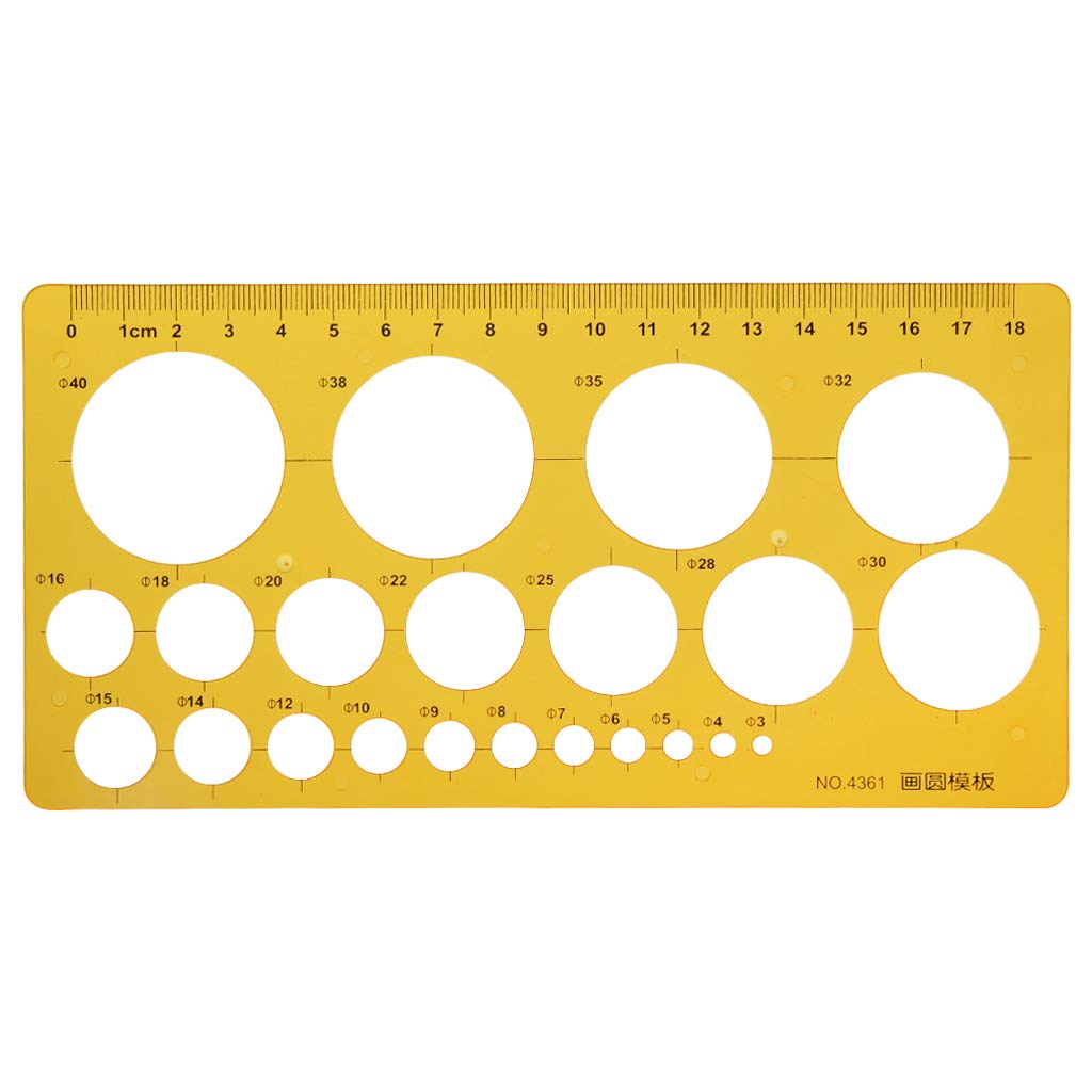

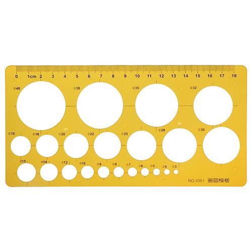

The only option I’ve come up with to get a good clean line is use a circle template like this.
Do you think it will work using the small circles?
Keeping it tightly in place is going to be key, and difficult. Otherwise you’ll get bleed through.
Hey Karljeff72, I have to agree with Aggieman. I think you’ll get some bleeding with the template. I tried the template method several times, but I had difficulty with bleed through and keeping the demarcation lines parallel. If you’re interested in how I do my spinners, I posted a quick how-to back in 2017. (Check out my response to Chemteacher’s post regarding the same exact issue. My reply is #9.) The only only change I’ve made to my process since then is I’ll sometimes use very thin strips of Tamiya tape instead of electrical tape.

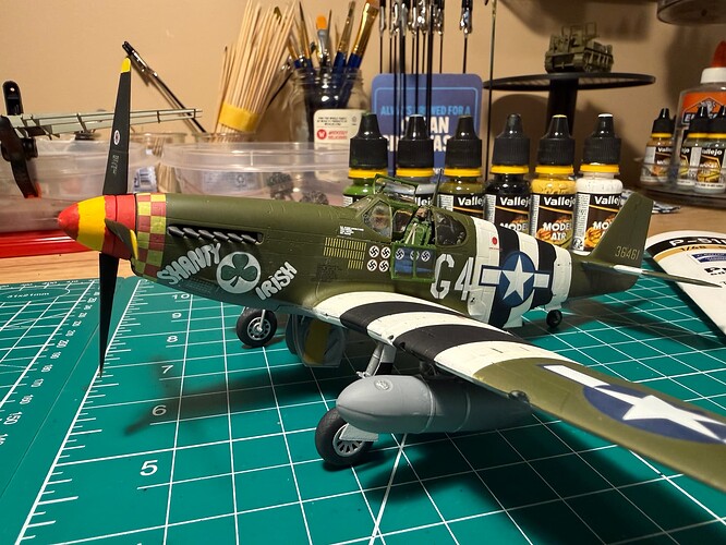

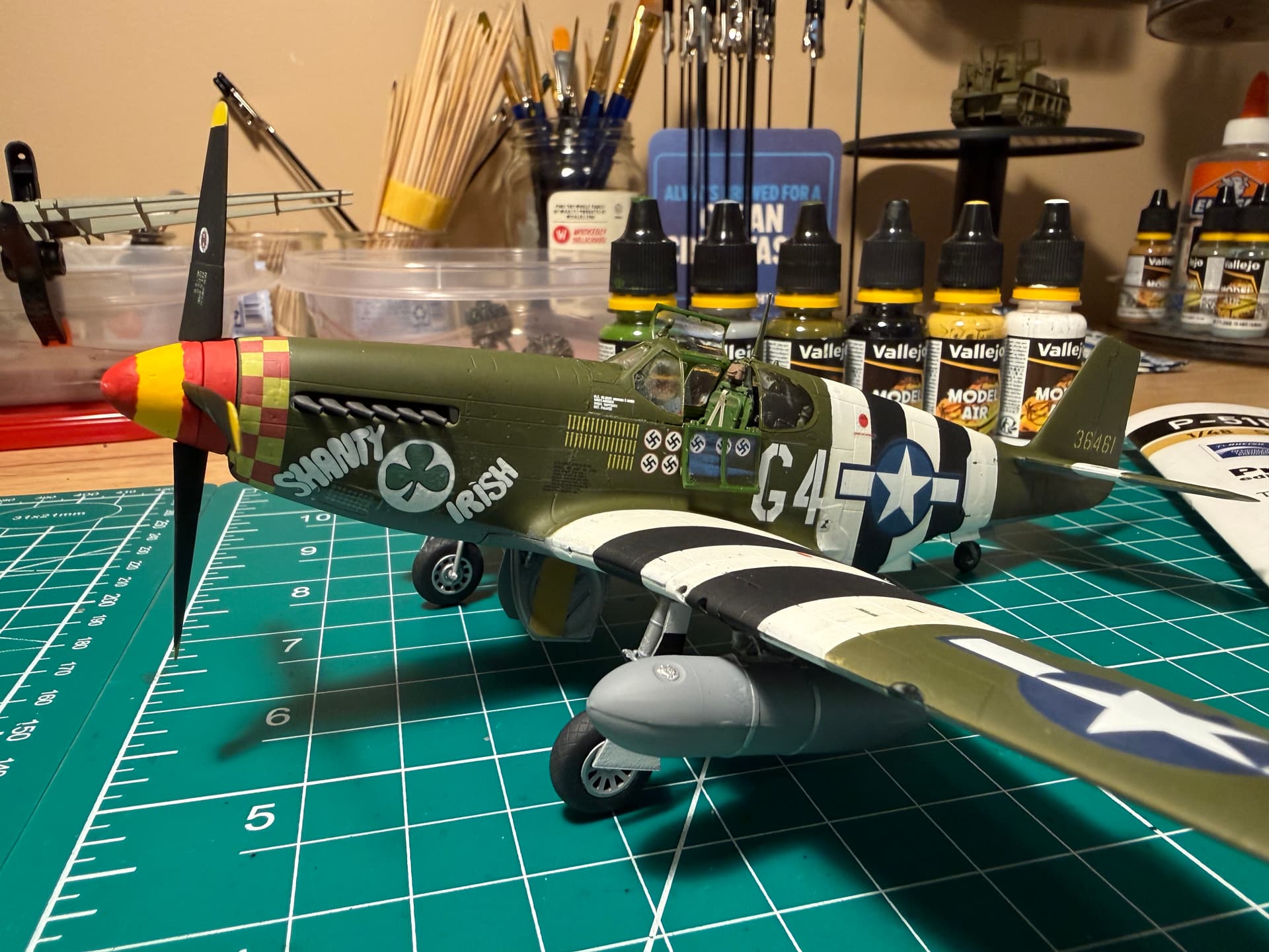

I tried hand painting with no so great results, my first Eduard model and really enjoyed the learning process. I am no pro for sure! The decals were too thin so the checkerboard didn’t come out right, should have painted white underneath, still learning!
Damn good effort.
The Red and Yellow chequed decal on my Exito decal sheet the Red is very dark looks more of a Maroon colour.
