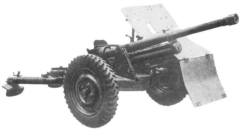

For the time being I have just finished the Bofors 37 mm anti-tankgun (Pansarvärnskanon: Pvkan m/38), that was the standard Swedish anti-tank weapon up until 1943. Some 500 pieces was sold to Poland before the outbreak of the war and the Polish gun was named “wz.36”.

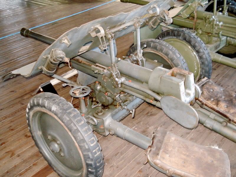

Because of this the Polish manufacturer TOM released a kit of the Polish version. The problem was to do a conversion back to the original Bofors gun that was used by the Swedish army. The worst part was to rebuilt the tires. The Polish verions hade tires with a so called razorback pattern, while the Swedish one had a strange pattern that looks like HO-HO-HO-HO.

nice. what’s the deal with the tires? different colors…please elaborate.
Sofasurfer:
Both the tires and the wheel hubs were different on the Polish version, so I had to change the Polish version, with its razorback patterns…
…into the Swedish version, with its special HO-HO-HO pattern:
I did this by carving out a 3x3 millimeter slit around the plastic tires, filling it with some ordinary spackle. After that used two small pieces - in the shape of the letter “H” and “O” - that I had cut out of plastic. When I pressed these pieces into the soft spackle, they formed the pattern HO-HO-HO, almost like as a rubber stamp.
When it came to the slightly different versions of the wheel hubs, I simply cut and sanded down the original plastic in some places and added new pieces and plastic bolts in other. Hence the different colors.
