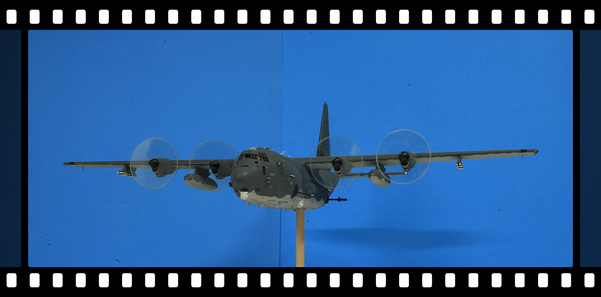

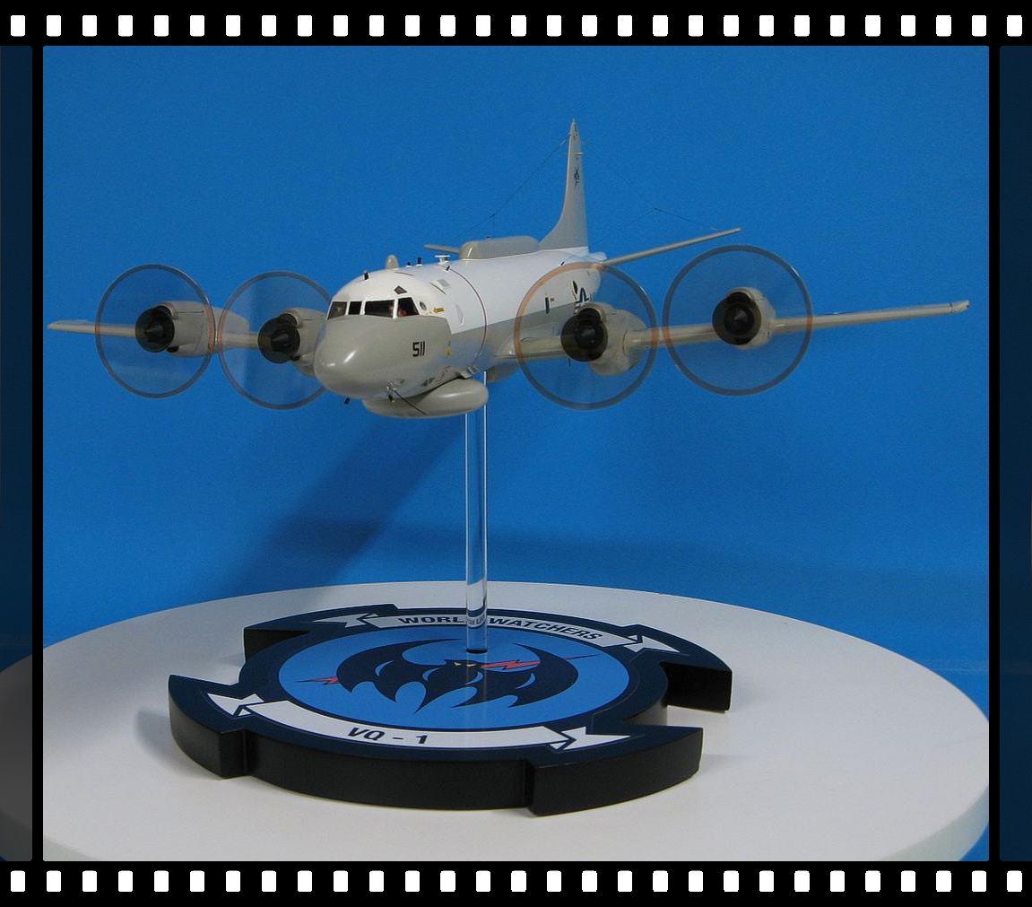

I had the same problem when I wanted to made “prop disks” for my AC-130J and EP-3E. My clear acrylic sheets were 1mm thick and everything I searched just didn’t seem like it would work. I made a jig with a pin in the middle so I could spin the disks on my benchtop scroll saw. I cut them slightly oversized then sanded their edges down until I had the proper diameter. All in all I think they came out very convincing.
Steve

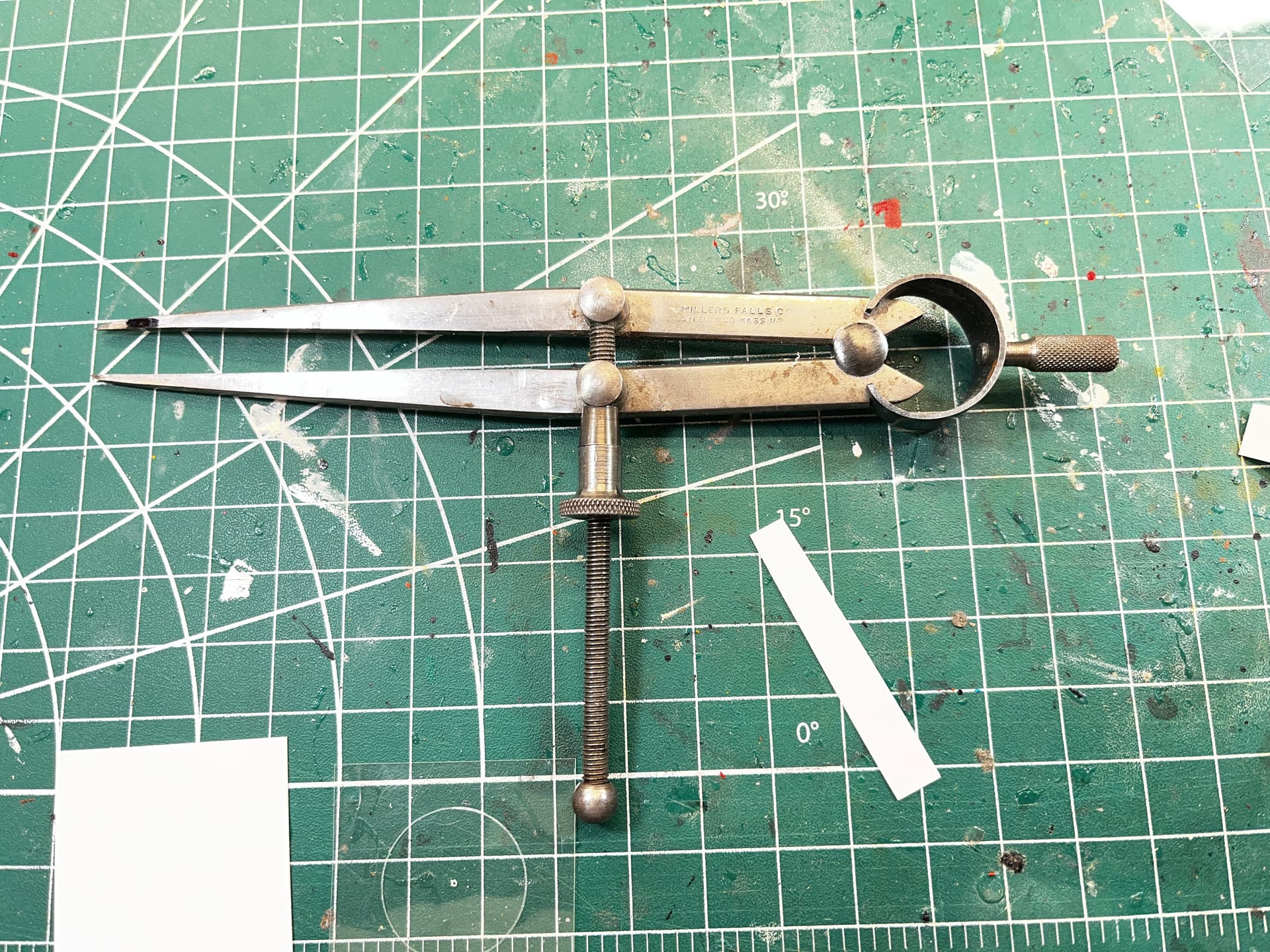

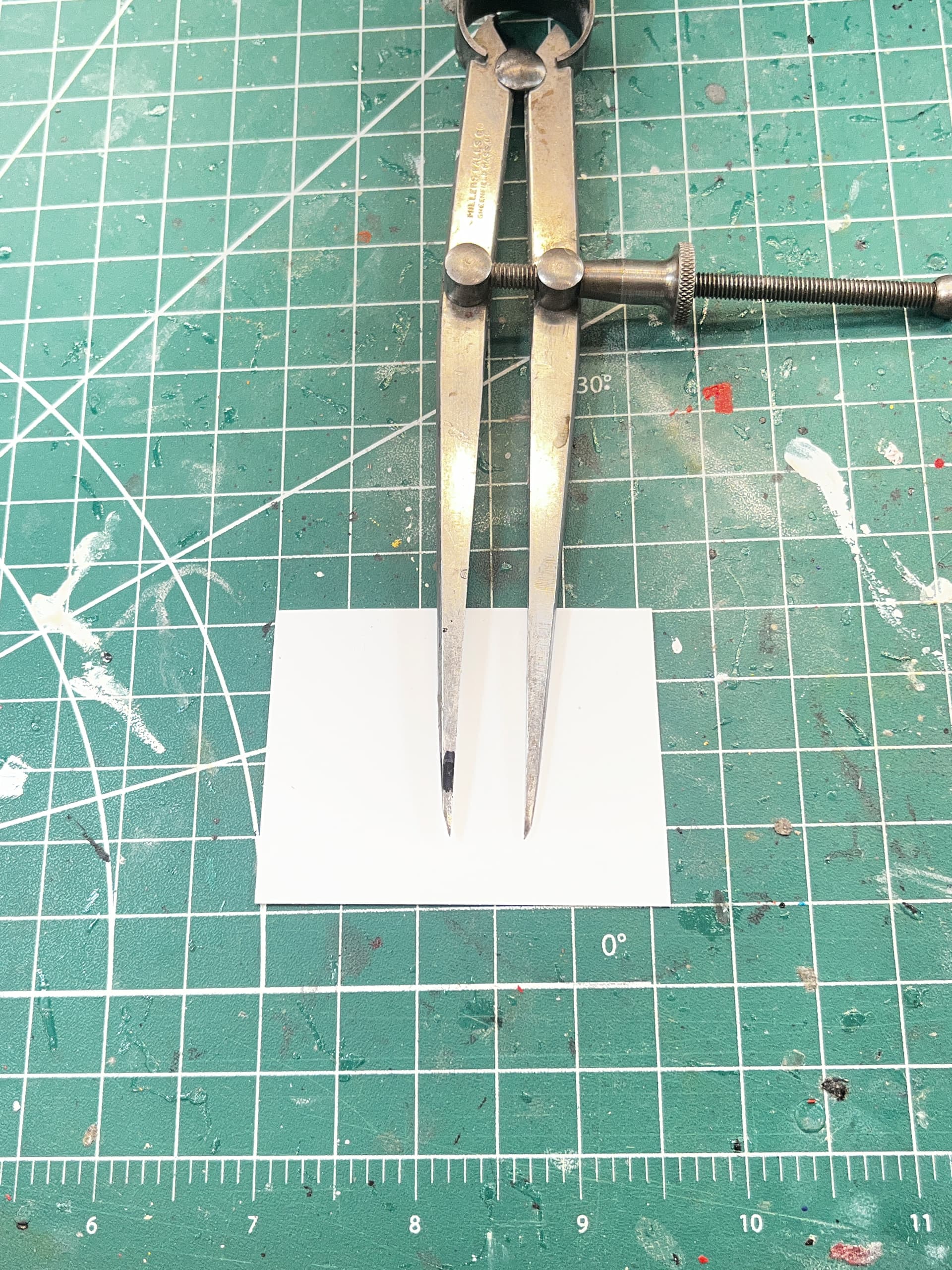

Best tool I could recommend would be a precision drafting compass with a second needle point, you could cut small to large circles and with the extender some huge circles.

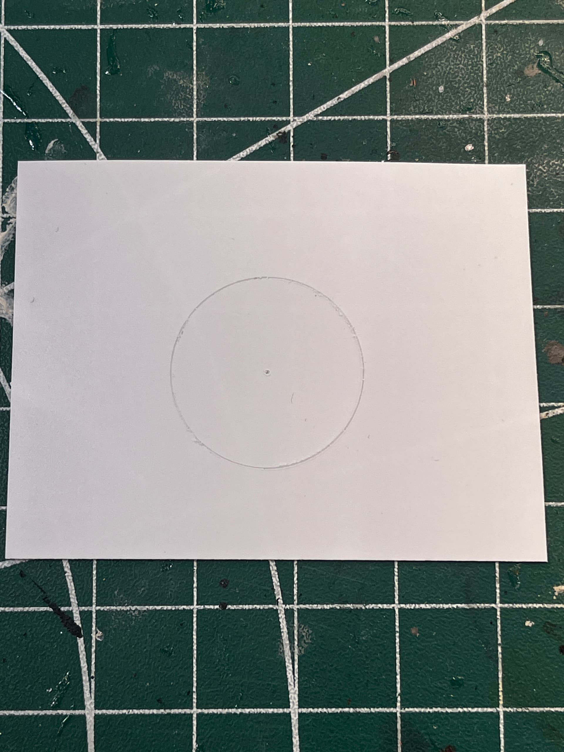

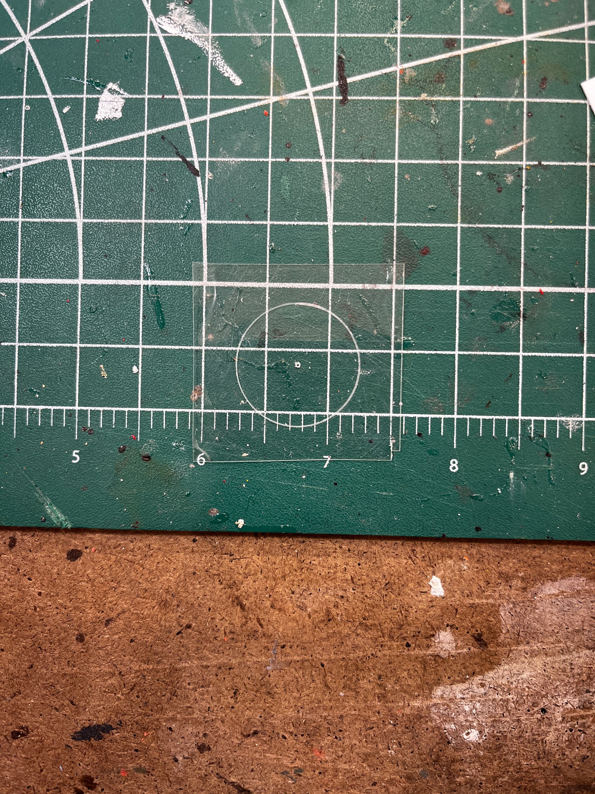

You wouldn’t need to cut all the way through the plastic, just score it and break it free.
I agree, this is one of my most important tools when it comes to Model building. This was a part of my father‘s tool collection. I’ve sharpened one point,( the one with the black Mark). Here’s an example of just a few passes on White polystyrene, and clear plastic sheeting. The point is so sharp, that I can actually cut all the way through the material. (although you wouldn’t have to, a deep score is all you would need.)
Those prop disks look fantastic.
Thank you very much.
