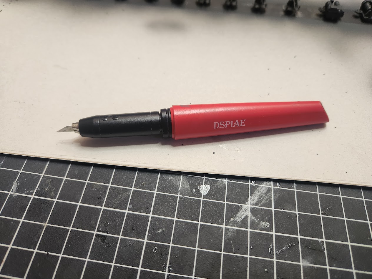

don’t know if this will help , but I purchased a despiae knife with small blade , buy using it really vertically , with gentle pressure , I have been getting a lot better results with PE .
just my 2 cents worth .
Thanks Steve. Always looking for new and useful tools.

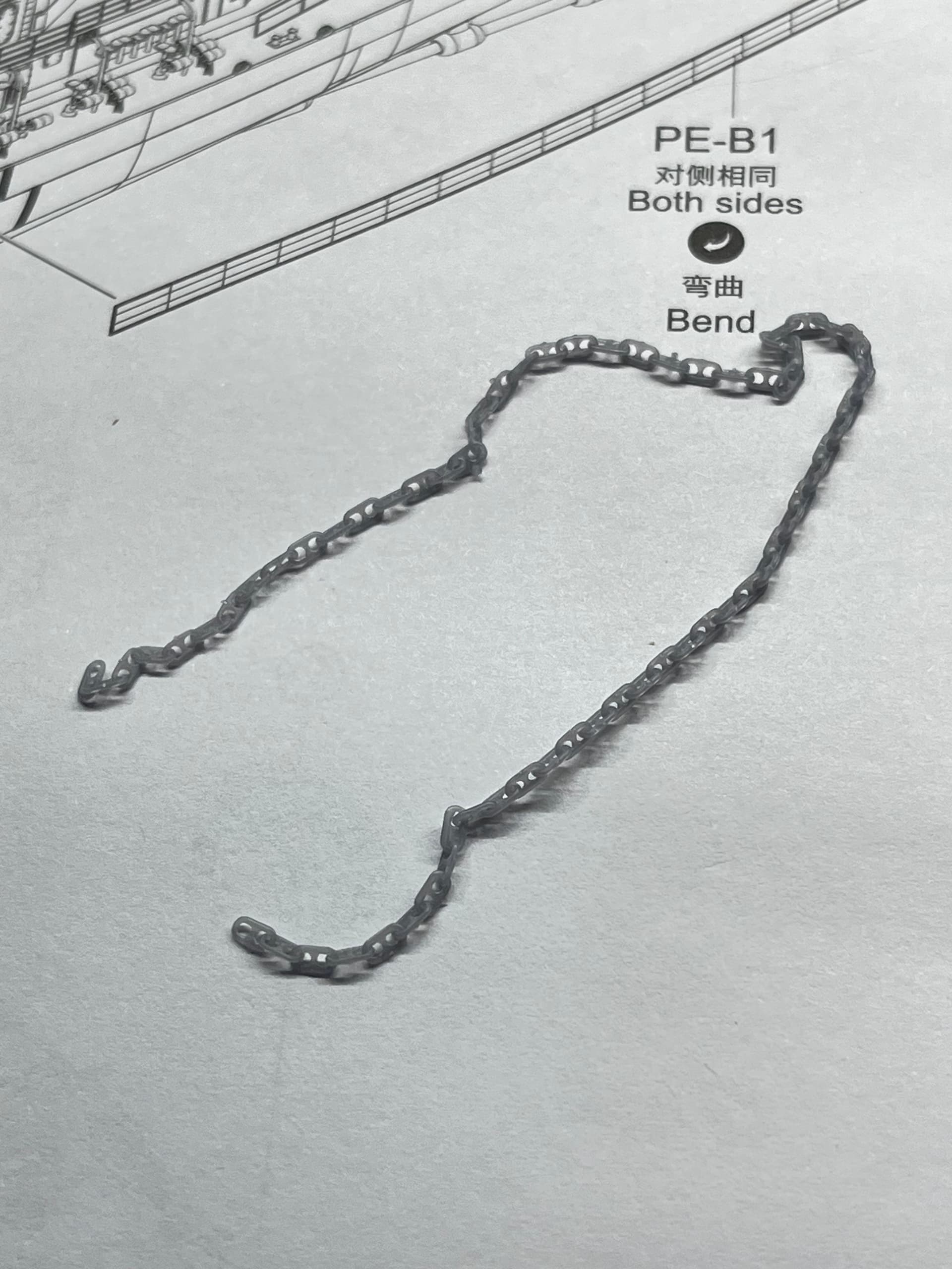

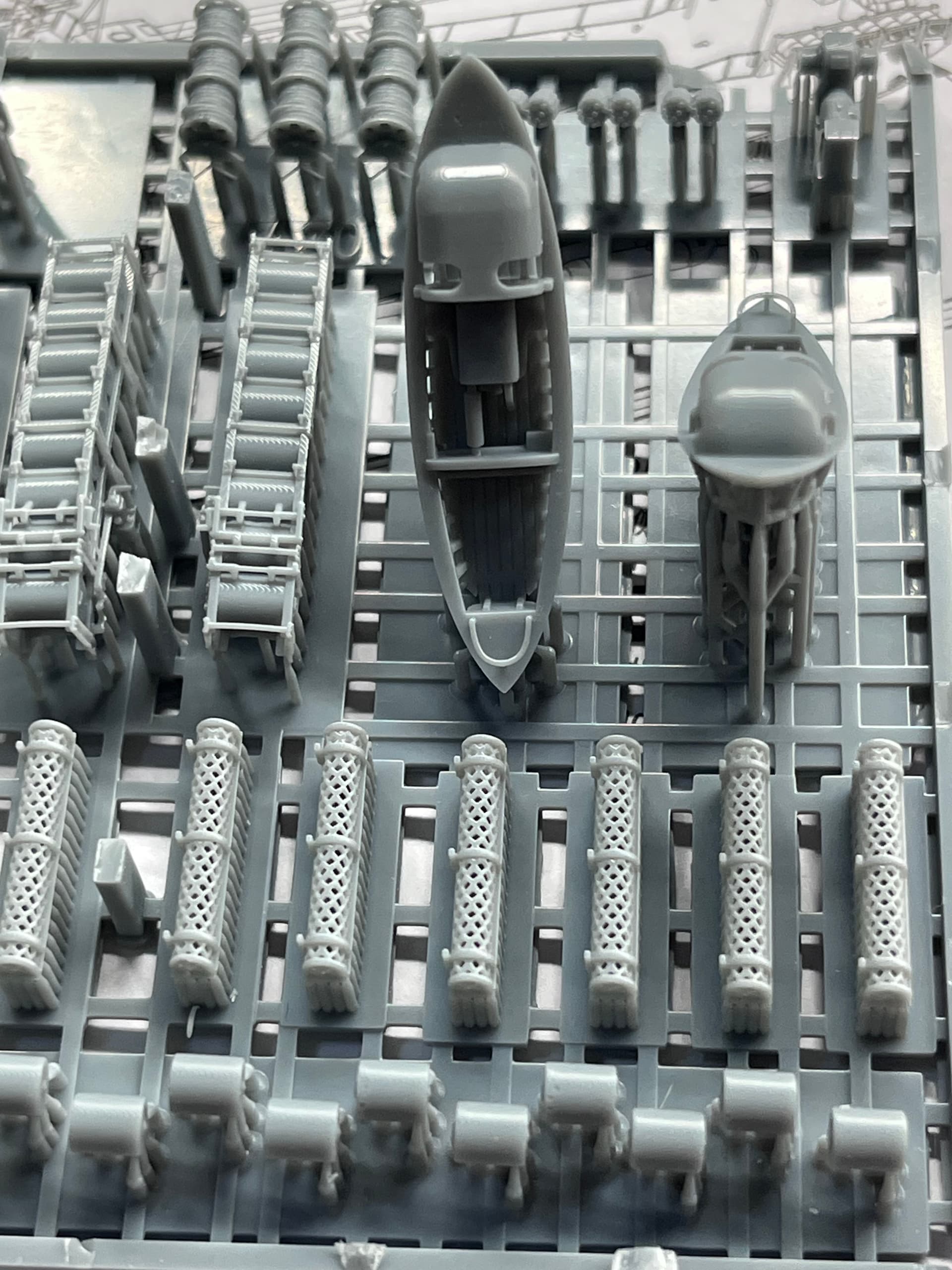

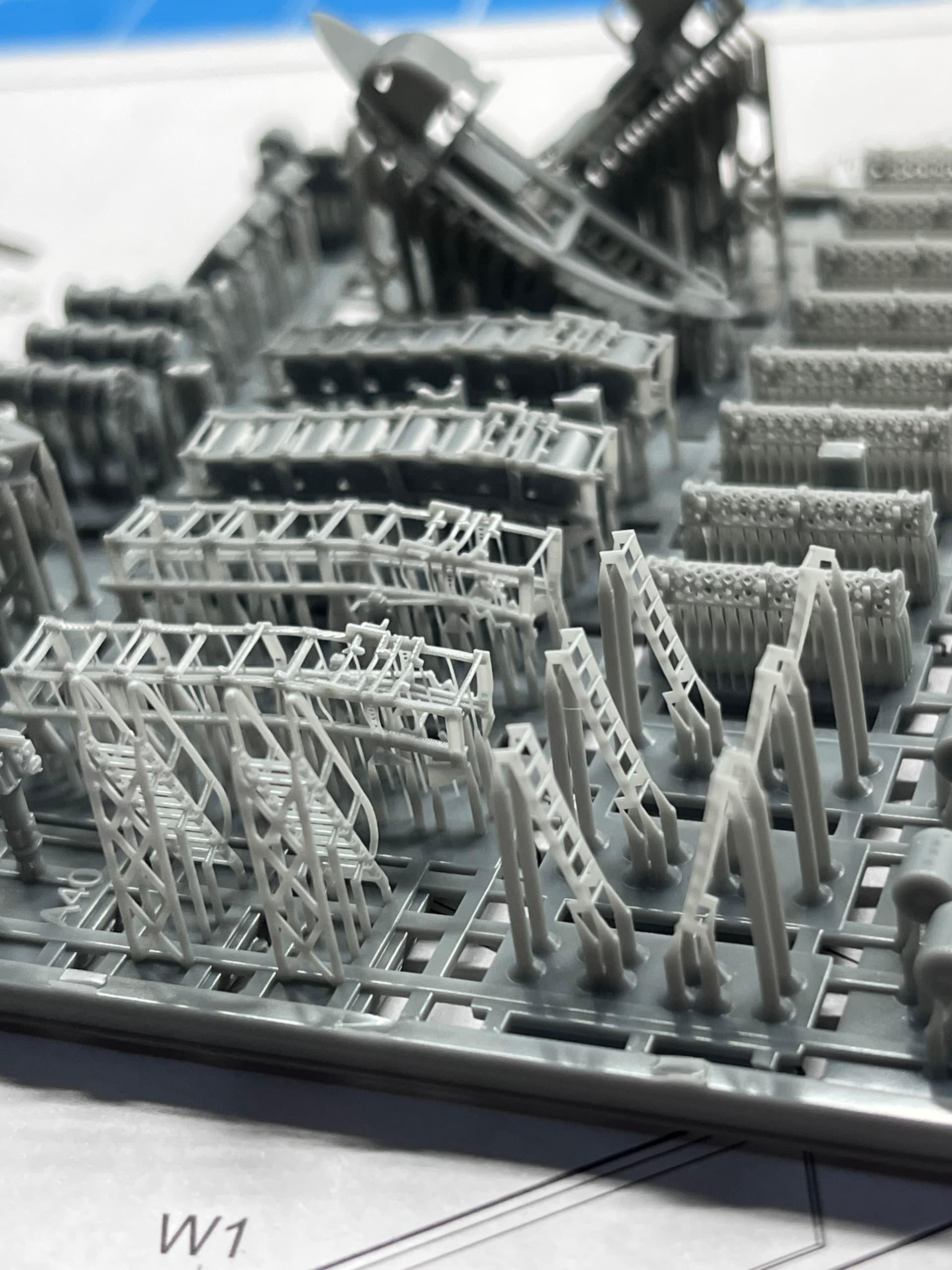

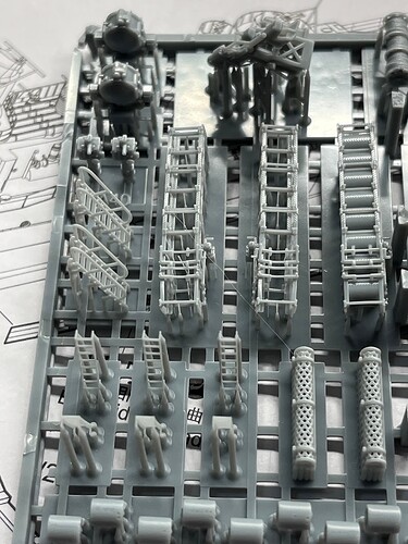

These are shots from Midwest Model Shops 1/200 Fletcher Supplementary kit. Everything looks great, nothing broken. It looks like the parts will be easier to get off than the racks were. The last picture is of chain I bought from the same place. It is amazing to me how they could make this chain with individual links, so that the whole length is flexible.

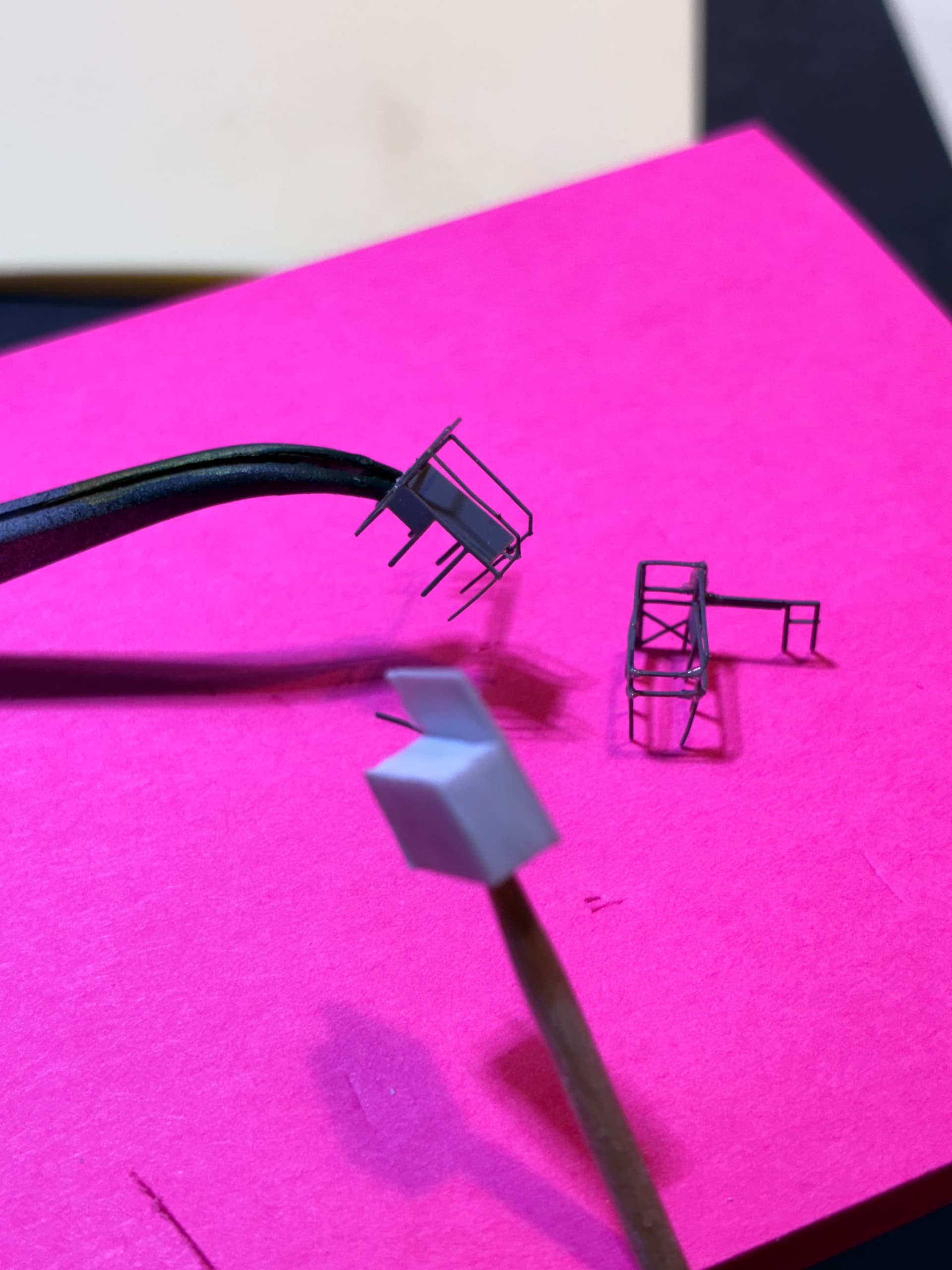

I finally got around to hauling out the calipers and measuring the dimensions of the waist depth charge racks on the 200 Fletcher/Stevens. By my cipherin’ they come out as 0.140 inches wide by 0.180 inches deep (+/-). Height is not a factor. I laminated some Evergreen to those dimensions. I added a toothpick handle for ease of use.
I wrapped the PE around the forming block to achieve the formed DC rack. Closed the edges with some UV glue

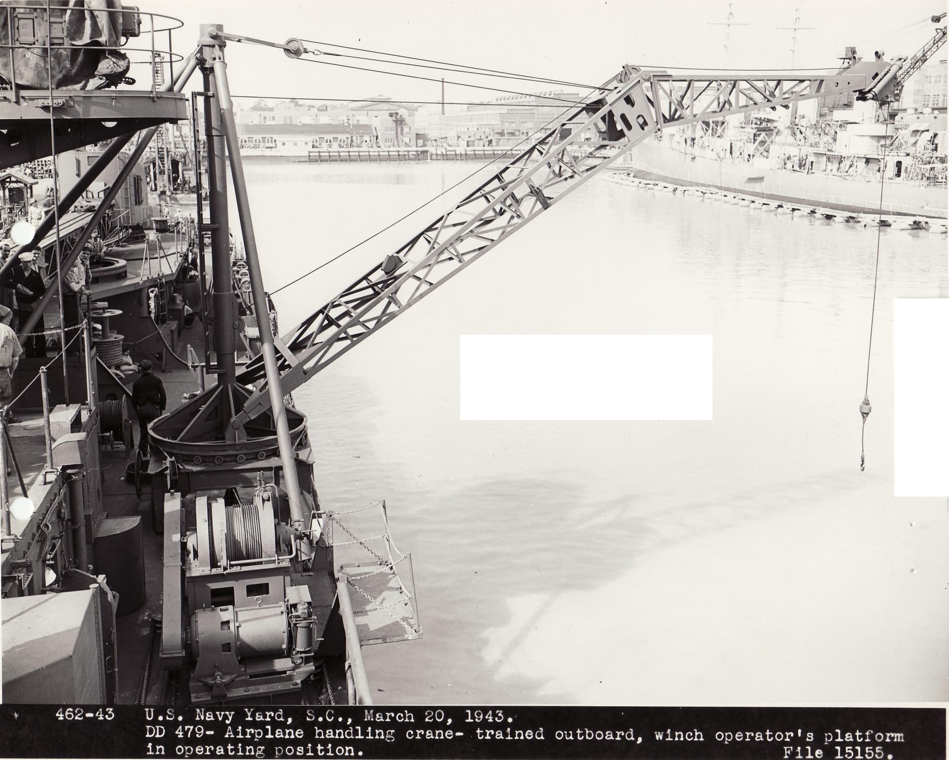

You may want to check your references. The crane you link from DiStefan
is a battleship/cruiser style crane.
The crane installed on the Stevens, and included in the kit is a fore/aft braced kingpost latticework crane
This configuration is different from that installed on the earlier members of the sub-class; the Pringle and Stanly. They had a centerline mounted, laterally braced beam crane. Stanly shown below. Note the censors caught the radars

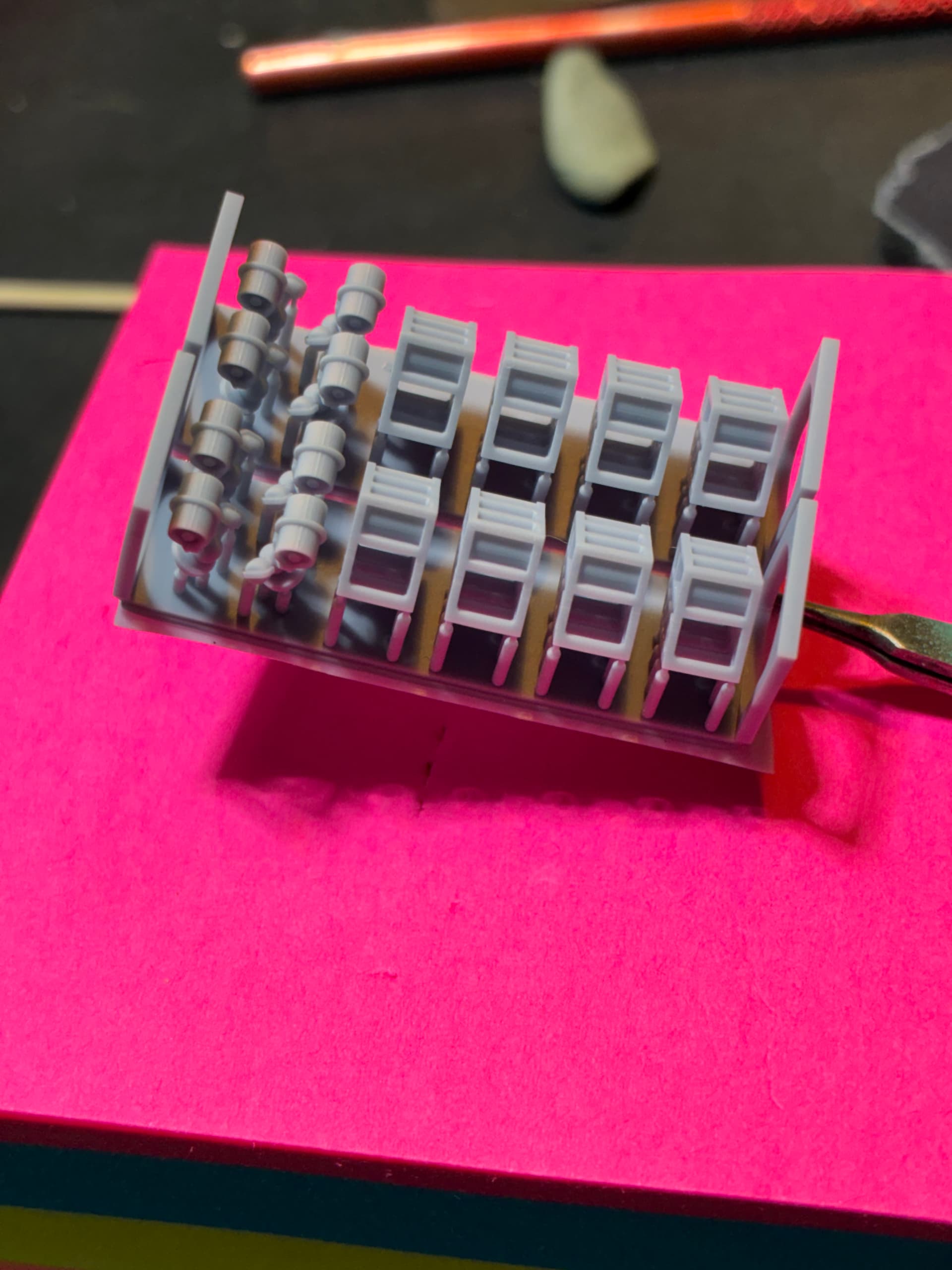

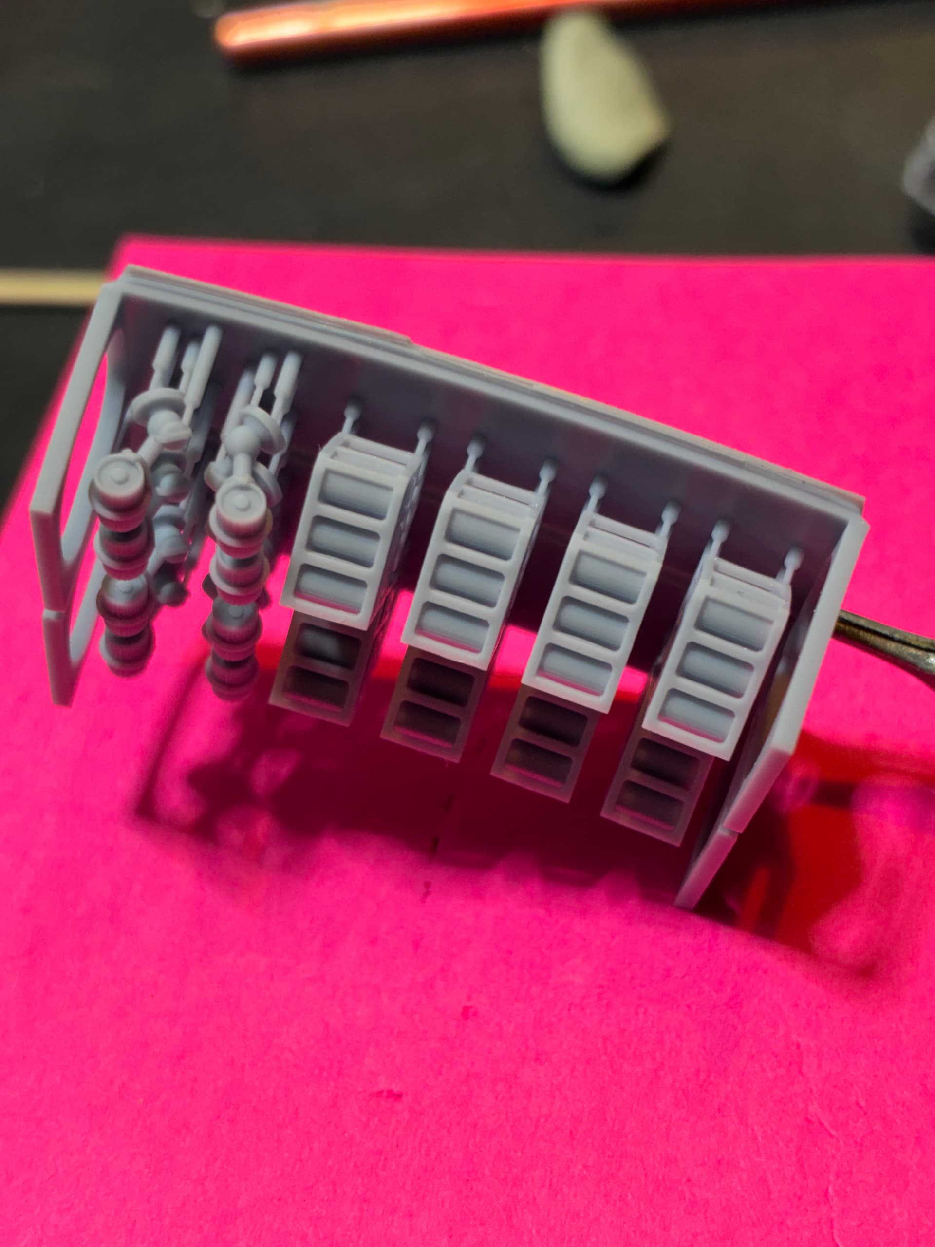

Received, Black Cat depth charge racks & projectors. My order got out before French Post shipping got shutdown for tariff & customs issues
This is the early war format DC can, the later war streamlined configuration is also available This item is sold as a group of four. The Stevens takes six, to this is an order x2. I’ll have some spares to start the Fletcher or other build. I also got some 12" and 24" searchlights to compliment the Midwest 36" 3D searchlights. Also, a 36’ motor whaleboat to compliment Midwest’s canopy version. Aft deckhouse railings are complete & the structure is ready to attach to the hull. Build up from there.
