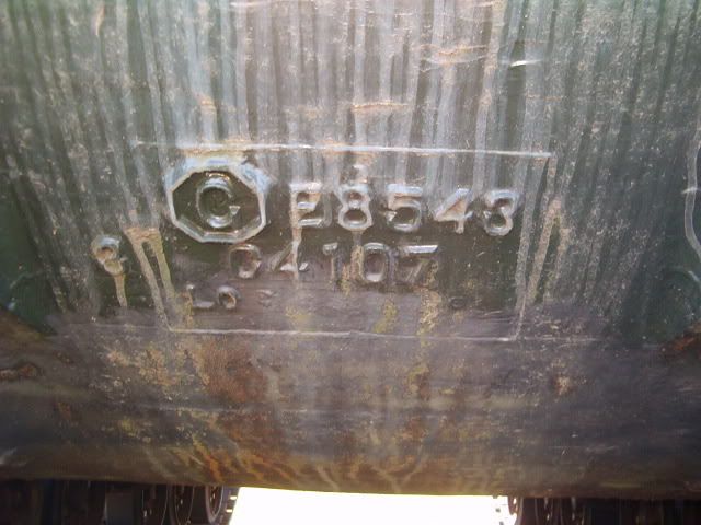

Here’s an area where you don’t look often
under the transmission cover on an M4A1E8. [:D]
