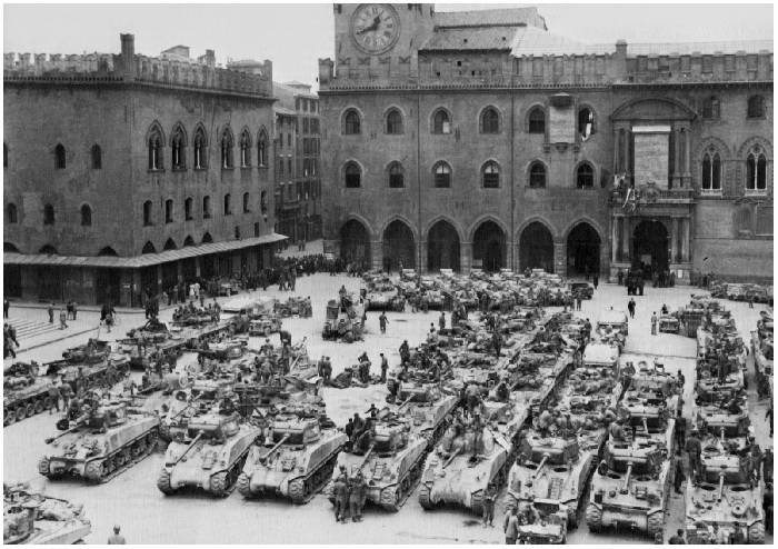

I believe the bog standard “M4” Sherman was used in decent numbers up until the end of the war, although it was not usually in the same squadrons as M4A1a or M4A3s
Actually early M4s like that saw front line service (in decreasing numbers) right up to VE Day in Italy.
This shot of the 752nd Tank Battalion in Bologna Italy, April 1945 has one in the front row. 3rd from right.
So I basically just have to change the bogies or build it as is under the assumption that at least some M4’s had the M3 bogies.
I’ve seen a picture of an M4A1 with those M3 bogies so it wouldn’t be too much of a stretch.
