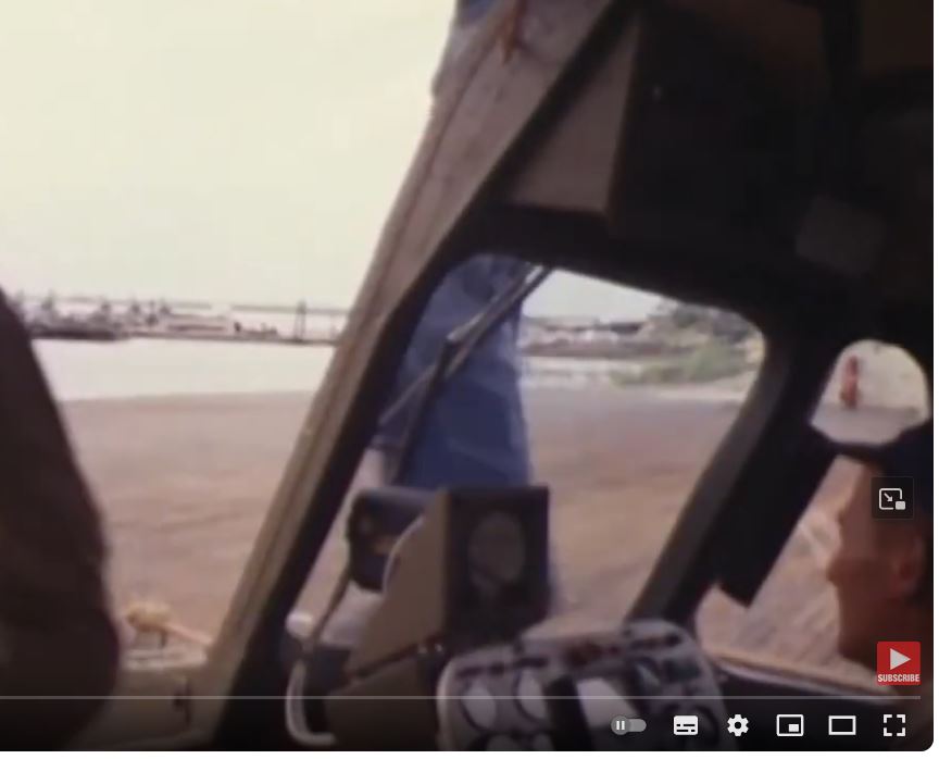

@mrb865 - I wouldn’t say the interior colour is thing settled… It’s definitely gray now, BUT
  1. This picture from a period movie suggests otherwise:
  1. This picture from that great walk around:
where the paint peels would suggest that green was overpainted with gray.
So I’m still going for green interior.
