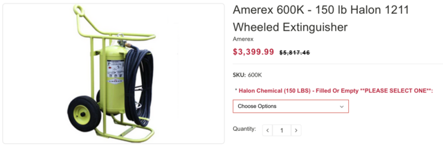

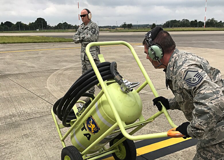

Is the lime green used on USAF fire extinguishers an FS color?
Thanks!
I believe that’s a oxygen tank
Do you mean the fire extinguishers they have on the flight line or something else?
Flight line
PKP extinguishers are red with purple PKP stenciled on them, Halon bottles are bright yellow, CO2 are also red hoever have a whit stripe. Rarely will you see a pure water extinguisher as exotic metals, fuels, and oild usually react poorly especially while ablaze. Magnesium is a prime example. NEVER use salt water on LOX. Salt water may not be present on an AFB but ya never know.
Flight line bottles would most likely be the yellow Halon.
And most manufacturers’ catalogs simply list it as “lime yellow,” without reference to an FS number or other color code.

I thought I’d follow up on my own thread with what I came up with in case it can help someone else. Of course, the real life extinguisher colors vary from factory new to severly faded.
I ended up mixing a ratio of 10 drops Tamiya X-15 with 4 drops Tamiya X-2 and cutting it 50% with Tamiya lacquer thinner. Very close to the photos on the Amerex website.
After the fact, I saw a bottle of Testors Sublime Green at HL and checked it on a test peice. It’s VERY close straight out of the bottle. If you prefer brush painting or enamels in general, that’s another option.
