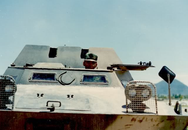

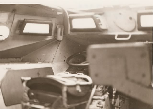

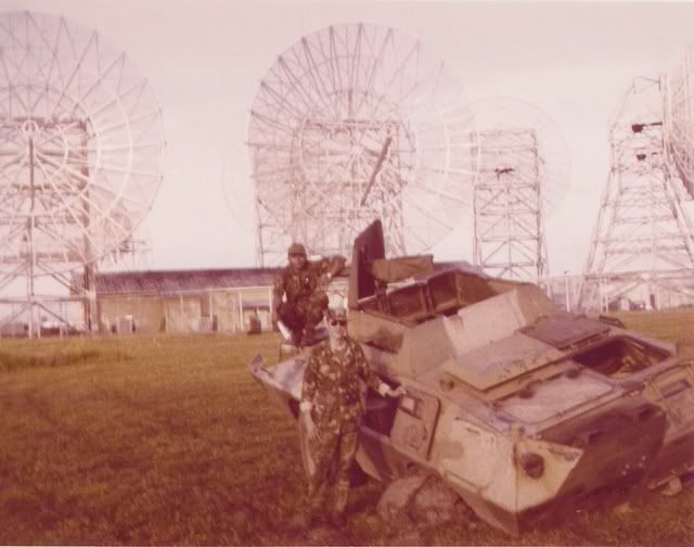

These should give you a slight idea. If you’re curious about the log in the one picture, they took telephone poles and used them as parking dividers at the armory.
Hello Bob!
Thanks a lot for the photos! I definitely want to use that info about those white ammo boxes here.

Here’s a coiuple things I don’t think are mentioned in a book. There was no fuel gadge for the two tanks, only a clear tube one on each side, that you had to watch, usually with a light and under the driver’s seat was a round piece, about the size of your hand and only a few inches tall. This was the master cut off switch that killed all power to the vehicle. It was practically invisible because of its location and usually only the driver/team commanders knew it was there. Supposidly. I’m sure that most of the RTGs in the reaction team knew about it but didn’t care, it was the driver’s problem.
