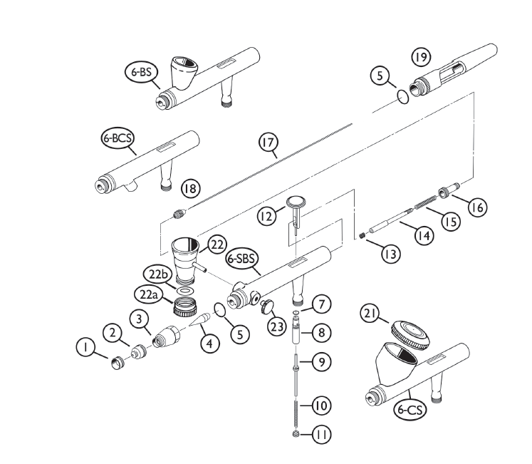

Check the nozzle cap and the head cap for any obstructions (parts 2 and 3).
I helped someone who had a similar problem. After stripping the airbrush down to every component that could be dismantled and cleaned, it was the part labeled 1 in Veedub’s posted diagram, the crown guard. It had some dried bits of paint I could not see. I was ready to give up and told my friend, well we’ve looked at everything, but I can’t seem to find the problem. Maybe we try cleaning the crown guard. So I threw it into some thinner and found the dried paint when I was drying it off. The airbrush then worked perfectly fine.
Lesson learned - clean everything.
