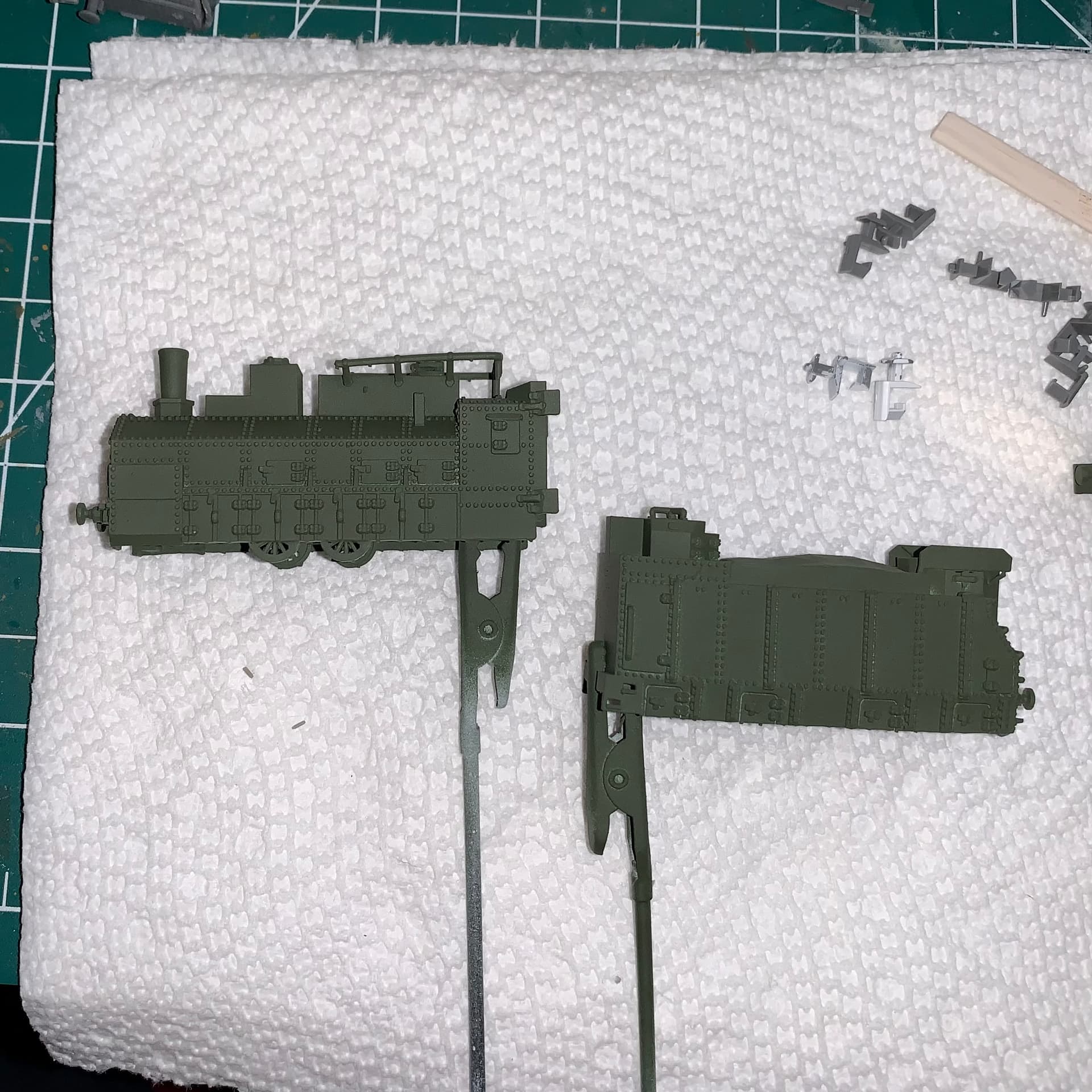

Almost done with these. Loco and tender, and some gun wagons.
It’s looking good. That’s an interesting subject.

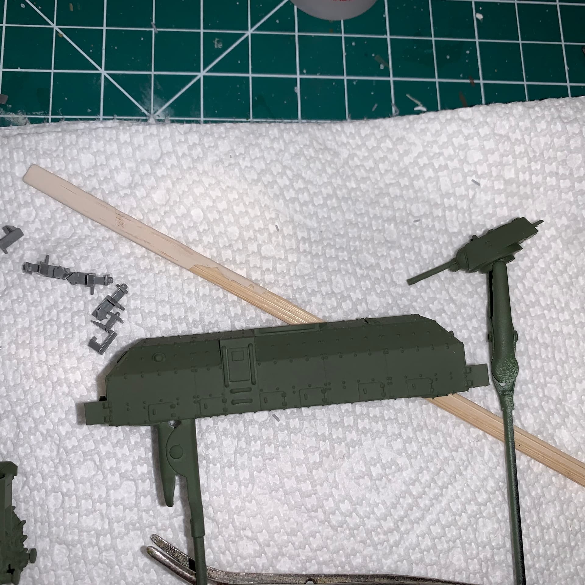

Working with Vallejo spray over Army Painter primer now. Seems to be a stable combination.

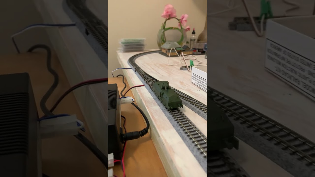

Getting there. Need to work on the layout…
