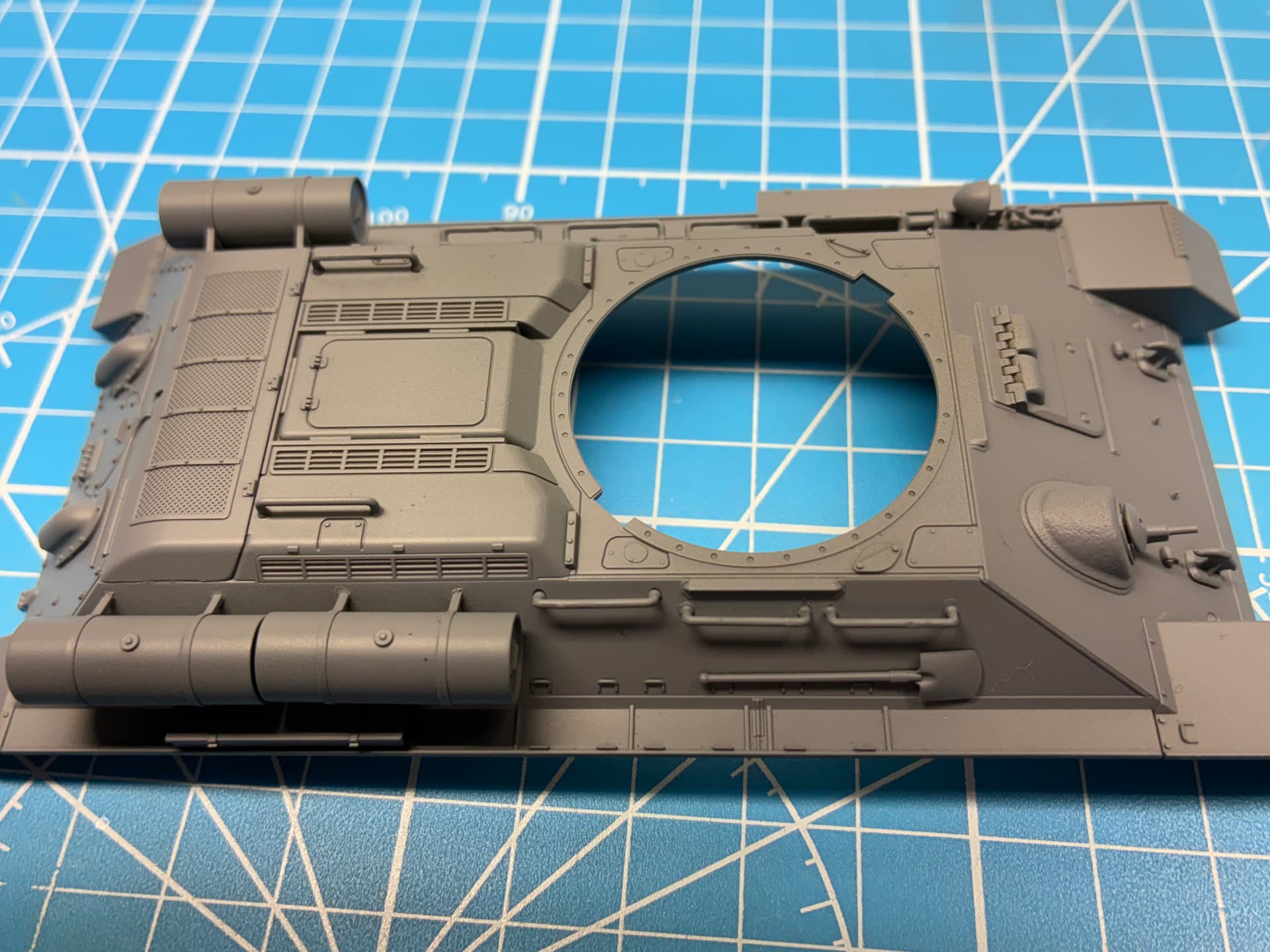

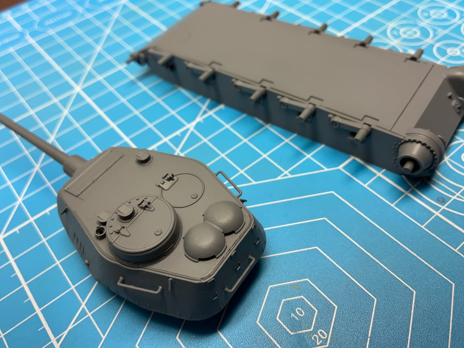

Finally used up my Tamiya primer and shot come Stynylrez grey onto a Tamiya 1/48th T34_85.
Used Paasche Talon with .66 tip and 25 psi air.
Sprayed very well and flattened beautifully.

I saw comments along that line. I had no clogging issues at all. I did “clear” the tip a couple of times. I guess it was the .66 tip I used. (Badger recommends .5 or larger). I was worried about how much flow i would get with that big a tip and 25 PSI air.
As to cleanup, it cleaned up easily with alcohol. I did disassemble and clean the Talon.
