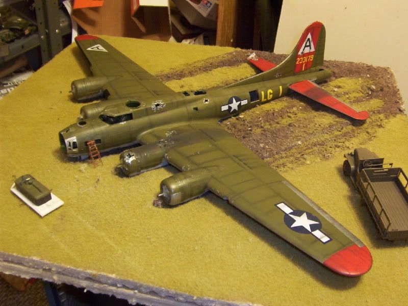

Can’t really help ya with pre-shading, since I don’t do it (it’s not possible to undo easily, lol) so I post-shade with pastels…
Here’s what it looks like on my B-17 WIP… I used black on the OD and dark grey on the grey undersides…

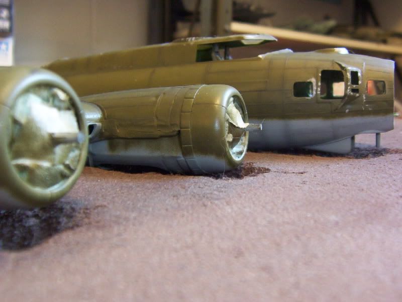

You can kind see the grey areas here:
Should work the same with the SEA camo, although I’d probably use the dark grey mixed with some dark yellow on the tan areas rather than the black… The black might be too intense there…

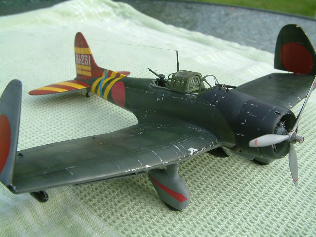

I do a similar thing myself. After ive painted the top coat, with whats left in the cup i lighten the colour very slightly (Go too far and youve blown the subtlety) Then starting in the centre of the panel you want to lighten, spray. Mist it in, dont spray heavily. If it looks to stark you can blend it in to the surrounding colours with the original top colour. Heres an Aichi Val i did a while back,
…Guy
