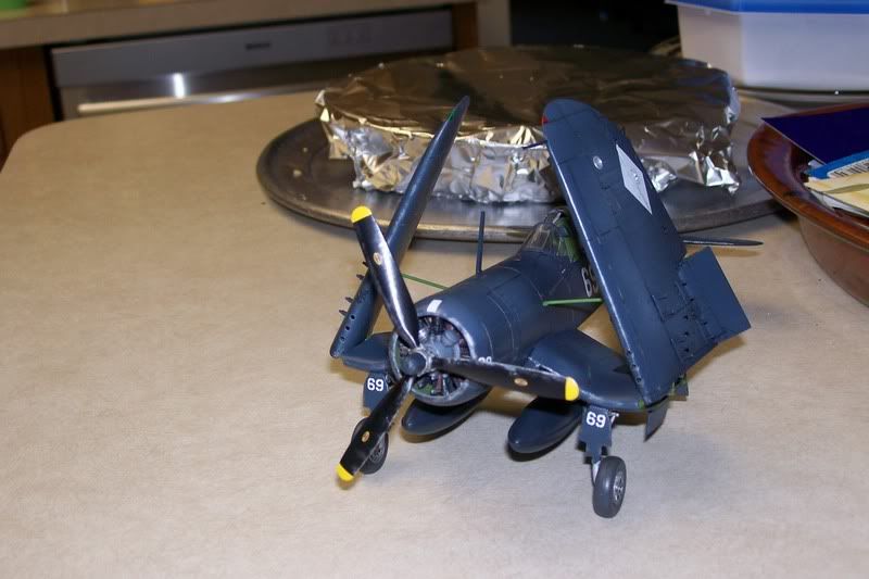

Gigatron, I’ve preshaded a couple things, and I’ve got to say you really can’t do it on dark colors. I built a F4U-1D and after preshading and imminent failure, I lightened the colors where the paint would fade, shown here-
Then I used a wash to post shade-
The wash shows up, but it doesnt punch you in the face so to speak. So, if you lighten the colors, you can use a wash. Or, you can lighten the center of panels. That works too. I haven’t attempted that yet, but I’m going to try on my P-38.
