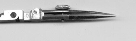

I’ve always used a drafting/ruling pen for these kinds of adhesives, something like this:
The little wheel gives you great control for the amount of adhesive you want to use, and the sharp nibs give great accuracy for placement. And since the nib assembly is metal, no worries about solvent eating it. They’re available at most art supply stores and many craft outlets.
