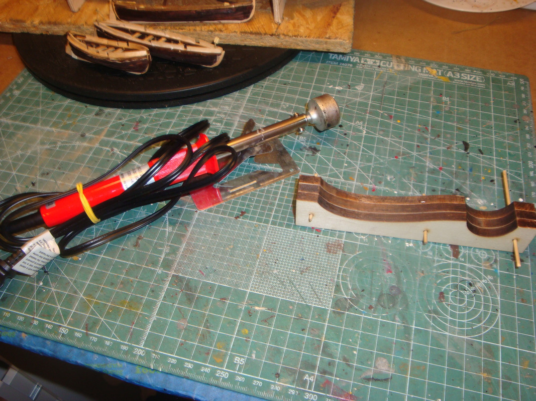

I had the oportunity to use my new plank bending tool. I found it to do the job and makes the bending of the plank easier, but, there is a learning curve with it, if you press to hard or attent to bend it before the plank is fully wet ( you have to wet the plank for at least 5 minutes) then you are risking for the plank to break on you.
Some one with the proper tools, can manufacture this tool, I had an older sordering iron but the end has a very pointed end, and this point made it very deficult to bend the plank and easy to break, what makes this tool work is the rounded end, I do not have the proper tools to make such rounded end, so to me, it was worth to pay the 40 bucks I paid for it.
Besides this I fully recomend it.

I have been using the plank bending tool in the construction of my current build, Columbus Santa Maria, I find this tool indispensable, it makes the bending of the planks to the exact bend very easy (That is as soon as you master the tool, like I said in my previous comment, there is a small learning curve with it ).
This has increase the speed of the build and has helped me learn more about the technique involve in installing the planks, I highly recommend it.
