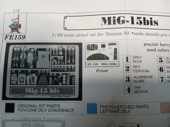

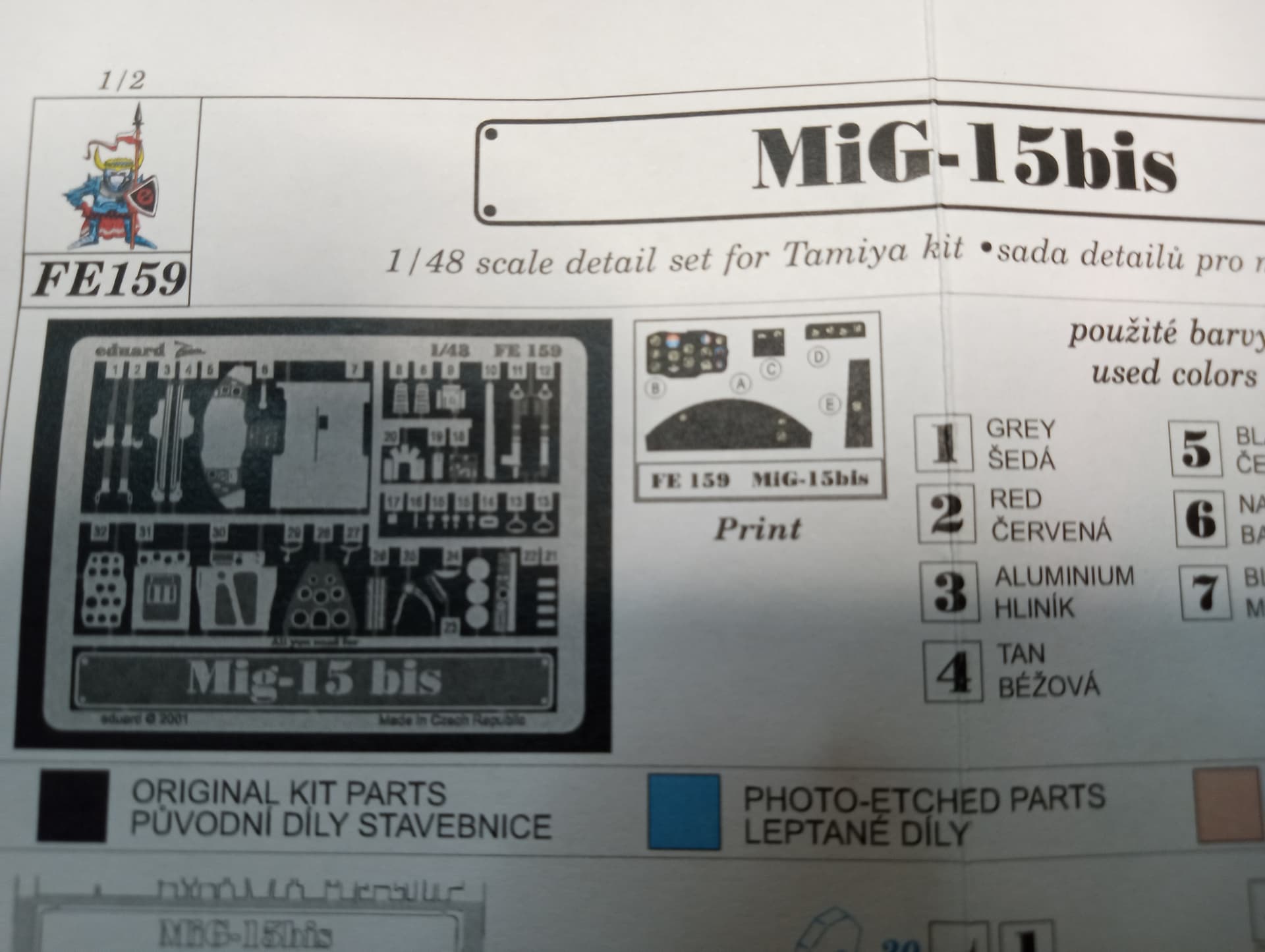

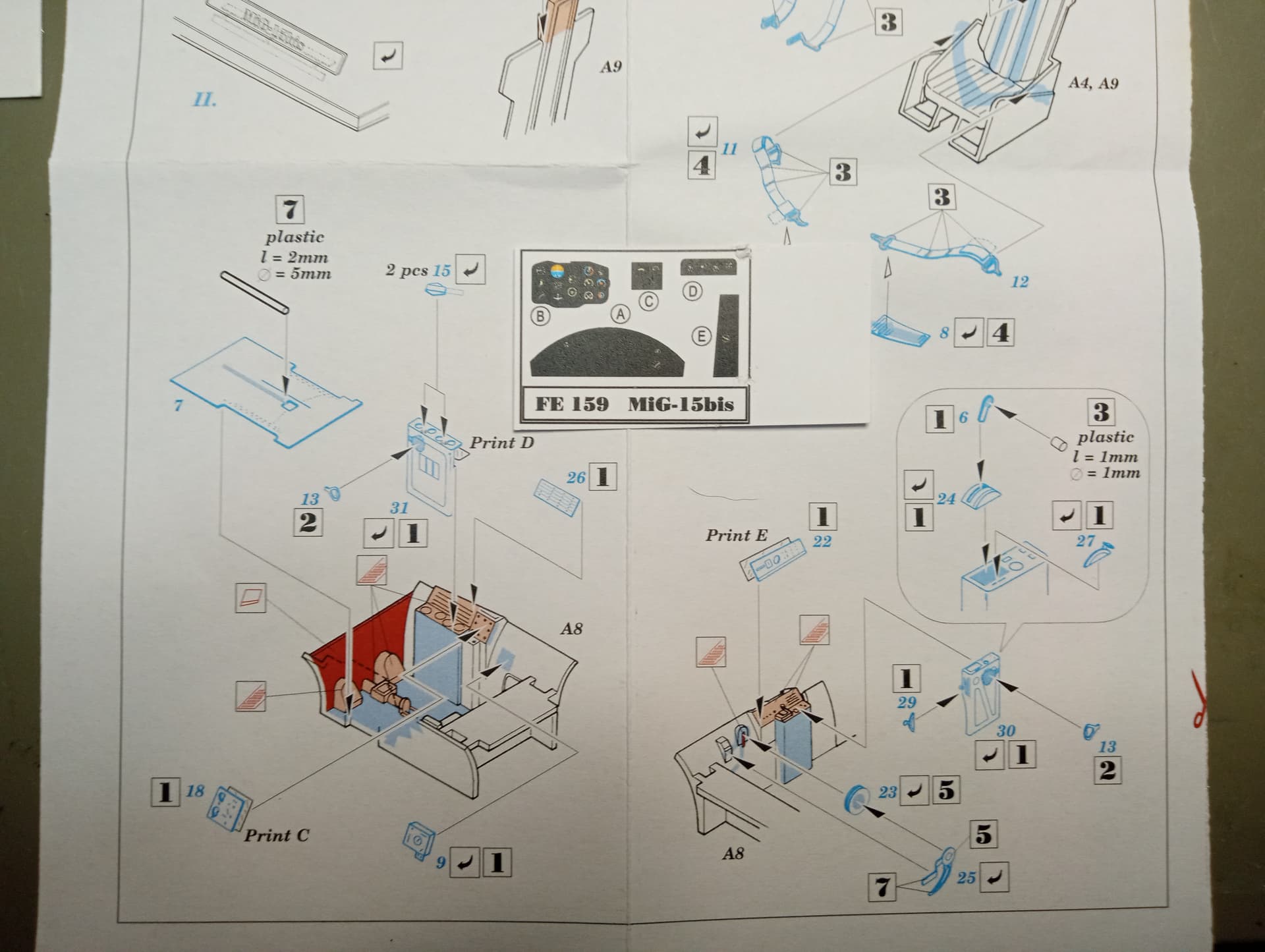

This is my first time working with Photo-Etch at this level of detail. How do I transfer the print images to the actual parts? Do they transfer like decals?

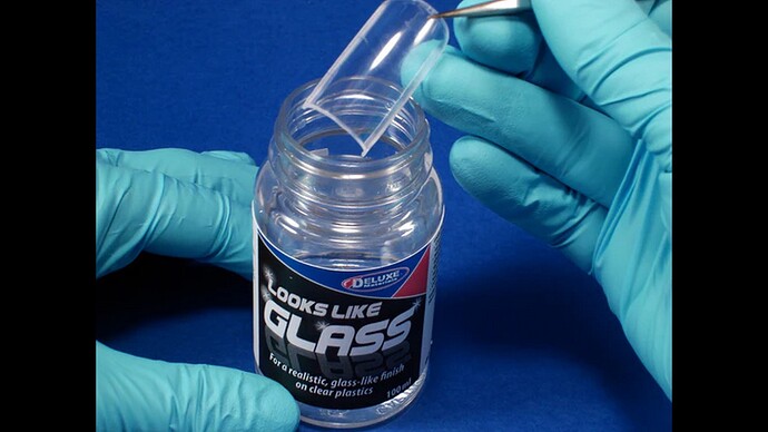

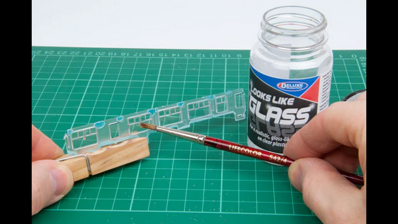

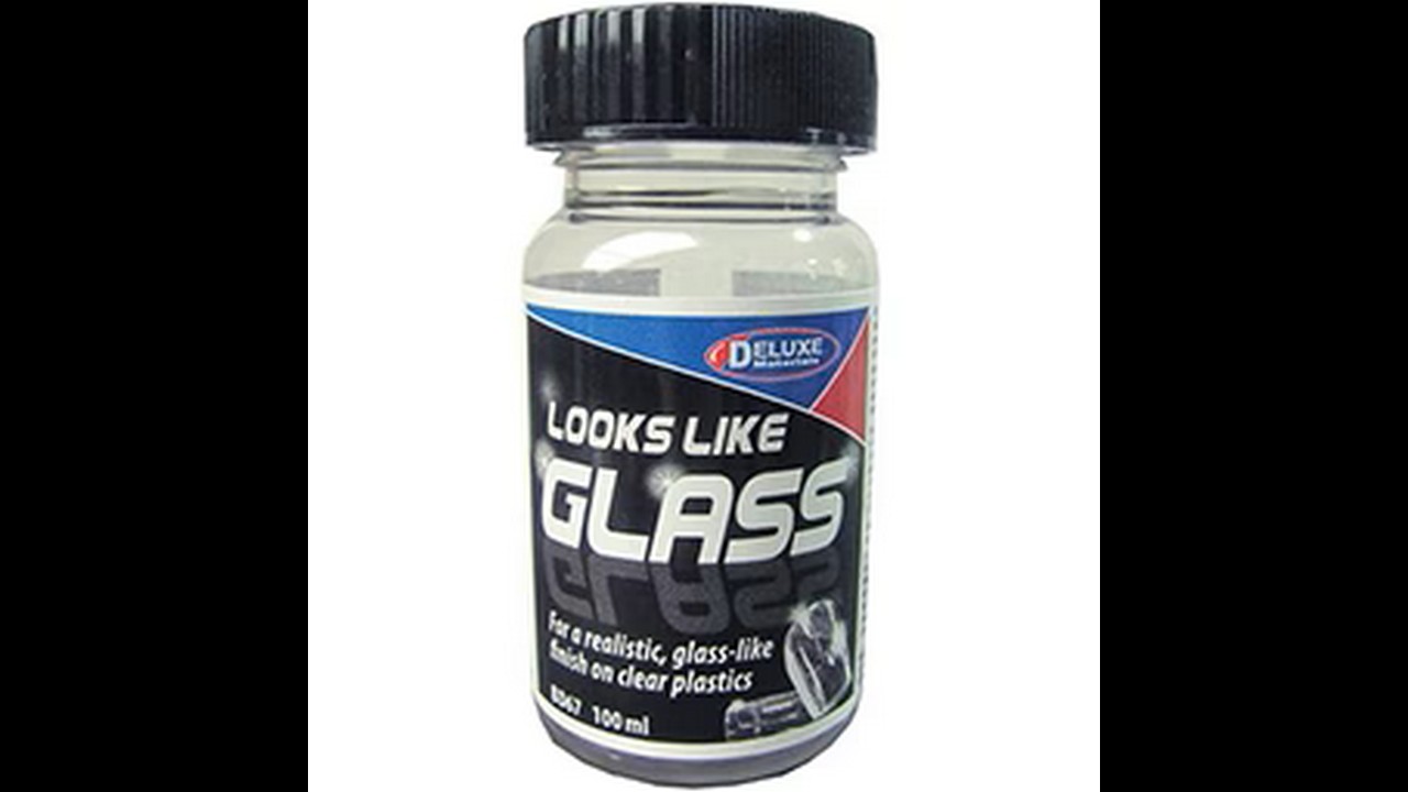

Once cut out, the printed part has to be glued to the previously blank detail part you want to cover. How to do it? There are special glues and not corrosive ones out there. One I often use is Deluxe Looks Like Glass (see the photo at the end of my answer), which not only functions as a canopy cleaner, but also functions as a non aggressive glue for transparencies and even decals holding them in place without marring them.
Let it dry thoroughly before proceeding to the next step. Once completely dry and so fixed, you may proceed with the application of the PE part over it being careful to align it over the printed transparency. Dry fitting is now called for this process.

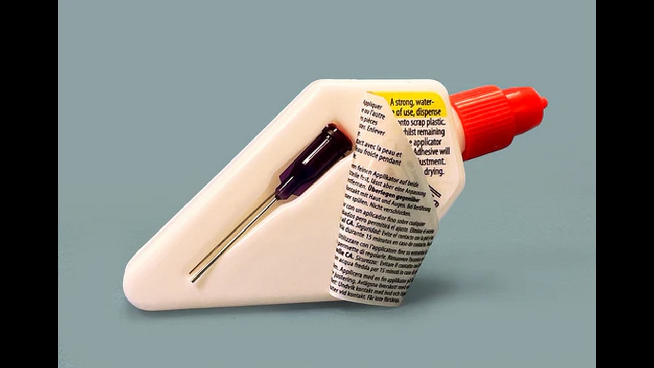

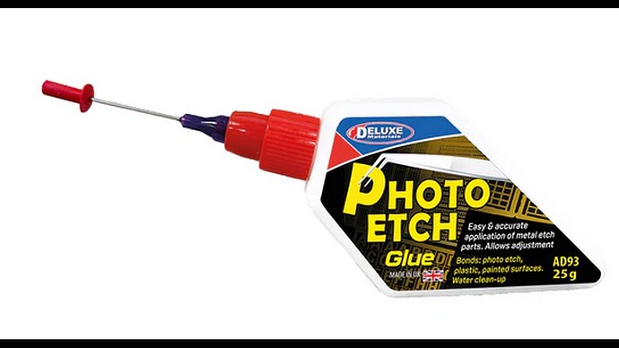

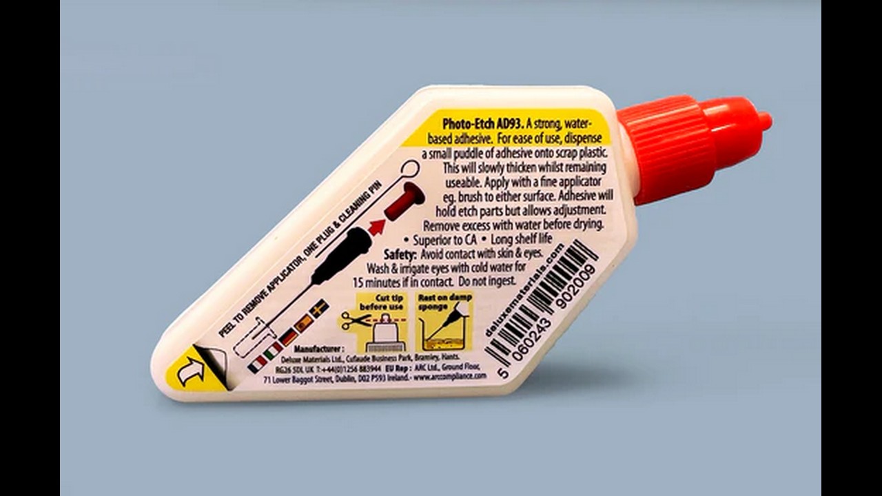

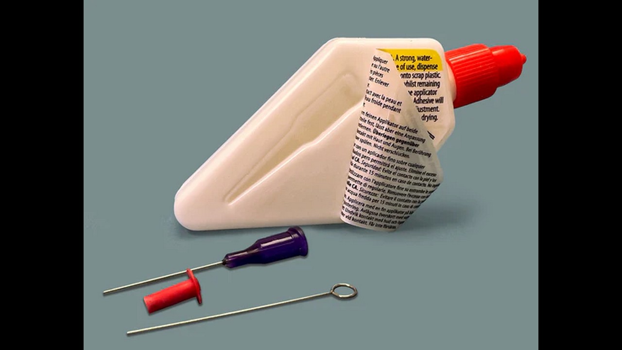

Once you are sure where the PE part has to go, instead of your regular cyanoacrylic glue or simply put, crazy glue or super glue, try to find a less aggressive glue. I use Deluxe Photo-Etch Glue which is water based and does not crease or fog the underlying plastic part and is easily cleaned up with water if necessary.
Some also suggest AMMO MiG Ultra Glue but in my own experience is not as good as the Deluxe product and takes far too long to dry.
So, here are the pictures of both suggested products I personally use:
