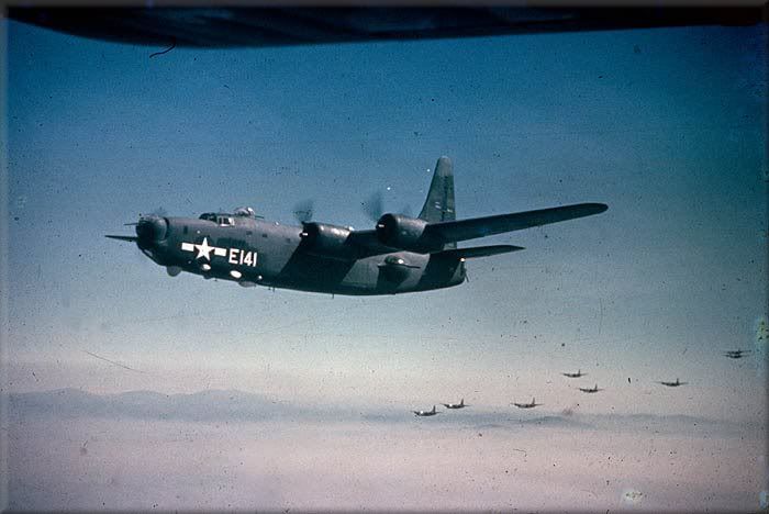

59876 was delivered from the factory in a dull sea blue overall color. Good for you…easy to do. The last mottle’d’ PB4Y-2 I have documented is 59873. Also as you will see, many PB4Y-2s were painted post-war to an overall gloss sea blue. And often with large graphics and Day-glo orange stripes. So that gives you a little to play with.
Here are a few photos to guide you to doing an accurate PB4Y-2 scheme. Note the Bu No paint job change…
But if you want a more interesting scheme, please let me know. I’ve got a few…
BTW…59873 had a red tipped tail in that last photo…
Also note that these Privateers were delivered with the complete Bu No stenciled on the nose. The Bomb group painted over that and added their own letter/number.
