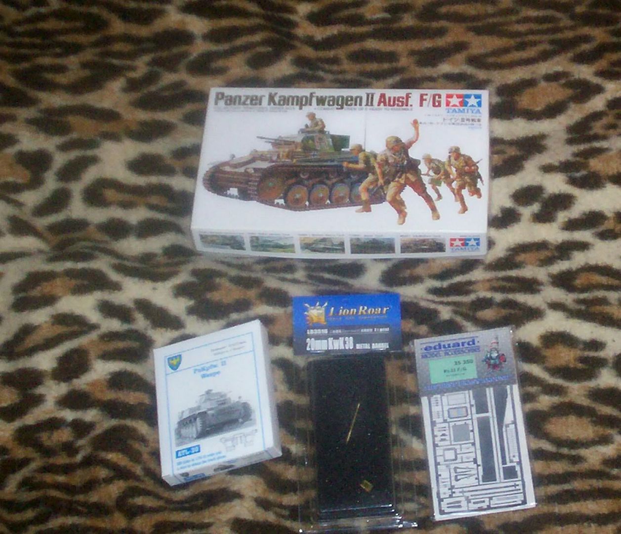

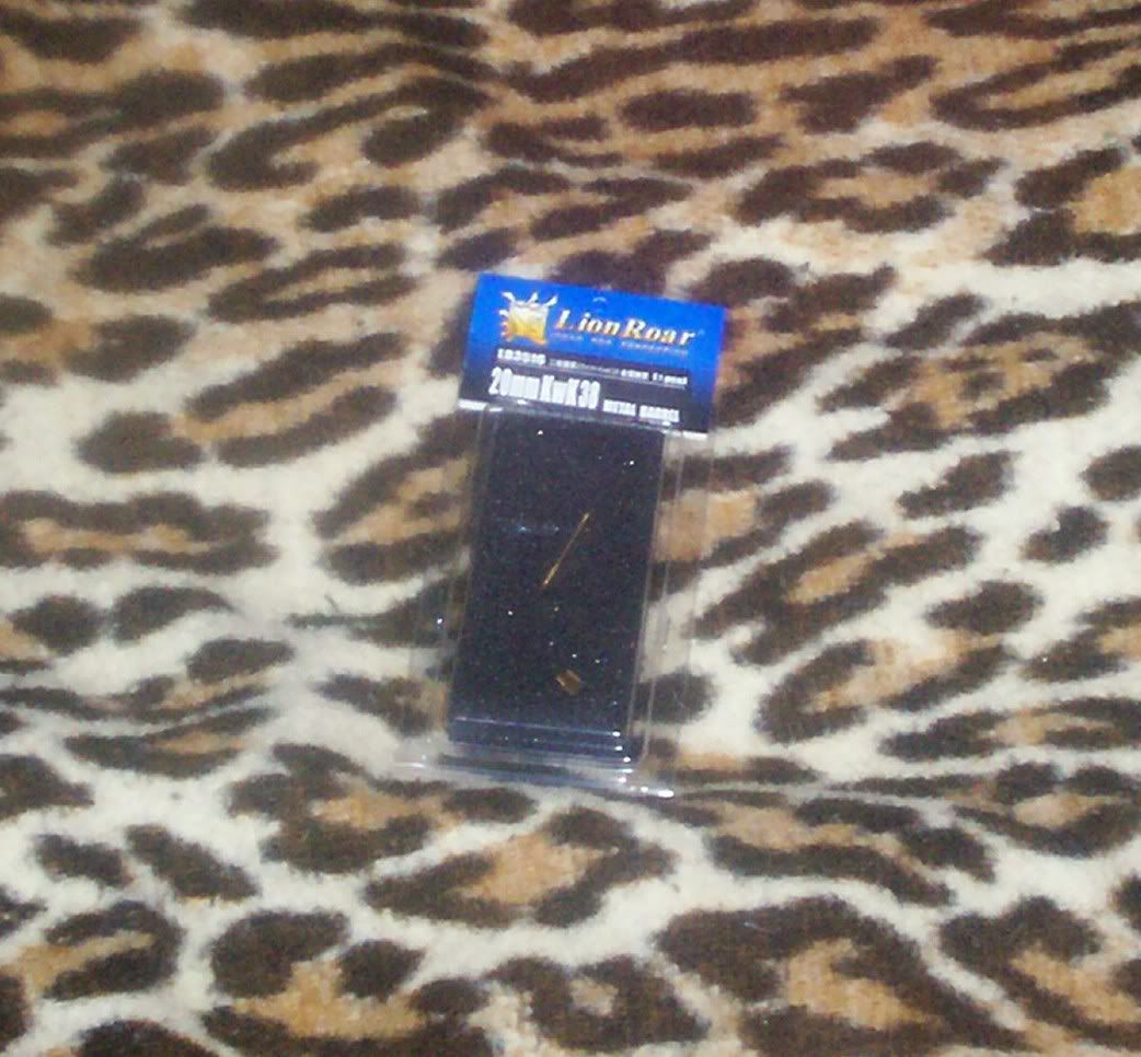

Ok I have the 1/35 Tamiya Panzer II Ausf.F/G and want to build it as the Kwk.38 armed Ausf.G. I have all the aftermarket parts I need for it. Friul tracks the Kwk 38 barrel from Lionroar and and Eduard PE set for the Ausf.F and Ausf.G.
So do I just glue the barrel to the front of the mantlet or do I drill out the mantlet and widen out the rear to install it in the back?

Tamiya chumped this one, and Eduard copied the error. Tamiya thought the only difference between a Panzer II Ausf F and G was the turret-mounted storage bin. In reality, the Ausf F and Ausf G, (more properly known as G1, G3, and G4, (no G2?) and were built as prototypes only) are completely different vehicles, with very little in common. The Ausf G’s more closely resemble the Ausf L than the Ausf F. You can not build an Ausf G from this kit. Build it as a Ausf F, use the PE, but not the KwK 38.

Usually these types of barrels require modification of the kit part in terms of removing part of the original barrel and/or drilling out a small hole for the mount pin at the base to insert into. You will have to check the dimensions of the replacement barrel (or follow instructions if provided, sometimes yes, sometimes no) to determine where the surgery/drilling needs to occur.
I’m with Kykeon on this one, I don’t think you can build a true G using the old Tamiya kit at least not if you want an accurate one.

The Ausf F used the 20mm Kwk 30 gun. Which differed greatly from the Kwk 38 also 20mm.
