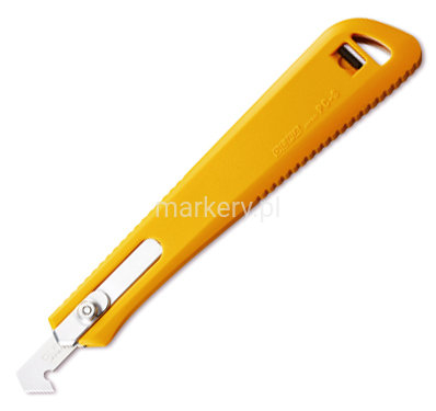

There’s a tip for that - go VERY lightly on your first scribe (meaning don’t use too much force pushing the scriber into the plastic). Then follow with next light scribes (don’t push). This way you will minimize slipping.
My favourite tool for scribing is an ELFA plastic cutter:
I hope this helps, good luck with your projects and have a nice day!
Paweł

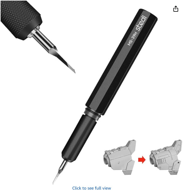

I really also like the photo-etch Tamiya craft saw blades. They fit in your #11 hobby knife handle, come in a few widths, and are easy to control.
I’ll often rough out a line with the 0.1mm saw, and then follow it with one another tool to clean it up, like these chisels.
These are useful for all kinds of sculpting jobs, but also make perfectly square-bottomed grooves when used as scrapers. So far, the 0.2mm has been the most versatile for panel lines, but the 1.5 and 2mm blades are great for carving. I like the brand Stedi:
Stedi Model Scriber,Tungsten steel Blades 0.2 mm,for Modeling
Lastly, you need the right straight-edge tape to guide whatever tool you have. The classic type is Dymo label tape, and it works great on flat surfaces, but is too stiff for curves like fuselages. I have some hobby specific scribing tape made by Stedi that works good, at that same Amazon link above.

I use the Stedi scribing tool. Really like the weight and control. Use it for figures, panel lines and just about anywhere a sharp defining line is needed.
