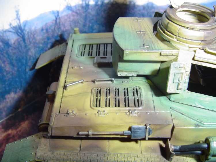

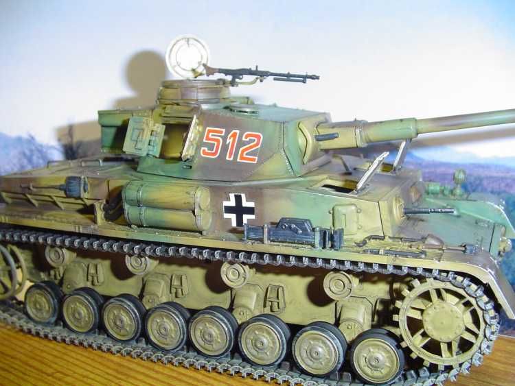

Here’s the technique on an OLD Academy Panzer from the 1970s that I did in 2002…
