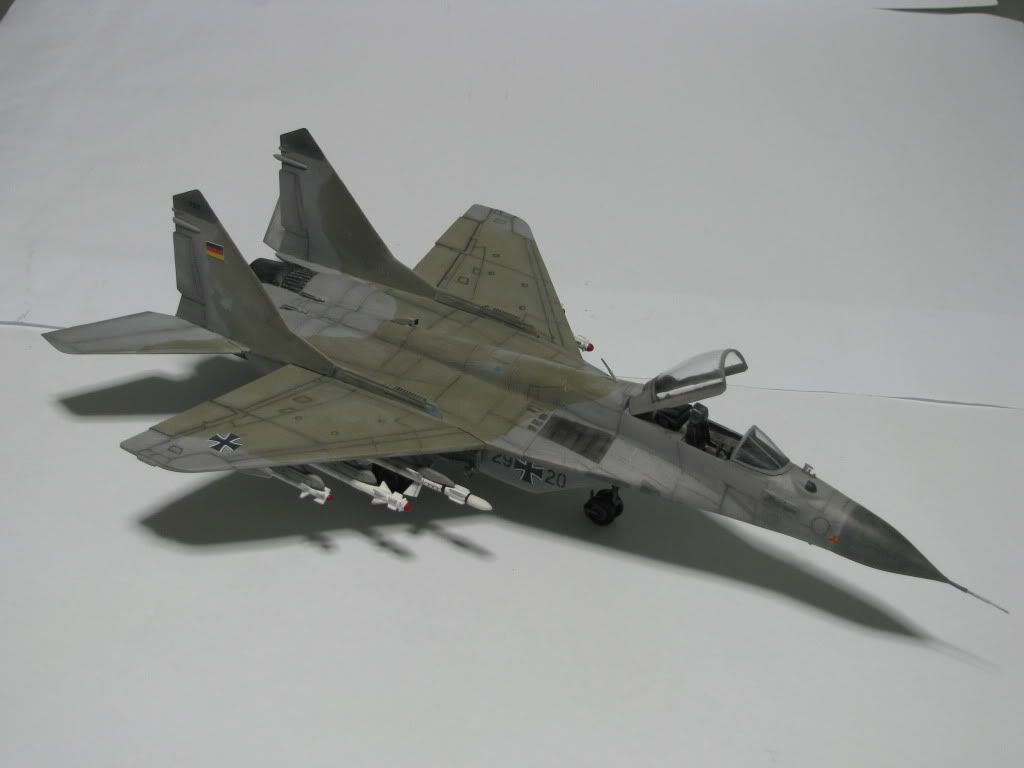

It is possible to survive modelling with justt paint brush. I been chunking out model for years without airbrush. The only spray i am using is the gunze flat finishing spray can.
As what many say, a good set of paint brush is important.
1- A decent set of paint brush with fine,medium and large broad brush will probably cost only $20 bucks with abt 5-7 different brushes.
2- Choosing yr paint and thinning it are important too. Acrylic is a good choice. I suggest going for Gunze acrylic if you able to get it. Thin yr paint properly. For me, even initial using of the paint has to be thin. Try to thin it until it almost behaves like water but make sure its not same as water .
Another suggestion for me is to choose light grey color for yr initial practice color. Its a general color for aircraft and warship . So I believe you shall not have problem selecting yr topic. Why light grey? Cos it can achieve even color easily and mask off lots of bad brushing technic. With just 1-2 layer, you can achieve uniform color easily.
  1. Yr brushing technic is very important. Before you brush, clean the surface then try to brush in one direction. The initial layer is usually fill with non uniform color which means all yr surface is not properly cover by the paint. This is normal but you must make sure the painted surface is even and not like a thick layer of paint on some parts but not others. They must be even. After 1st layer of paint brush. Let it dry a while before you apply the second or third until yr whole model achieve the same color. Sometimes, white color need up to 4 layers of brush painting to achieve uniform color.
  2. As for panel line shading, for paint brushing, I usually use post shade which means after all painting completes then I will do the shading. You need some medium to help you achieve that. Some carbon black powder is very handy. Apply on a medium size point brush and slowly stroke on the panel lines after a wash to achieve shading effect.
