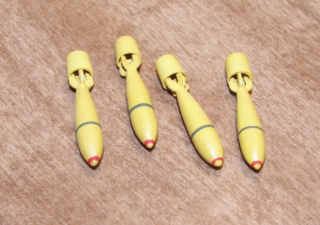

For difficult areas, like a ring around the nose, I’ve tried hand-painting. Paint the bomb, then coat it with a gloss overcoat. For this I used enamel/lacquer base paint and clearcoat. Then paint the ring with a brush, using water based acrylic paint. Use a damp tooth pick, and clean up the ring. It didn’t work overly well, but the bombs looked OK in the bomb bay. They are 1/72 scale, and a lot smaller in real life than they appear in the photo. That tends to minimize the crudity of the paintwork!
In the photo below, I used painted decal stock for the green stripe, and hand-painted the red nose ring.
