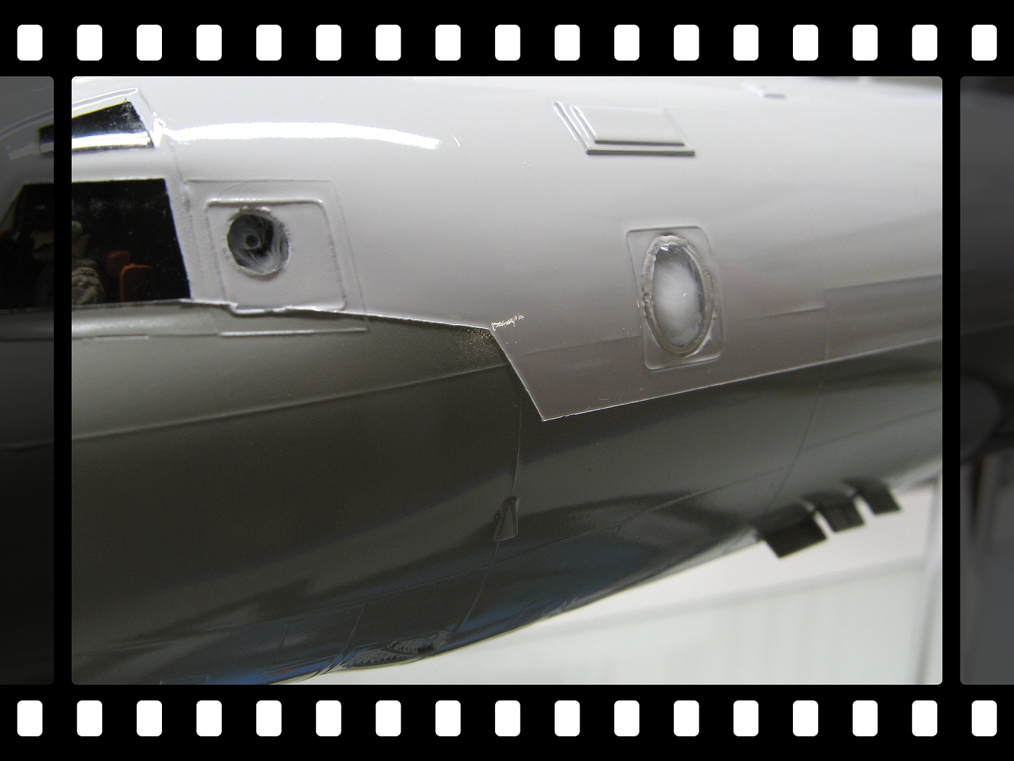

I had to do that with my EP-3E where the gray and white met. I sprayed a gloss coat over the ridge then carefully wet sanded the ridge with 800, constantly checking things as I went.
I do the same with my missiles and bombs by painting the stripes on as well. A good gloss coat usually fixes the “ridge” so, there’s no need to sand things.
Steve
Thanks Steve, appreciate the response and pic!
