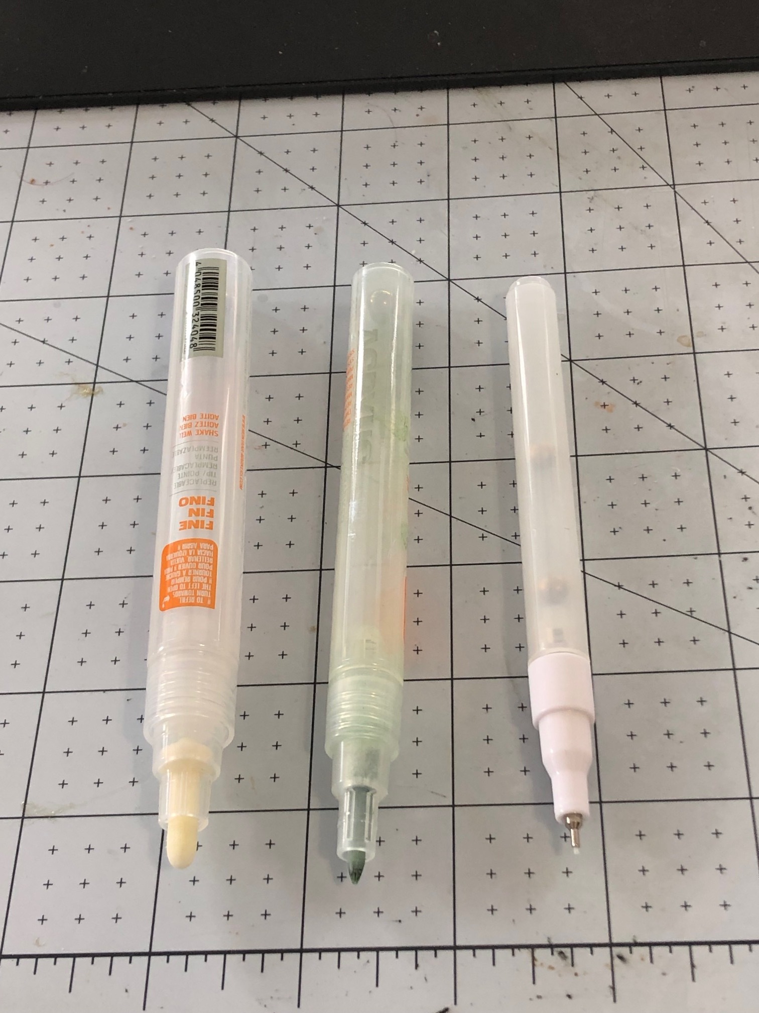

These are some of the paint markers I’ve used and they work nicely. They’re great for German, Italian, and Japanese spotted camouflage. I buy the “empty cans” and fill them with my own thinned Tamiya acrylic paint. The biggest one I have is 2mm but Montana makes them in 15 30 and 50mm widths. Painting a complete model with one makes me shudder and I’m generally pretty brave. I got mine on Amazon. They’re made in Japan but mine were sold by a Holland based company. Google Montana Cans or Montana Markers.
