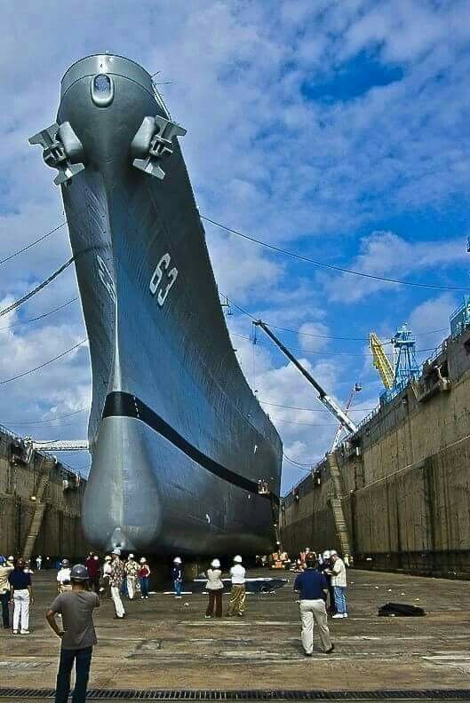

That listing looks pretty good, except for the underwater hull on US Navy ships. Some of the newer copperous oxide or organic tin ablative paints are of a different color than the standard hull red mix. As a diver, one of my postings was part of the Navy’s Waterborne Hull Cleaning Program. Back then I had a list of all Pac Fleet units and what they were painted with and when. Most of that doesn’t matter now, but be aware that some of the paints aren’t even red; they vary from the standard anti-foul hull red to a purplish tone, to even a blue.
The gray-blue bottom of MISSOURI is organic tin ablative paint.
P.S. As an observation, the boot topping on this vessel is only about four feet tall / wide.
What this all comes down to is do your homework before you decide on the color.
Which the bow numbers confirm (they are all 6" tall at 12" intervals).
Near as I can tell, all four of the Iowas have a different width of boot top. Missouri may be skinniest, and Whiskey may be widest.
