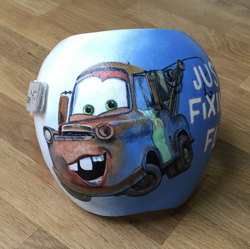

Hello all, I’m looking for some advice on enamel paints, I’ve never used them before but have been using acrylics for years and am sick of the durability issues. I don’t paint models as such, I paint cranial remodelling helmets - medical helmets for babies with flat head syndrome. A constant problem has been paint lifting off and sustaining damage- I’ve tried all sorts of primers paints and clear coats, I recently bought an airbrush and Vallejo air acrylics as I read they were more durable than others but the problem is still there. acrylic just won’t take the wear and tear the helmets go through over 3 months of treatment and often the paint work gets damaged on the first week or so of use and I end up having to repair.
So my question is, are enamel paints more durable? Will they stand up to knocks and scrapes? I’ve looked at humbrol enamels as the drying time for matts seems ok. I need to get the painting done and back to the owner within 36 hours at most so drying time is a factor.

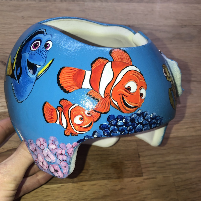

A few examples, if the links work!
