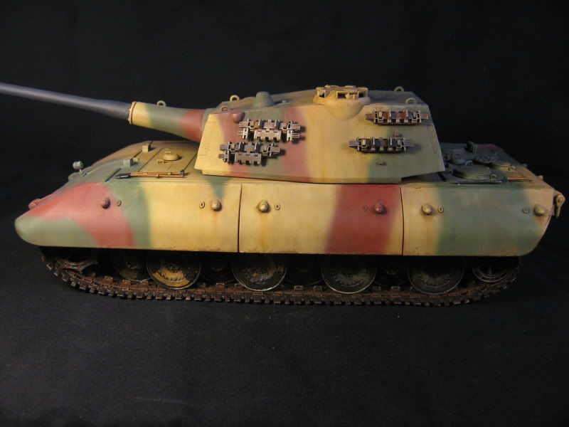

!http://i20.photobucket.com/albums/b232/gluetank/Decorated%20images/th_T1-4-copy.jpg
Just my two cents–again, I say stop worrying about “EXACT” color matches. Your weathering will change the shade anyway, and you might find that once you weather the tank it won’t look “correct”.
