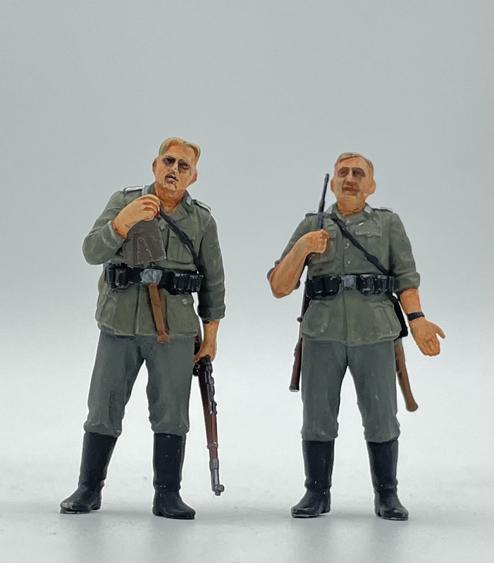

I tend to use shades of tan or sand color and then use a light brown wash for blond hair
These two are still a work in progress….![]()
