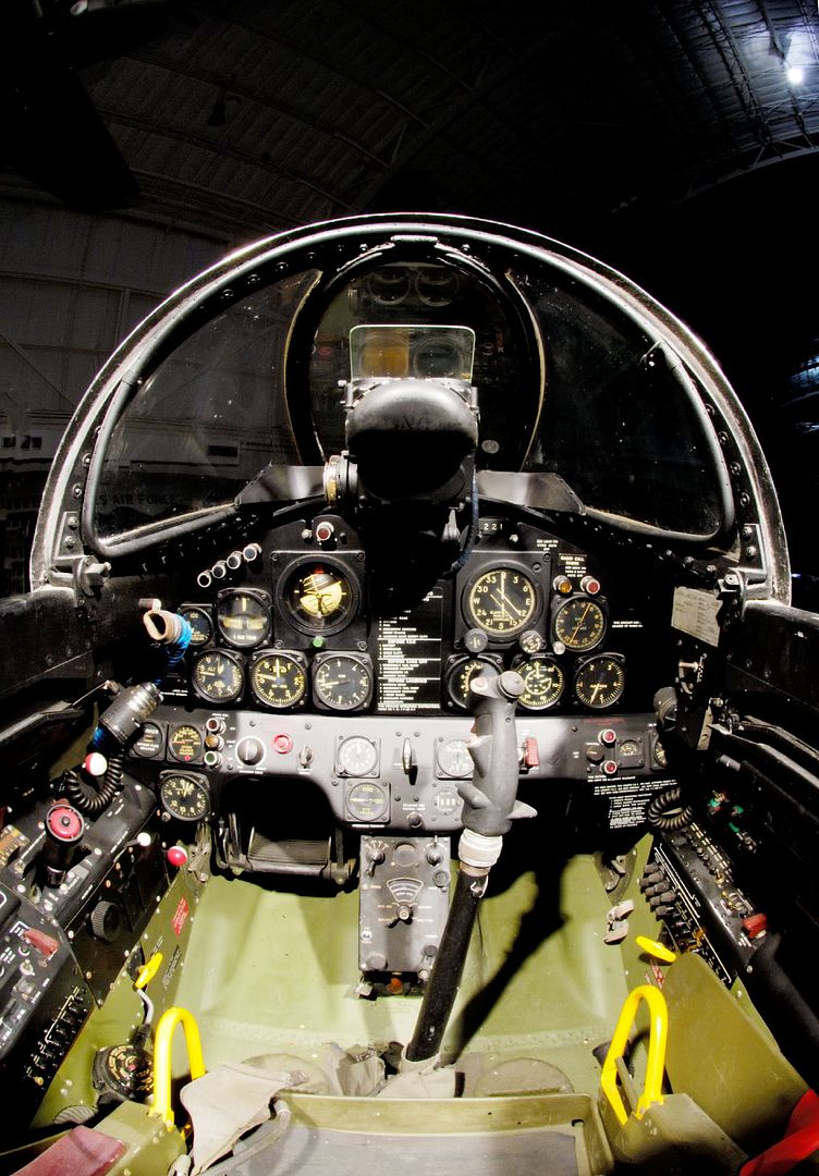

Cockpits… I’m working on finding photos of P-80s. I believe that they would have looked quite similar in coloration to the cockpit of the NMUSAF’s F-80C… predominantly black with green tub…
Image source: NMUSAF website

I downloaded the T.O. 1 for the P-80A, whch has extensive cockpit details (albeit in B&W) so I’ll compare the panel layout to that -C photo you kindly posted. If possible I’d prefer to modify the kit panel than scratch something new together, though the option also exists to create the panels as decals – at cost of their dimensional depth.
