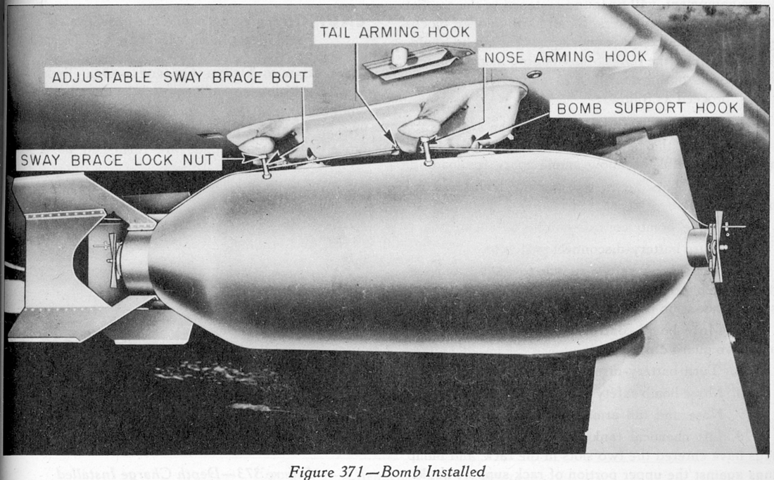

Question is…how exactly did the racks work? When the tanks/bombs were released, what about the sway braces? I imagine on something like a P-51 there’d be an interest in jettisoning them, too, for aerodynamic purposes.
The trouble I’m having is that I’ve found pictures of empty racks with the sway braces attached, and without. So I hope understanding the mechanism could help make sense of things…

Yeah, the sway braces would be there… They’re not attacthed to the bombs or tanks, they just get wrenched down tight agaist them…

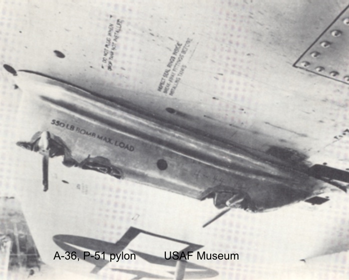

Doogs, I suspect but don’t know for sure that the wing internal parts for the drop tank pylon never changed, There may have been more than one style pylon and you already have photographic proof that the sway braces were removable. I have photos on my website (links below) that show the same pylon on A-36 through P-51, and I also have a photo of a very authentically restored D with the same pylon and sway braces. Also on my web site is a different pylon with a very large bomb installed, totally different sway braces.
