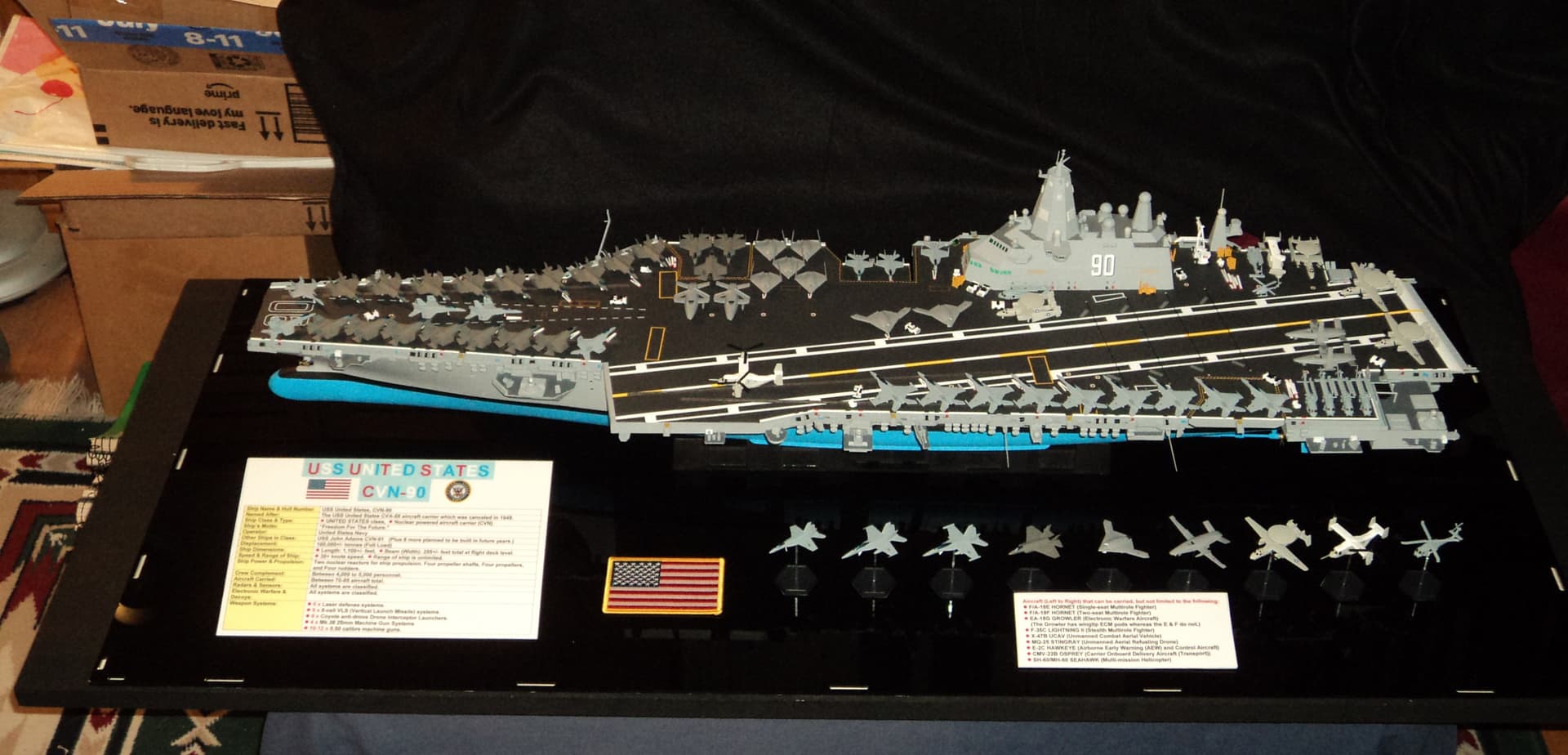

When I built my what if future USS United States aircraft carrier earlier this year, I did not spend a fortune on aftermarket items. Some stuff I already had at home as I was collecting and buying aftermarket items from years ago. So there was very little I needed to buy recently. The following list is the only aftermarket items I used on the carrier. Anything else was scratch built or kit bashed.
  1. Gold Medal Models photoetch hatches, fire hose racks, & life rings from Squadron.com website.
  2. All from 3D-Wild website: Bulbous bow at front of ship, White Tilly aircraft retrieval crane, SLQ-59 ECM (Electronic Countermeasures) systems, SMQ-11 Meteorological Receiver on a port side platform amidships, MQ-25 unmanned refueling aircraft.
  3. From Orange Hobby: F-35 & X-47 aircraft.
  4. From Trumpeter/TAMIYA: All other aircraft.
  5. From Veteran Models: Mk.38 25mm guns, Mk.36 SRBOC chaff/flare & Mk.53 NULKA decoy launchers, Two small RHIB boats on deck structure underneath the island superstructure on the starboard side, and Grey painted Sea Sparrow missiles on the weapon dollies on the starboard side of the island superstructure from the Mk.29 Sea Sparrow Launcher resin accessory set.
  6. From MRC/Trumpeter: All other flight deck vehicles and tractors.
  7. Main ship & flight deck decals from Starfighter-Decals website and/or leftover Gold Medal Models decals I had at home. (Main yellow and white flight deck landing lines were painted.)
  8. Very hard to see (Especially on the F-35’s), but all national insignia roundel decals on the aircraft are spares from at home.
  9. From L’Arsenal: 55 gal. blue painted barrels in the flight deck edge catwalks.
