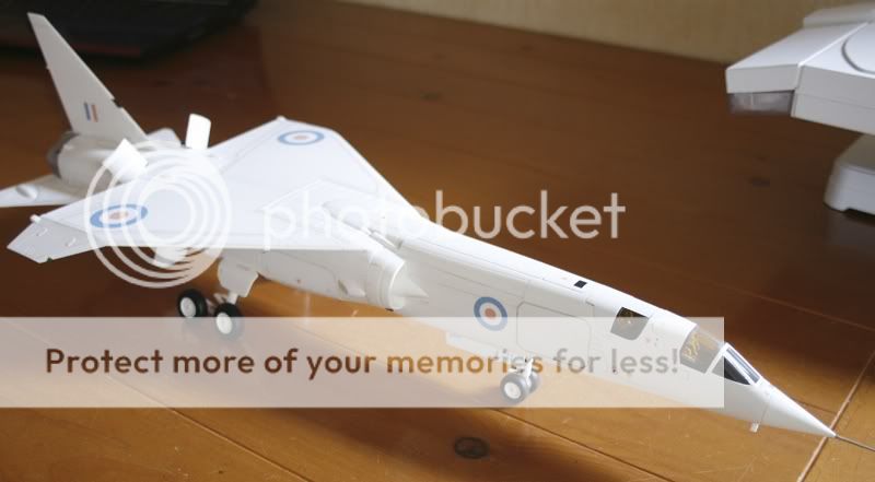

I finished this a while ago, but never got round to posting any pics. It’s the Airfix 1/48 TSR.2 done OOB with Tamiya Acrylics, Alclad, Future & a pencil.
I found the kit to be a pretty good likeness of the TSR.2, but although there is sufficient detail there is nothing fancy like a detailed opening radome or avionics bay. A bit of work & correction was required on the radome to remove a non existent line on it’s circumference, the front canopy > fuselage meet was a bit ill fitting, & the wing to body joint required a fair bit of material to be removed before everything would sit anywhere near flush. Other than that it all went together very well.
It’s finished to represent shiny clean XR220, which resides at RAF Cosford;

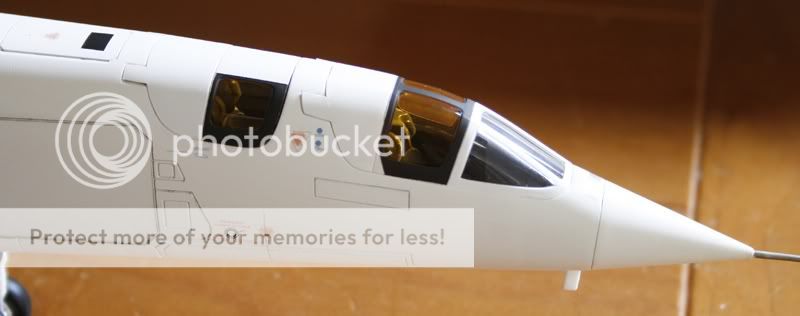

It was a bit of a struggle getting the tinting on the canopy looking right - I started with Tamiya clear yellow, but the colour looked far to much like the headlamps of a French car from the 70’s for my liking, so I tired Tamiya clear orange, which didn’t work either, so I ended up using a mixture of Future, clear orange & brown;

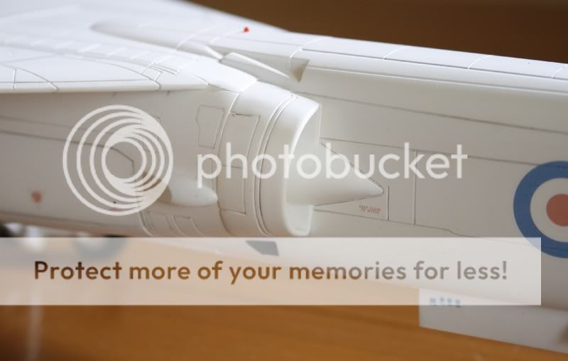

The camera pods just aft of the aux. intake doors shouldn’t really be there, they were done before I had decided which bird I was going to do…

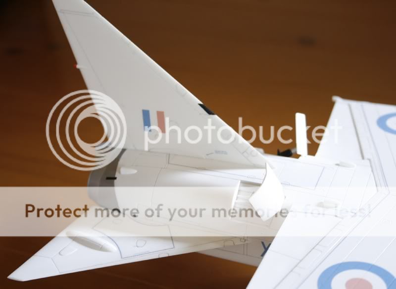

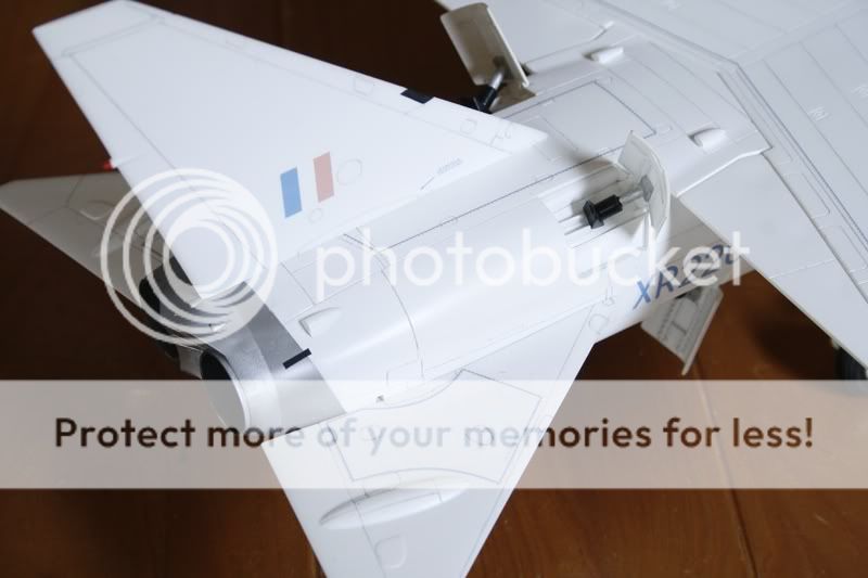

I used the tips from some leftover sidewinders for the spine & fin nav lights;
