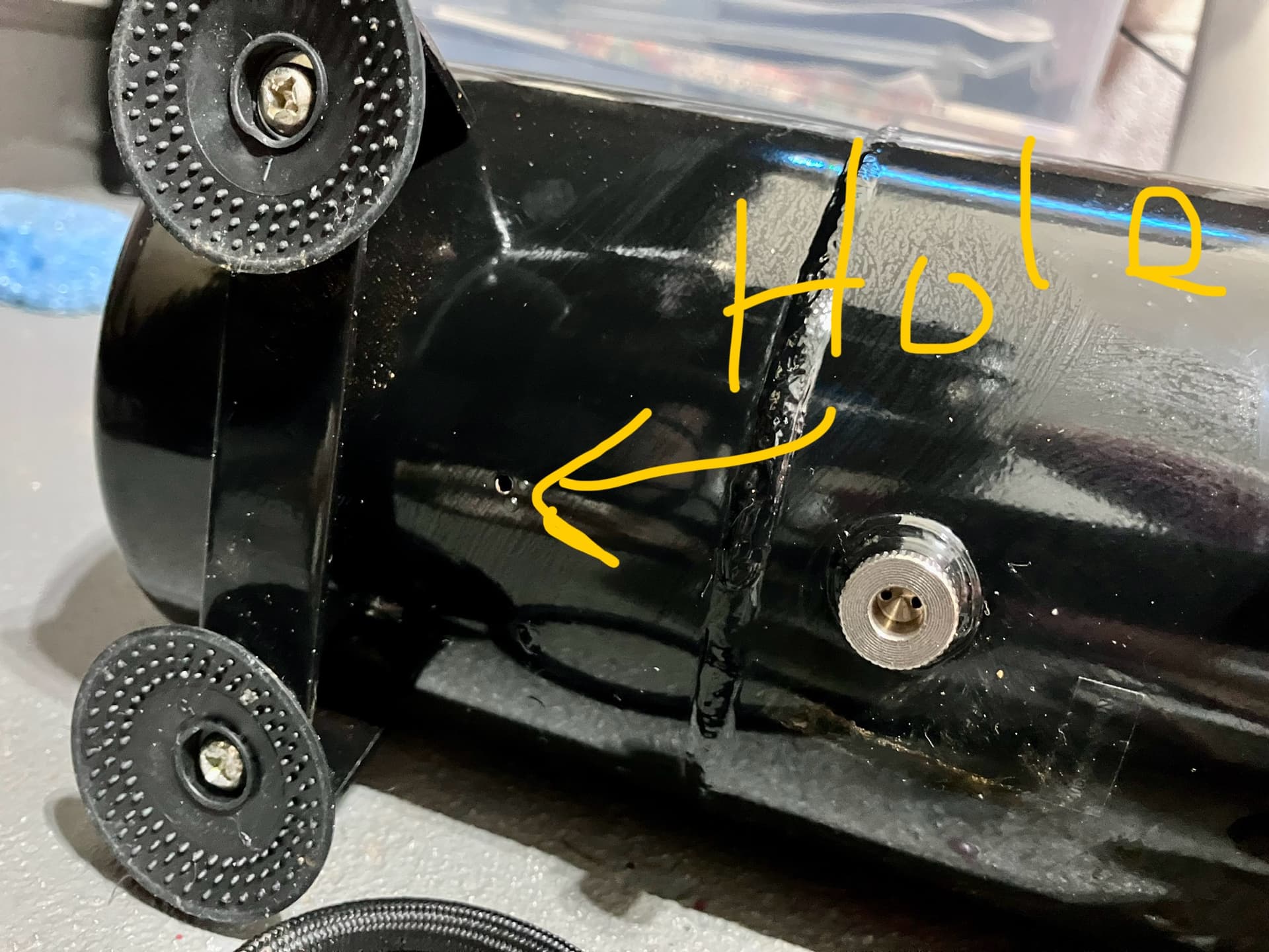

I was just enjoying a great session of priming my latest Gundam kit when my compressor (no-name ag-326) made a weird sound and started vomiting a brown fluid from a valve (?) in the bottom of the tank. I’ve cleaned it up with a rag so far but have no idea what just happened. Is my compressor toast?!? What do I do?!? This has never happened to me before.
UPDATE: Is this hole supposed to be here (see pic)
That brown fluid was rusty water.
As air expands it cools and causes the moisture trapped in it to condense. This creates water that can collect in the bottom of the tank. The silver piece to the right of the hole is drain valve to let that water out. Part of normal maintenance is to drain all the air out of the tank and then open that silver valve on the bottom to drain out any water that condensed inside the tank. If it isn’t, the water will sit on the bottom of thank and cause it to rust until it loses strength and holes form.
That hole is likely where the tank rusted through and where the brown rusty water came from. At this point the tank will not be able to hold pressure.
If you know someone who is a good welder they may be able to fill it, however. Given that you’ve already had one blow out it is likely another could happen at any time. You might be able to replace just the tank depending upon how it was built. Depends upon how comfortable you are with disassembling it. Easiest path may be to just replace the whole thing.

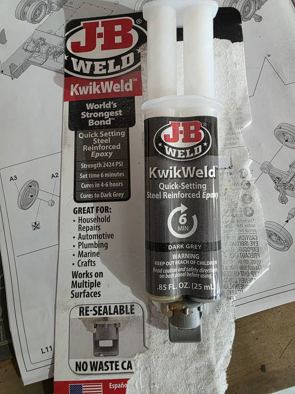

Mine had a blow out 2 1/2 years ago now,I patched it with this stuff.
It loosened up once and I had to redo it,but it’s still good. If your hole isnt too big, a repair shouid work,but you probably should put some money aside,but by all means,I would wait until it’s done,you never know how it might go.

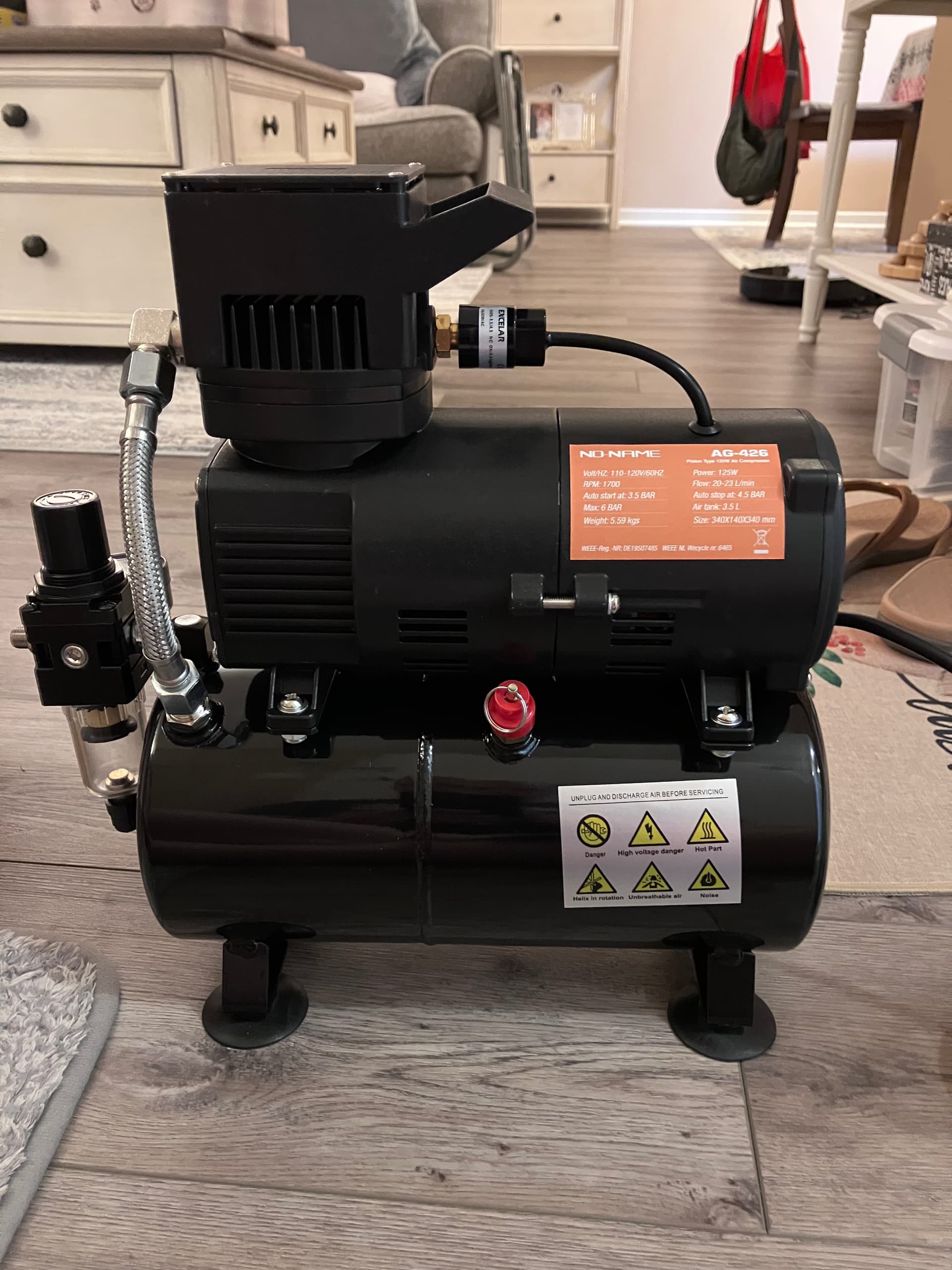

Ok. New compressor is great but I already have noticed some evidence of rust despite emptying out the tank every time I use it . Spotted some on the screw for the tank. What gives?!
Its still condensation on metal,the tank isnt top grade stainless steel,gonna be some rust along the way.I would say that properly draining it is going to slow down the rusting process though
Yes, happens to mine too, a Sparmax TC-620X, despite draining after every use. Guess we can only hope the rusting through gets slowed down.
