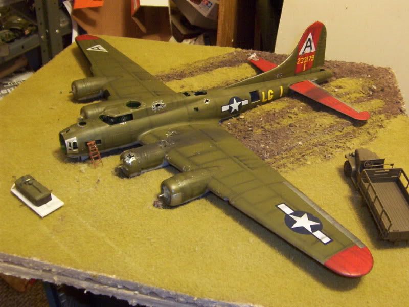

Think I used Testor’s Olive Green on this one…
