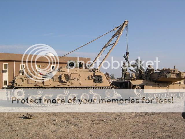

So I came across this photo the other day;
and well I happen to have a 1/35 sep from dragon, and I happen to have the resin engine kit from legen productions…so I naturally thought that a diorama like the one pictured above could be nice.

So far I have only been able to find 2 M88 kits, they are produced by AFV, one is a M88 1a, I think…and the other was a M88 G. however both have german markings. So which is depicted in the picture above, and what would be needed to convert the german M88 to an american one?

The one in the pic is an M88A1. AFV Club does 3 M88 models; a Vietnam M88, an M88A1, and an M88A1G German version (which was also reboxed by Revell). I believe the German version has all the parts of the normal M88A1, plus the German-specific parts. If you leave off all the German parts and get some US decals, you should be good. I think the German parts are a few different tools and a tool box on the boom, all on one specific, new sprue.
A note on the pic. It shows a USMC M1A1 and M88A1. If you have the M1A2 SEP kit; first the USMC doesn’t have any M1A2s, and most (pretty much all by now) Army M1A2 SEP units have the upgraded M88A2 Hercules to go with them. It is a more armored, heavier capacity M88 and the latest version. Real Model makes an M88A2 conversion set.

The Abrams kit I will be building is the SEP from Dragon, I have built it before for a client and really enjoyed it, so I picked one up or myself. I suppose if I am going to model one of the versions that comes in the kit I can find out if that tank unit uses M88A1’s or M88A2’s, that would probly be the best way to go about doing.
I will probably not buy the aftermarket resin uprgade kit, it is pretty expensive, and I was planning on rebuilding the “boom” anyways, the Legend Production Abrams motor is a pretty heavy bit of resin, I am afraid the kit parts would bend and sag w/ time, so I am probably going to build it out of brass tubing.
