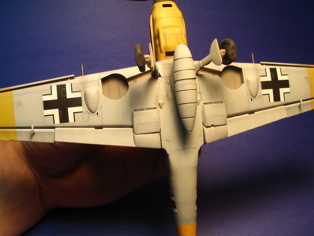

I thin black oil paint with paint thinner and used a small drop where a leak would originate, then blown it across the surface with a straw in the same direction that the wind would on the real deal. (I’m assuming you’re doing this on a aircraft.) The best part is that if you don’t like it, you can wipe it off with some thinner and start over as much as a day later.

I will put a drop of wash at a starting point and take a can of compressed air like used to blow off keyboards etc and with low pressure blow the streak back and let it take its own course.
EDIT. hannaman got his post in while I was typing. His pic is a great illustration of the blowing technique. Nicely done.

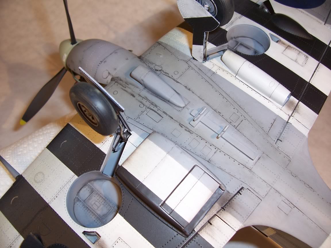

Here are a few pics of some oil stains I tokkk last weekend with this thread in mind…
The stains are not always straight back. An aircraft spends the majority f time sitting on the ground, even in war.

wing root and just behind engine cowl of P-47
