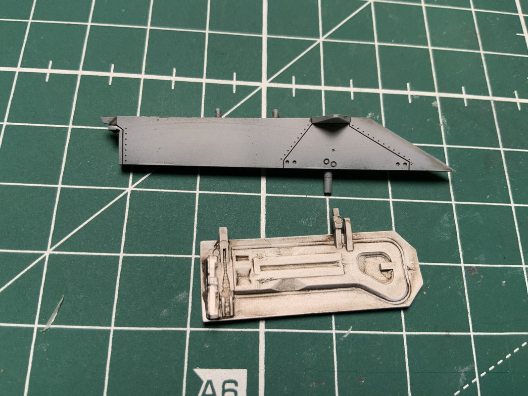

I like Flory washes too. I noticed on a gloss coat it’s easier to remove and will stay in panel lines. If you want an overall dirty finish apply over a matte coat.
I don’t use Future much anymore, but when I did it shot just fine with no thinning and at the same pressures as Tamiya.
The pylon is over a gloss coat and when removed it’s clean and stayed in lines. The interior gear door is over flat and looks dirty. Both using Flory dark dirt.
