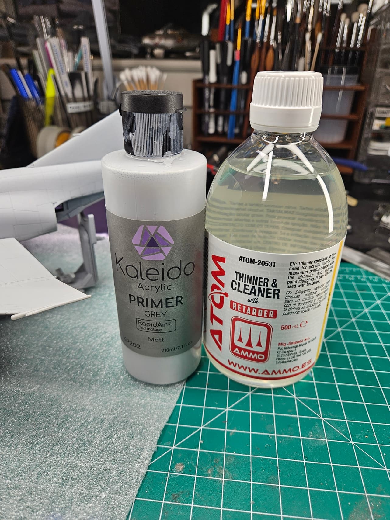

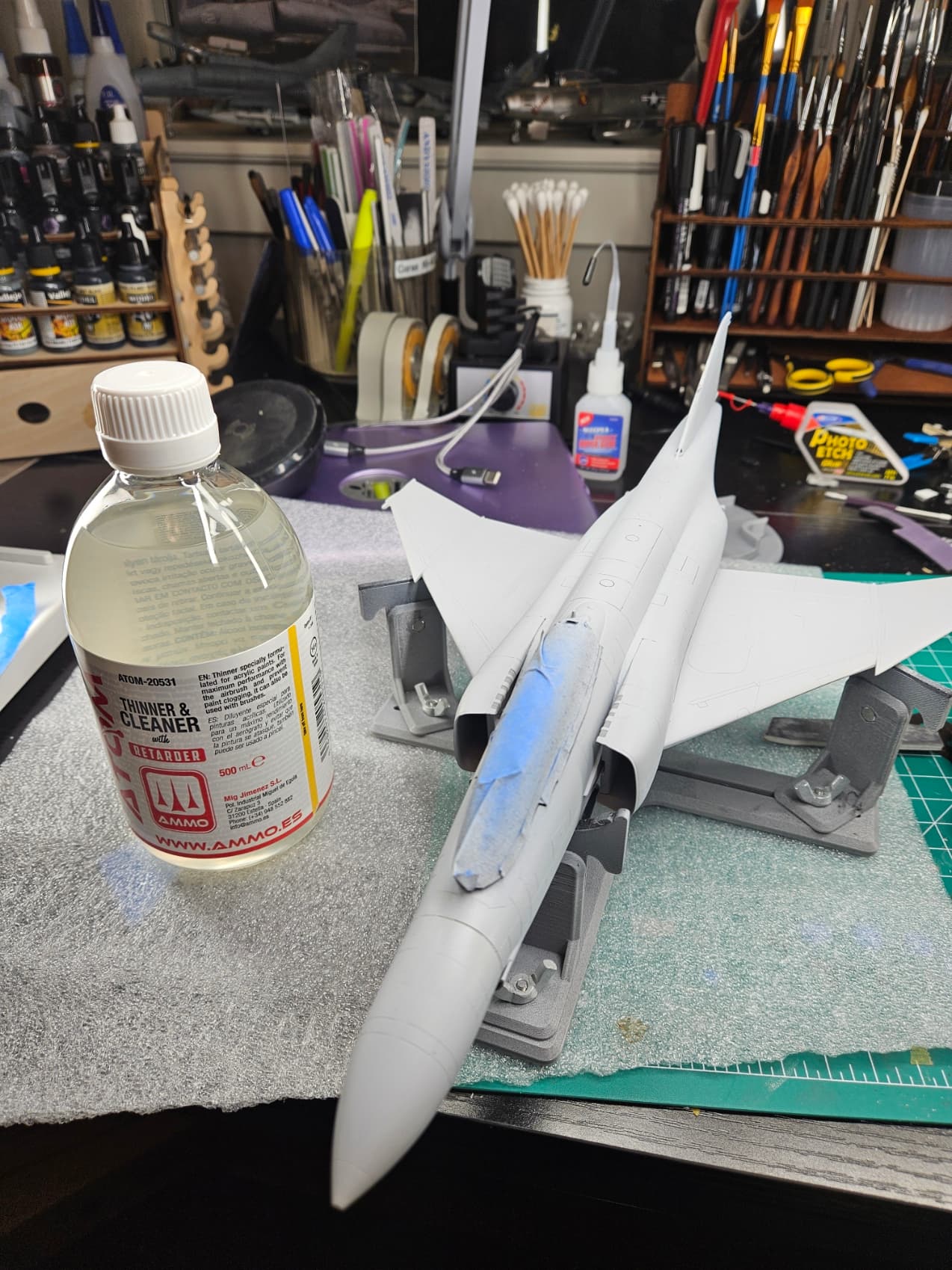

I ordered a bottle of his favorite product, Atom Thinner/cleaner with retarder and tonight I tested it. He was right! I painted for 10 min straight without cleaning my tip at all! In fact, I refilled the paint cup 4 times and still never had the issue. Not only that, but it was also the smoothest I’ve ever had grey primer go down, ever!
I tried different ratios and settled on about 30/70 for primer though he says use 2 drops paint and 10 drops thinner, which seems really thin to me. That was for a game air paint, so you will want to test for yourselves. I’ll probably try his ratio when painting with colors rather than primer, though Atom says 30% thinner is good.

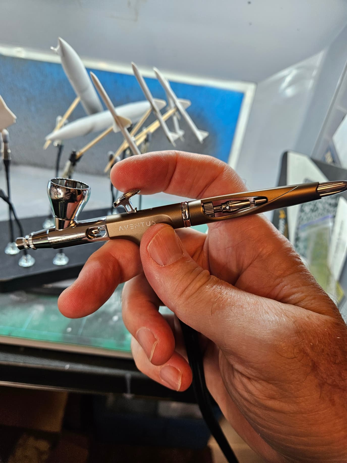

I also used my brand new Gaaleria Aventus airbrush which I can say is the best I’ve used so far (I have been through several). I can add more info on this airbrush if anyone is interested.

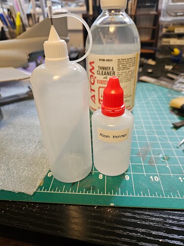

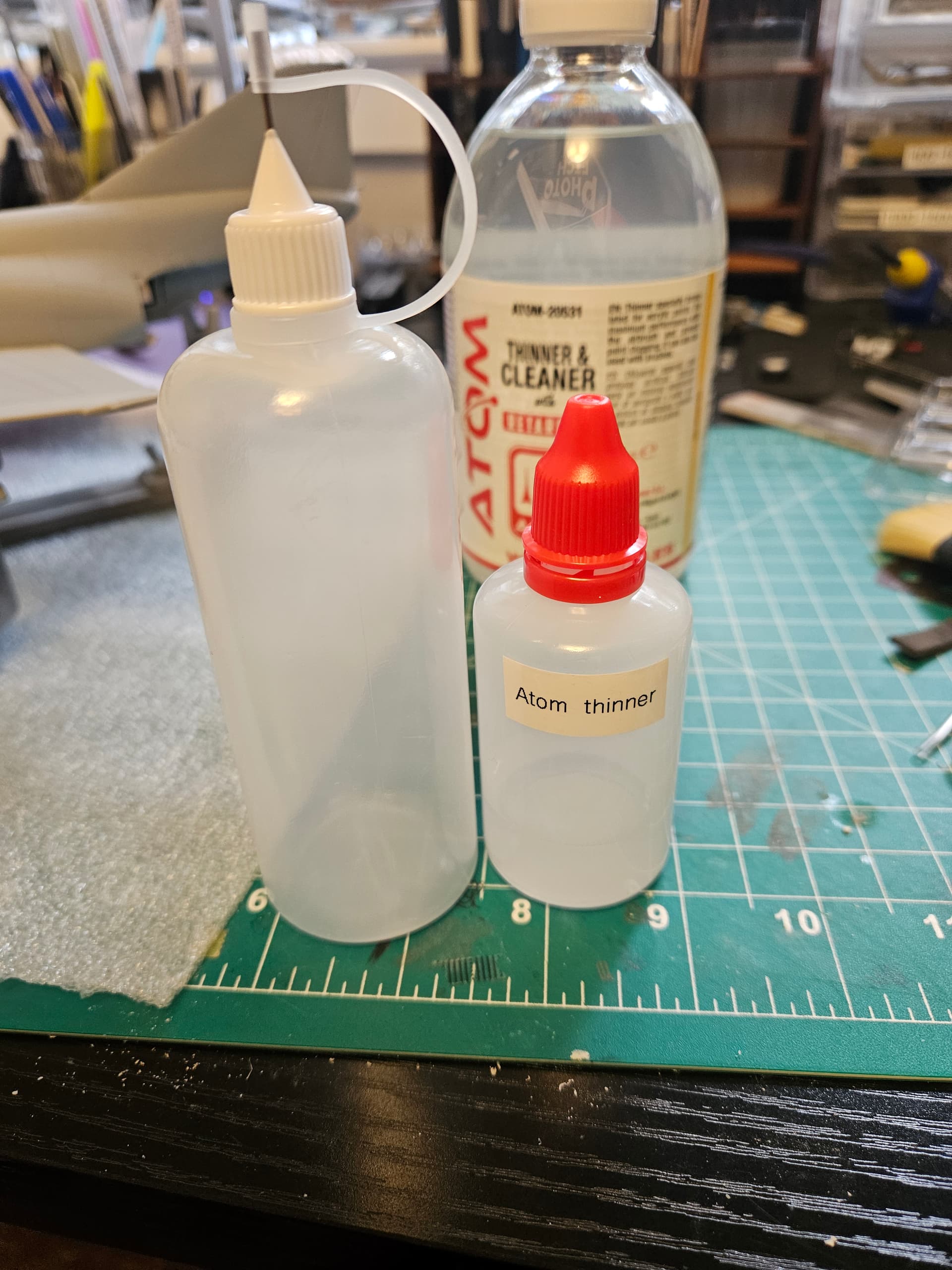

My one complaint is the bottle doesn’t have a drip top so you have to transfer it to another smaller bottle to control the flow. That seemed to be an oversite on Atom’s part, especially for something that costs north of $20 for the large, 500ml bottle. The 60ml bottle is only about $5.
