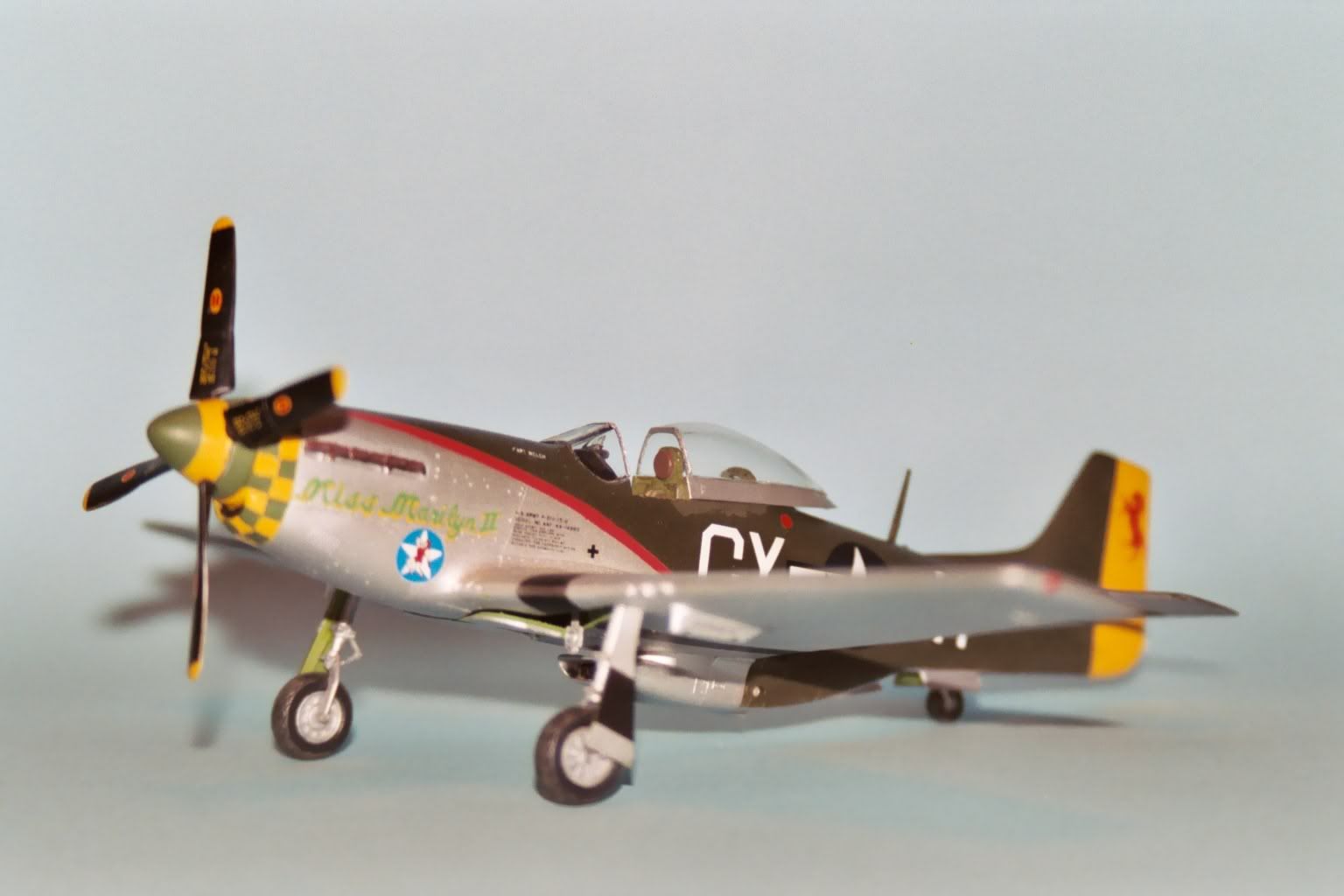

Having recently returned to scale modeling, I see there are a number of ways to achieve a NMF. I think I want to go with Alclad II, or maybe SnJ. Swanny’s how-to on Alclad sure makes it seem like the way to go. Any recommendations/opinions?
This is for the RM P-51D I’m working on. Will be in Miss Marilyn II scheme. Also, the instructions list the green portion as “Medium Green 42”. I saw that testors has a medium green with a FS # (which I forgot), are they the same thing?
