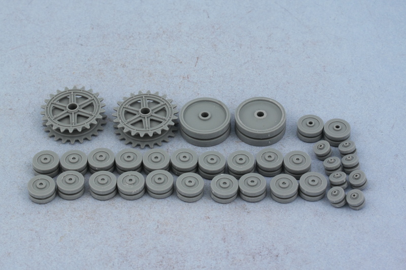

Got this one off and rolling with the usual hurdle coming first in the form of the road wheels. The Germans were suckers for lots of wheels and the Neubau doesn’t disappoint in that area. Beginning with Step 1, I cleaned up the mold seams on each of the wheel halves with a sanding stick and assembled the pairs. 11 main wheels per side plus 1 idler pair plus 4 return rollers made for no less than 32 wheels per side or 64 in total. The sprockets were also assembled at this point to go with everything else.

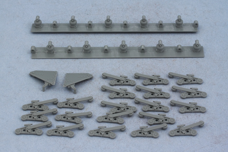

Those wheels will need to be painted prior to installation into the suspension due to the way the suspension is designed which is what is addressed in Step 2. The vast majority of parts in the kit are devoted to the suspension (and tracks) due to the vehicle’s design. This step calls for the construction of the wheel pairs and their installation into the long plates that go into the hull sponsons. I checked to see if it’s possible to add the plates without the wheel pairs installed and the design doesn’t allow for that, so the plates were left uninstalled until after the wheel pairs are painted and installed. I did assemble the bogey halves, the instructions contain an error in that the parts should be paired up with D11 going with D23 and D12 going with D24. I also added the mount halves for the large idler wheel that support the 11th wheel on either side.

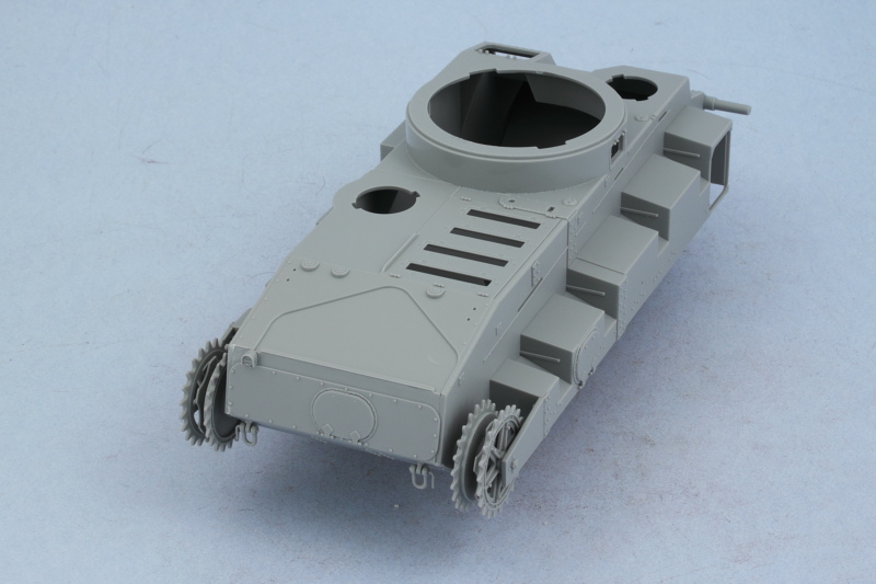

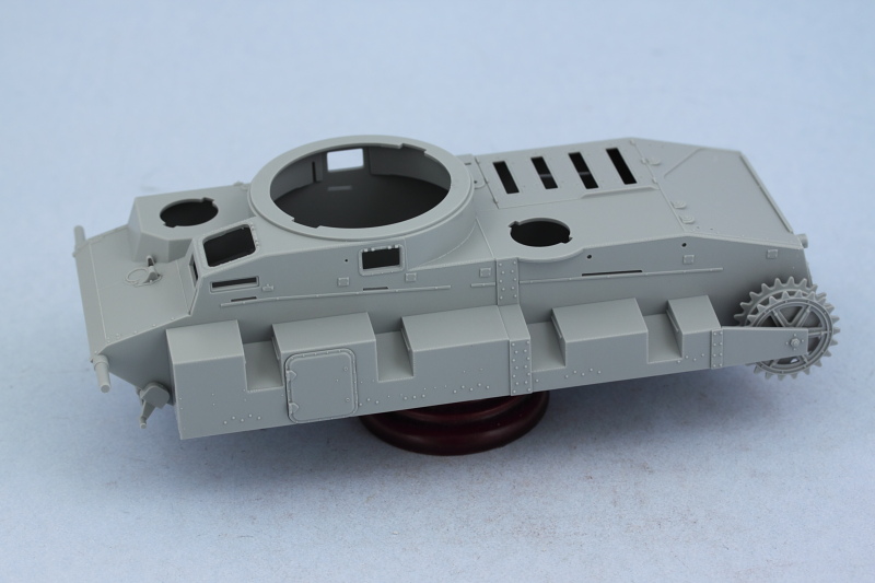

Step 2 also adds the sprockets and their capture plates as well as a couple of hatches for the sponson sides. Step 3 adds the hull belly plate to the large one-piece hull and also adds the rear plate and some other small details like the access hatch, brake light, and tow points.
