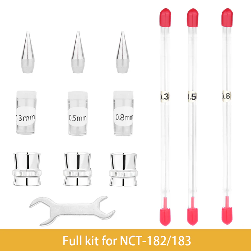

Bought a TiberTec compressor about 3 months ago. Hoped to move up from those battery powered 'nail/cake compressor. It came with and airbrush, no brad name and no manual. 3 needles. .2, .3 and ,5 with corresponding nozzles. I’m having no luck getting a consistent flow out of any combination. I’m using acrylics, Tamiya, AK and some squadron. Using flow improver ad thinning to manufacture’s spec with their thinner.
I can only describe the problem as an all or nothing. Either the brush is kicking out paint or suddenly stops. I also notice that these needles are forked at the end. Is this common?

No one answered about the forked point of the needles. Is that a defect or a feature?
A forked needle is bad. Needles should not be forked, they should have a point on them. Points are fragile, protect them. Everyone has a favorite airbrush, I recommend a Badger Patriot 105 airbrush with a .3 or .5 tip.You can get one from Amazon for around $90. The way to improve your skill is to practice practice practice.

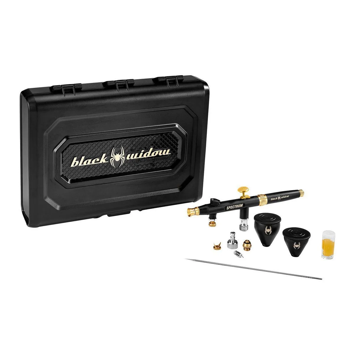

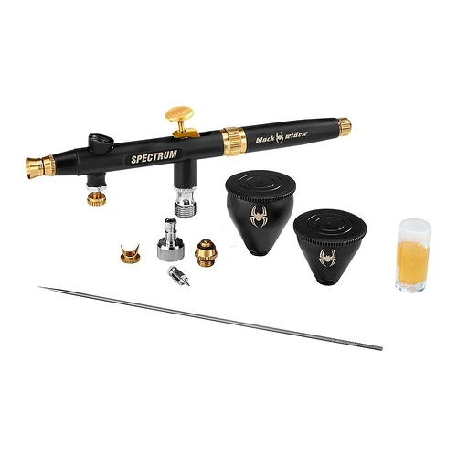

I have an Iwata HP-CH which I have used for years. Recently, I purchased a Spectrum “Black Widow” (Harbor Freight -$80). It has all the attributes of the Awata and is 50% less expensive.
I would highly recommend it.

I’ve been using/selling airbrushes for 25+ years and have never seen a ‘forked’ needle. Can you share a picture of the needle?
Tried to take a picture, but no go. Hard to see unless high magnification. They are from a Neoeco airbrush that I bought before he tariffs (13.00 USD)
As mentioned previously, needles should taper to a point.
This is the one I was referring to from the Harbor Freight store. It comes with the two size cups. a .02mm and a .03mm needles with nozzles. It compares favorably to my Awata HP-CH for half the price.

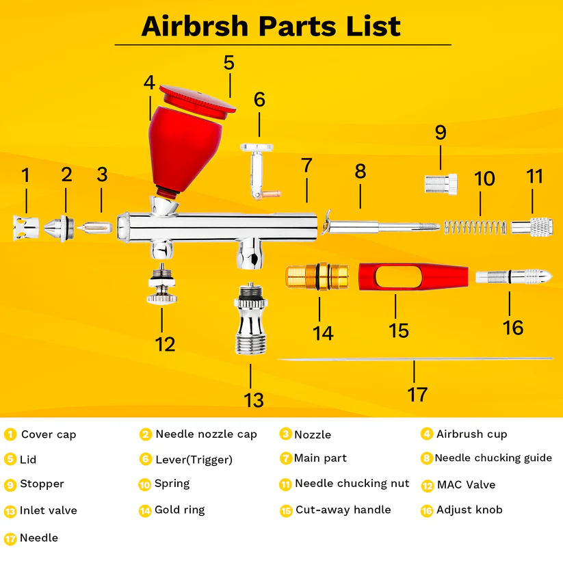

My $0.02 to convo, I picked up a no-name gravity feed dual action airbrush from NEOCO that works well. While not one of the big names it works well for what I need it to do, considering it was learning how to use an airbrush.
