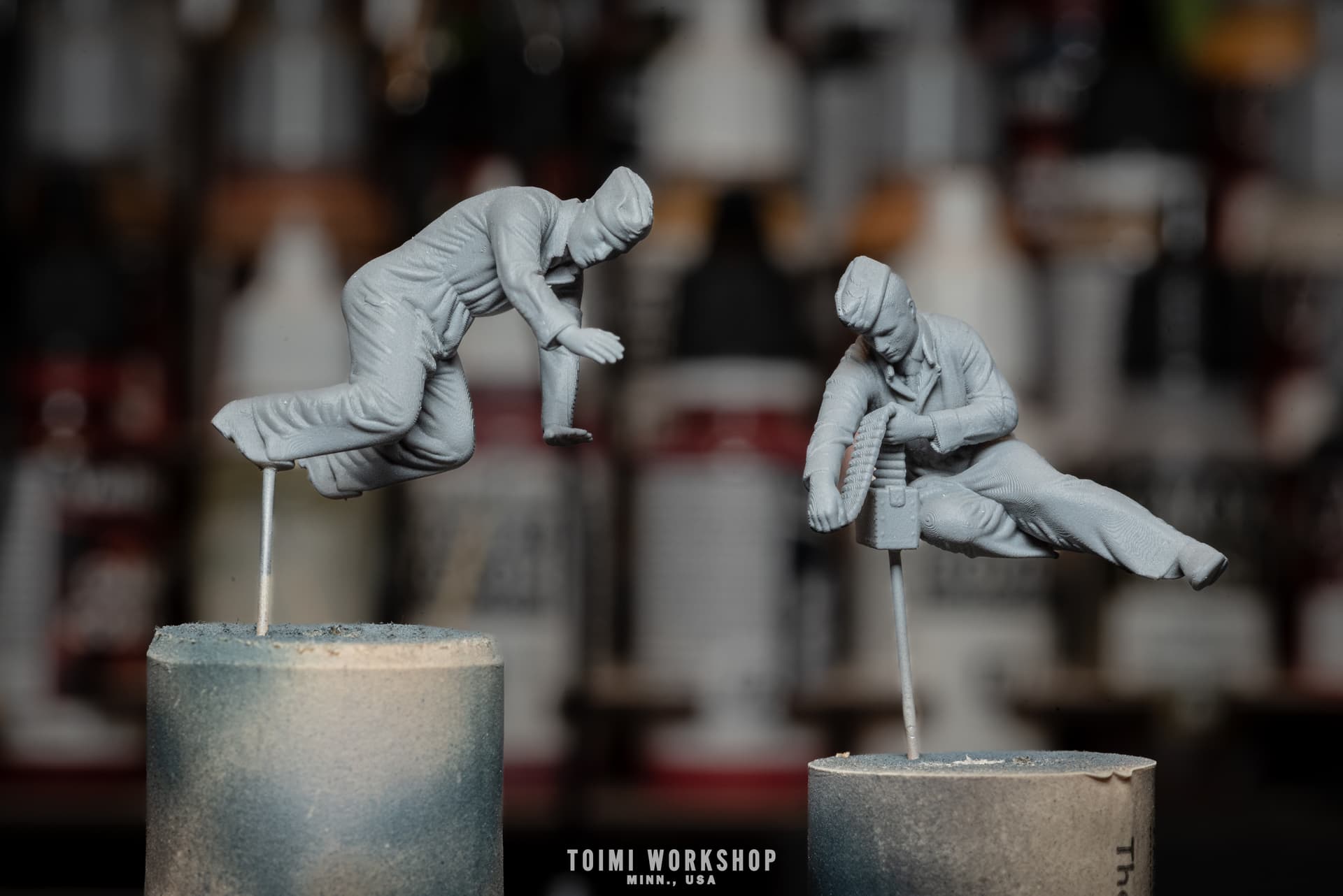

One thing I’ve done with really small parts is drill a tiny, shallow hole somewhere on the bottom where it won’t be seen, then push the point of a toothpick into it. You don’t need much of a hole at all—just enough for the toothpick to get a good grip.
It gives you a nice handle for painting, and when you’re done you just pull the toothpick out. No glue to break loose or clean up afterward. I’ve used that method before and it works really well.

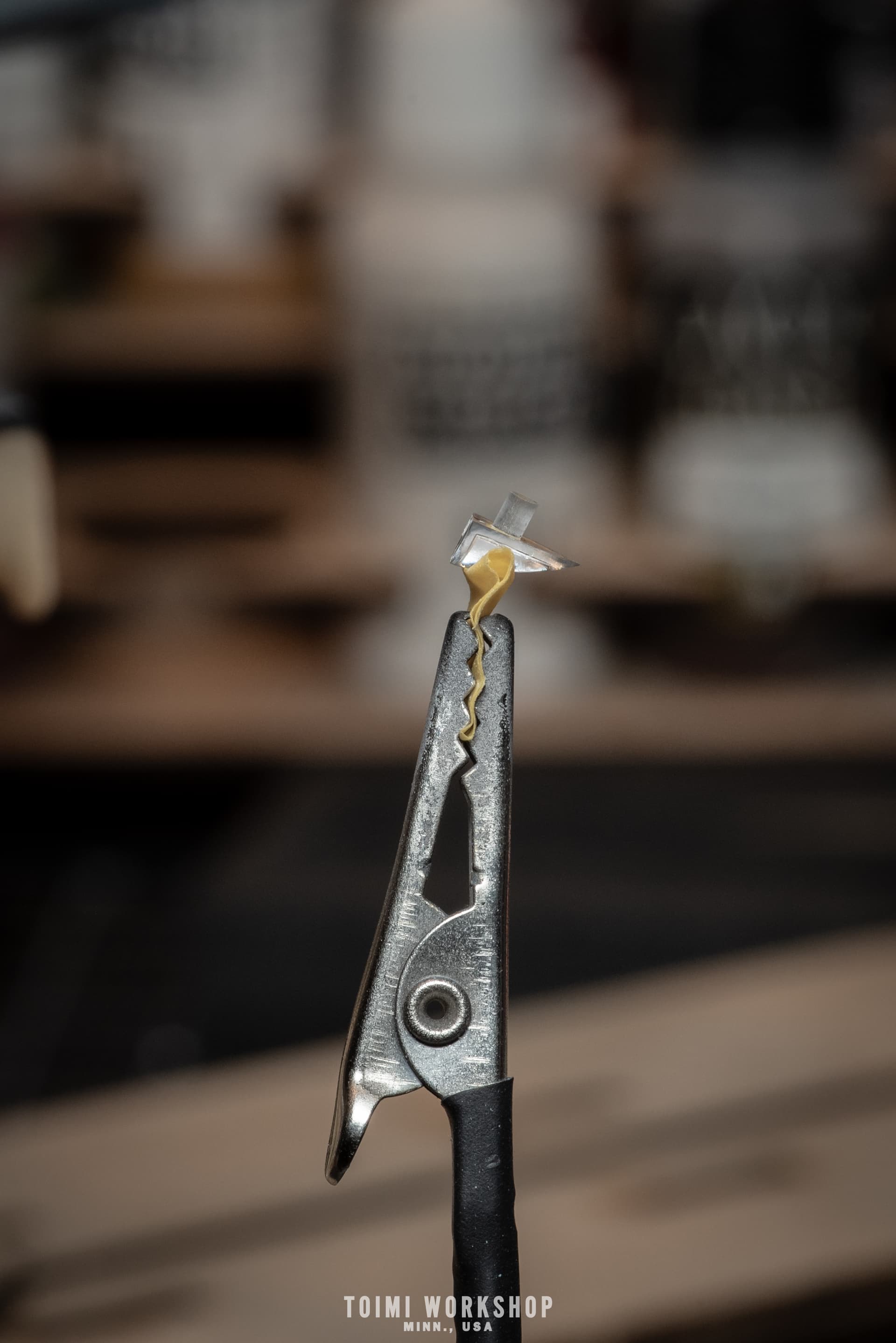

I have some of those alligator clips, which work well – especially if you can leave a bit of the sprue attached to the part.

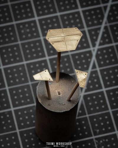

A wooden toothpick, cut and sanded flat on one end, superglued to a hidden area of the part. The sharp end of the toothpick can then be stuck into foam, cork, or whatever – I really like those synthetic wine corks.
For ultra-tiny or delicate parts, a small loop of masking tape held in the 'gator clip:

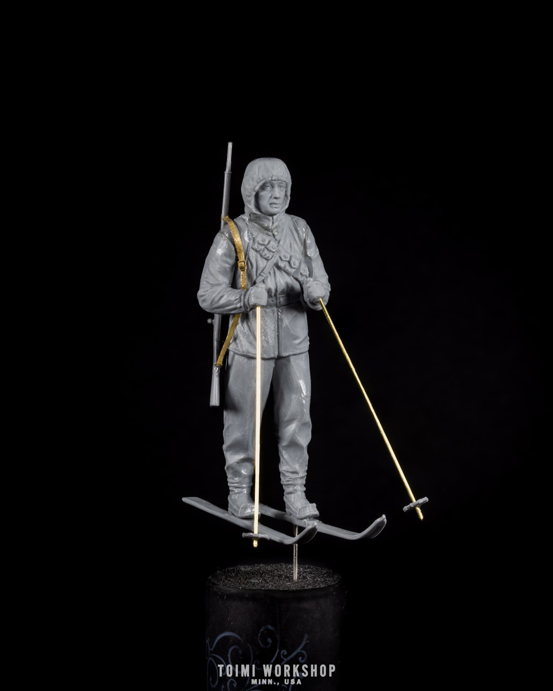

For really tricky parts, or stuff you need held more firmly, I’ll second the suggestion to drill a small hole in the bottom for a peg. I use push pins with the heads clipped off, and I have a drill bit that’s sized just right set aside just for this use. Drill a tiny hole in the bottom or another area of the part that will be hidden, and then you can just friction-fit the pin in place, or use a few molecules of superglue if needed.
The pins can then be stuck into a wine cork or a bit of foam or whatever kind of work holding tool you use. Even with the superglue, usually the pins will pop free when you’re ready to place the bit on your model. Or, leave the pin in place, use it to pin the part to your model, if possible.
