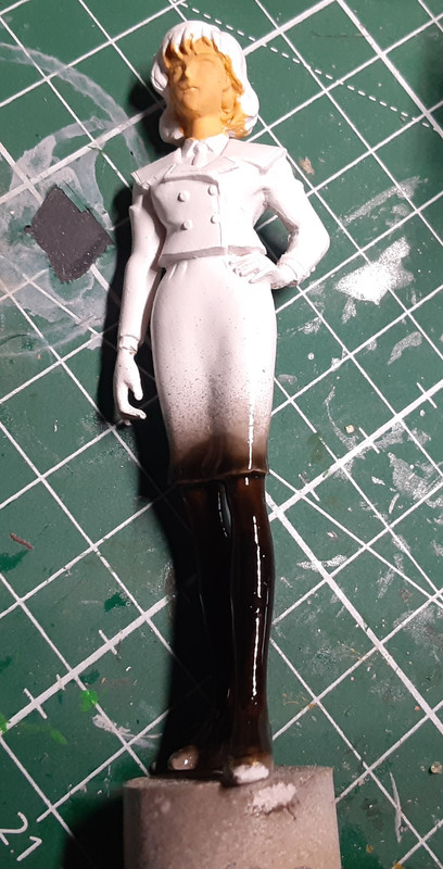

I’m working on a small resin Elvira figure and I’m trying to paint her stockings using a light mist of dark gray over a light flesh color. Primer is Tamiya Fine White, base coat is Tamiya Acrylic (flesh + white). For the stocking color, I’m using Tamiya semigloss black + a little flat white. I’m shooting it thinned with Mr Color leveling Thinner (2:1 ratio, paint:thinner) using a Pasche H1 at ~20 psi.
Here’s what I get:
https://www.dropbox.com/scl/fi/dbikqs2dpdjguwgbjk2to/2023-11-08-16.56.43.jpg?rlkey=0kvvqr328kjkpllcdxa934i89&dl=0
The gray is spattering (splattering?) making the mist pattern too coarse for the effect I want. I’ve tried adding more thinner, raising and lowering the pressure - no luck.
Any advice?
I use isopropyl alcohol for thinning Tamiya - but I’ve heard of folks using Mr Color as well. Take the airbrush apart and thoroughly clean and check for a bent tip.
What are you mixing your paint in? Are you mixing it right in the color cup, or are you mixing it in something else and pouring it in? I have often had unpredictable behavior with various paint/thinner mixtures if I did the mixing right there in the color cup. I solved that problem by doing my mixing in those little Dixie paper bathroom cups first, and then pouring the paint into the color cup. You can just crimp the rim of the cup to get a nice little pouring spout. I also found that, with some paint mixtures, I always got the best results by always spraying horizontally, instead of a downward angle. Spraying at a downward angle can also cause spattering sometimes, depending on the paint mixture. I’m with Keavdog on what to thin Tamiya acrylics with. I use 99% isopropyl alcohol to thin mine and get excellent atomization. My airbrush is a Paasche H.
Thanks. It’s a brand new tip/needle set, but I’ll put it under the magnifier to be sure.
Thanks. I don’t use a color cup. I prefer using a siphon bottle, which is where I mix the paint. I’ll try again shooting horizontally and make sure the paint is well-mixed.

Hi Greysteele, I also use IPA to thin Tamiya acrylics. I tend to use 1:1 ratio. I use very light coats and try to spray as close as possible without pooling or spidering. Too far and the paint dries before it reaches the surface, causing a grainy effect. I mix a batch in a separate cup, then spray a lot of practice coats on scrap pieces to get the right combination of pressure, distance, speed of passes, etc. Also need to keep the airbrush clean. I clean the cup and needle after every session. I take the nozzle apart and clean that area every ten sessions or so.

You want to go 1/1 paint to thinner and using the bottles you should set pressure over 20 psi flowing. Set your gauge around 22-23 psi. Push the trigger and make sure as the air flows it doesn’t drop under 20psi. With the metal side cup you can generally use a bit less pressure. I’ll use Tamiya acrylic thinned with MLT or alcohol and side cup with pressure set to 20 or even 18 psi.
The paint may seem thin but it will spray and cover fine. And if this is more a wash over another color you probably need to go even thinner. If having to do that I personally would switch to alcohol as the thinner or not use leveling thinner but the regular lacquer thinner. You want a quicker dry in that case than MLT gives.

I am not an expert, but that sputtering looks like one of two things…
your paint is too thick. OR Your air pressure is not high enough.
If you are shooting above 15psi, I would start by thinning your paint out a bit more.
I was getting spattering and noticed bubbling in my top feed paint cup. The problem was a bad seal of the needle nozzle to the AB body. Adding some “Chapstick” to the nozzle threads solved the spattering and bubbling issue.
