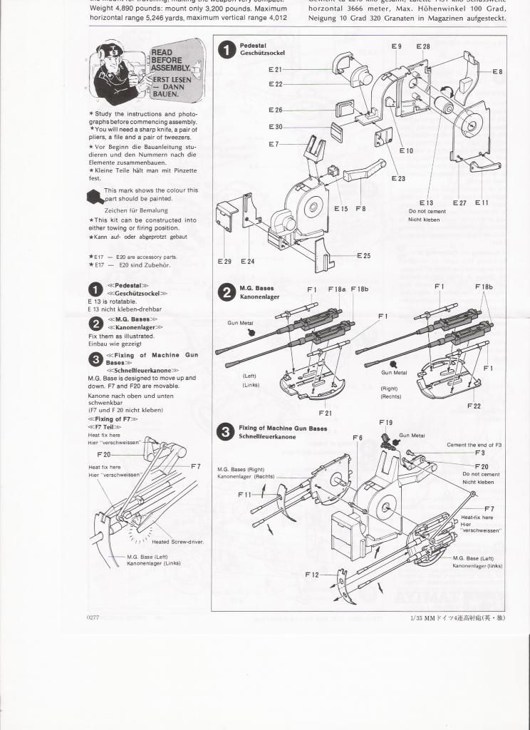

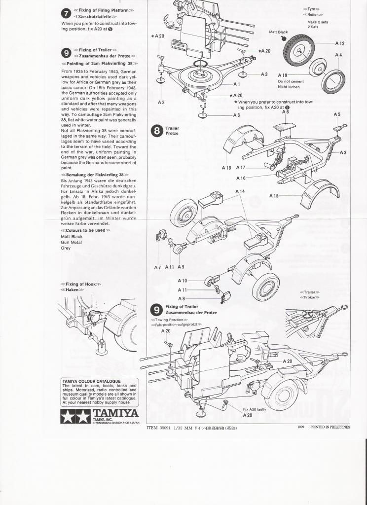

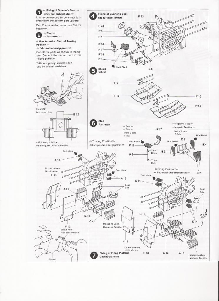

I scanned the English instructions, hope it helps [:)].
On the first page, note that the connecting arm for the gunsight is articulated so it moves with the guns when elevated (see inset at the bottom left of the first page) The instructions tell you to carefully melt the ends of the mounting pins using the old “hot screwdriver” method.
This image at the link that I posted has the color call outs off of the box rear
Thanks all for the help. Mine somehow only comes with Japanese. That’s the first time I’ve seen instruction on melting a part. Won’t a glue do the job as well?
the hot melt allows the part to pivot whereas glue would give you a permanent bond and immovable. Just heat the rod portion slightly to “mushroom” the end to keep the parts from separating.
