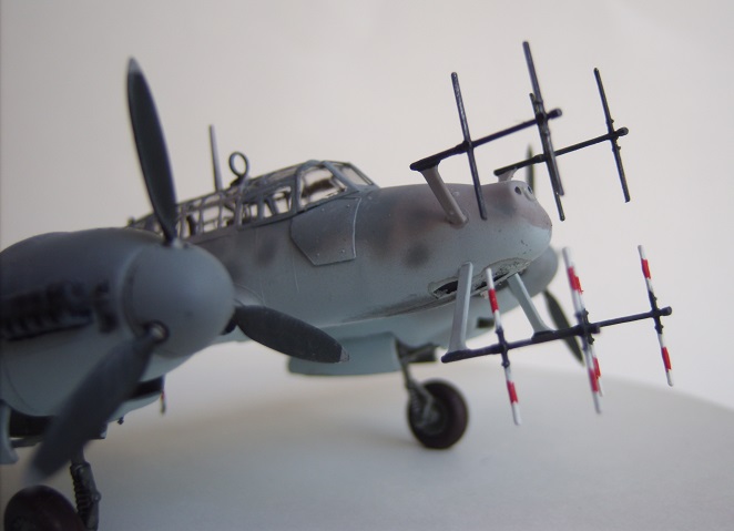

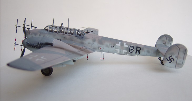

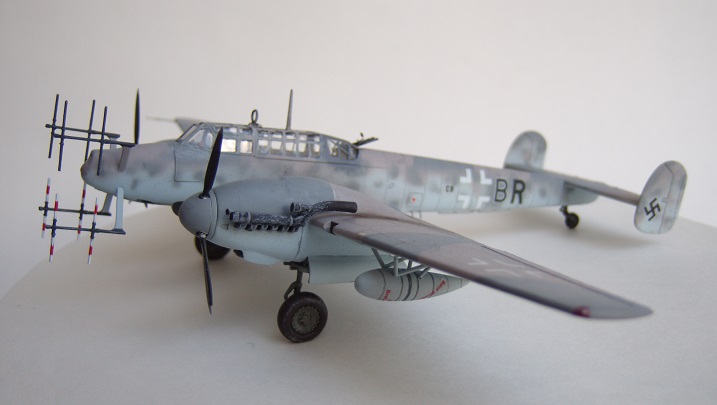

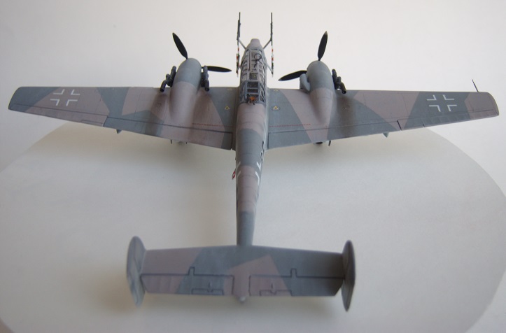

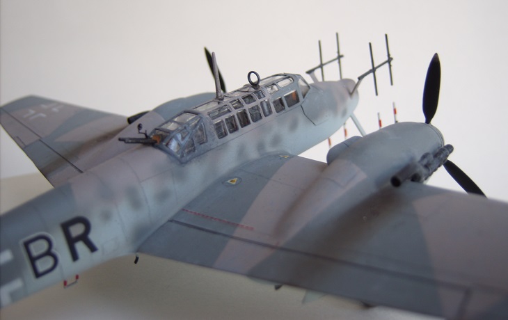

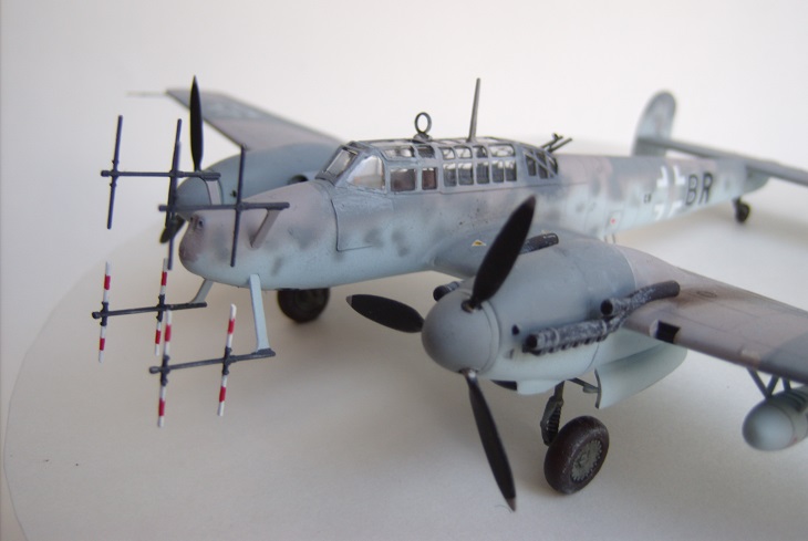

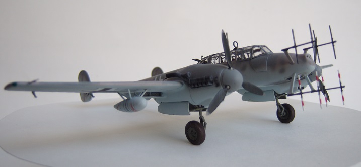

As a sort of counterpoint to the nightfighter-hunting Mosquito I recently posted…here’s an example of what that night intruder would have been stalking: one of the Luftwaffe’s most effective predators of the night-bombing RAF Lancasters, the radar-equipped Messerschmitt Bf110G.
Italeri’s 1/72 scale kit is fairly basic, and reportedly has some issues – notably incorrect framing on the aft canopy section – but mostly ‘looks the part,’ to my eye. It was a pretty straightforward build. Paints were Tamiya acrylics; kit decals are for a machine from 7./NJG 5 based at St. Dizier in1944.

Another beaut, Greg, I really like that camouflage. It’s always struck me as odd that, while we painted our night fighters black, the Germans didn’t - probably didn’t matter much in the dark, I suppose…
The Germans did paint them black to start with. But they learned that black was not the best colour. The night sure is not pure black, what with moonlight, the stars, light reflecting off cliouds and light from probably burning cities underneath, a black mass would show up. The RAF did switch from Black undersides later in the war, but it should be remembered that RAF bomber comand had the highest lose rate of any branch of serviceof all the Allied nations and were second only to the U-Boats. Black undersides didn’t help our bombers much and you don’t see many modern military aircraft painted black.
When it came to camo, the Germans seemed to have known what they were doing.
Yes, an old soldier once told me that the best camouflage colour to wear at night was a darkish slate grey, or similar.

I usually mix my own colors pretty much by eye. Similar color mixes from another project are:
RLM 74 Graugrün: (10) XF-54 Dk Sea Grey + (2) XF-27 Black Green
RLM 75 Grauviolett: (3) XF-2 Flat White + (10) XF-83 Med Sea Grey + (1) XF-7 Red
RLM 76 Lichtblau: (3) XF-2 Flat White + (11) XF-19 Sky Grey + (6) XF-23 Light Blue.
I will often add or adjust the Flat White for scale effect, or until it looks right.

How did you do the exhaust staining? For me that’s always a little tricky. Nice work.
Thanks.
I use fine-ground charcoal…not the artist kind, the actual barbecue kind…applied with one of those cheapo Testors nylon bristle brushes. It’s a lot more subtle than pastels or dry-brushing (which I’m otherwise a big fan of), easier to build up to the degree of darkness you require…and can be pretty neatly removed with one of those red rubber ‘wedge’ pencil erasers if you think you’ve overdone it.
Lightly scrubbed or ground into the surface, it also seems to ‘grab’ better than pastels do…so there’s usually no need to clear-coat it, unless it just makes you feel better. (It will pick up finger oils and smudge if touched for a while, but it tends not to smear and pick up fingerprints the way pastel does so easily.)
