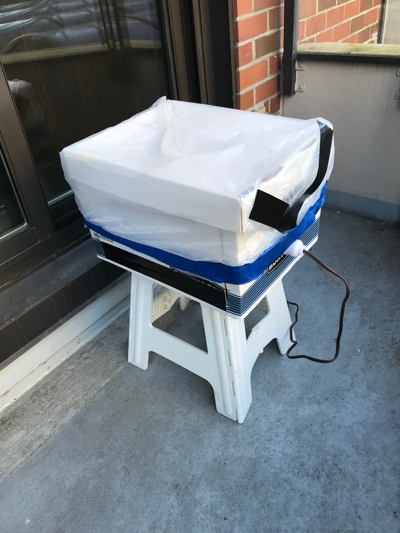

I cut flaps in the opposite long sides of the box to make it easy to spray models from one side of the box or the other without having to touch the model; I added cardboard flanges and affixed strips of velcro to them for closure. To keep the box dry in case of wind and rain (which seems like it’s been a daily occurrence all winter), I used a sheet of polyethylene and duct tape to make a cover.

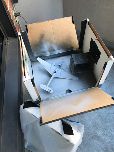

Here are photos of the completed and well-used box; the model in the photos is an Airfix Handley-Page H.P.52 Hampden bomber that I’m using as a “test bed” to try out some paneling and weathering techniques. I’m also trying to remove rivets — the Hampden had flush-mounted rivets. When I get those techniques nailed down, assuming that I am able to, I’ll try them on another Hampden that’s waiting in my stash. (I’ve previously built another Airfix Hampden, and while I’m reasonably happy with the result, I want to build another, much better one.)
Here are photos of my “spray booth”:
Banker's box spray "booth"
Banker's box spray booth
I keep my models inside the box until just before I spray them. Before putting them in the box, I switch off the light bulb, lower its cover, and unplug it to avoid an explosion of paint vapour.
Aside from occasional bits of dust somehow making their way onto the model, the “spray booth” has worked well. I may have to build a larger version for some of the larger models in my stash, including a Boeing B-17G, a Focke-Wulf Fw 200 Condor, and a Avro Lancaster.
